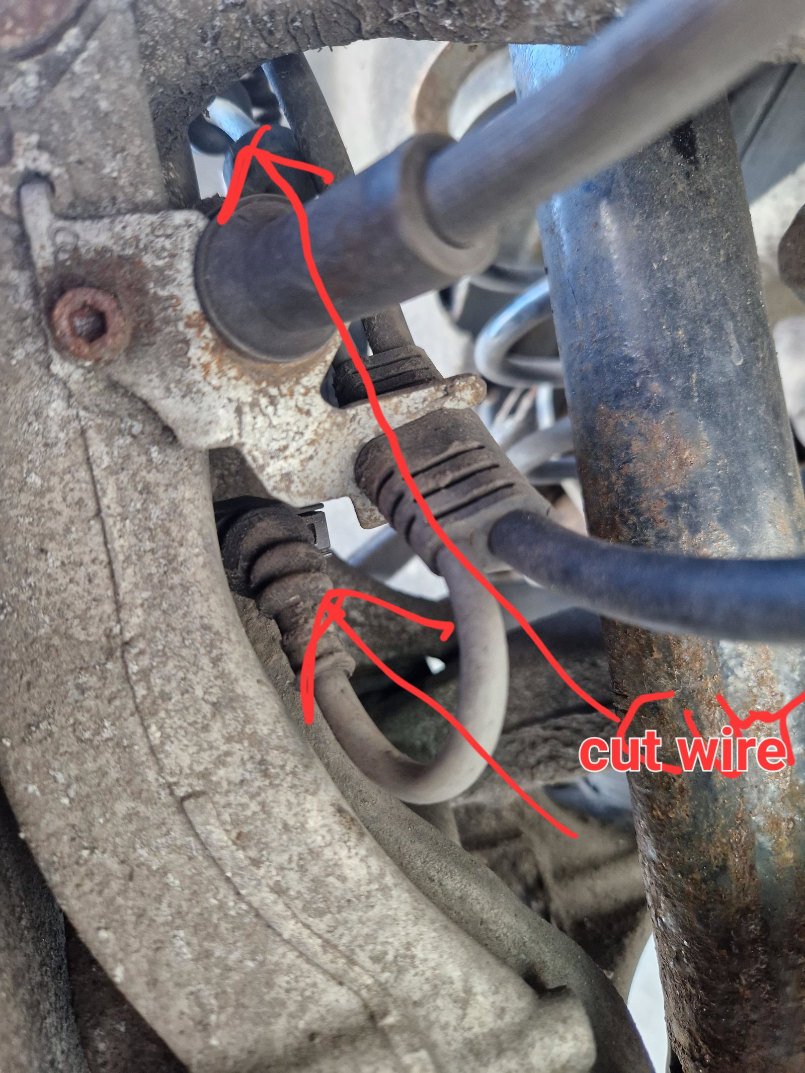

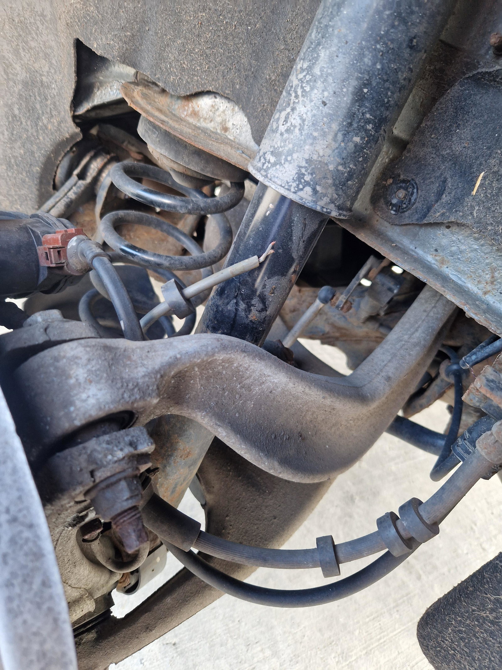

a6blacked007 Posted August 22, 2023 Share Posted August 22, 2023 Anyone know what the middle wire is in this picture its snapped off on my rear drivers side hanging down. Ones with round bits on them Quote Link to comment Share on other sites More sharing options...
a6blacked007 Posted August 22, 2023 Share Posted August 22, 2023 Sure it's not abs as lights would be permanently on dash speed sensor wire maybe Quote Link to comment Share on other sites More sharing options...
a6blacked007 Posted August 23, 2023 Share Posted August 23, 2023 I think it's should be plugged into auto handbrake still works until all lights pop up on dash 🤔 Quote Link to comment Share on other sites More sharing options...
