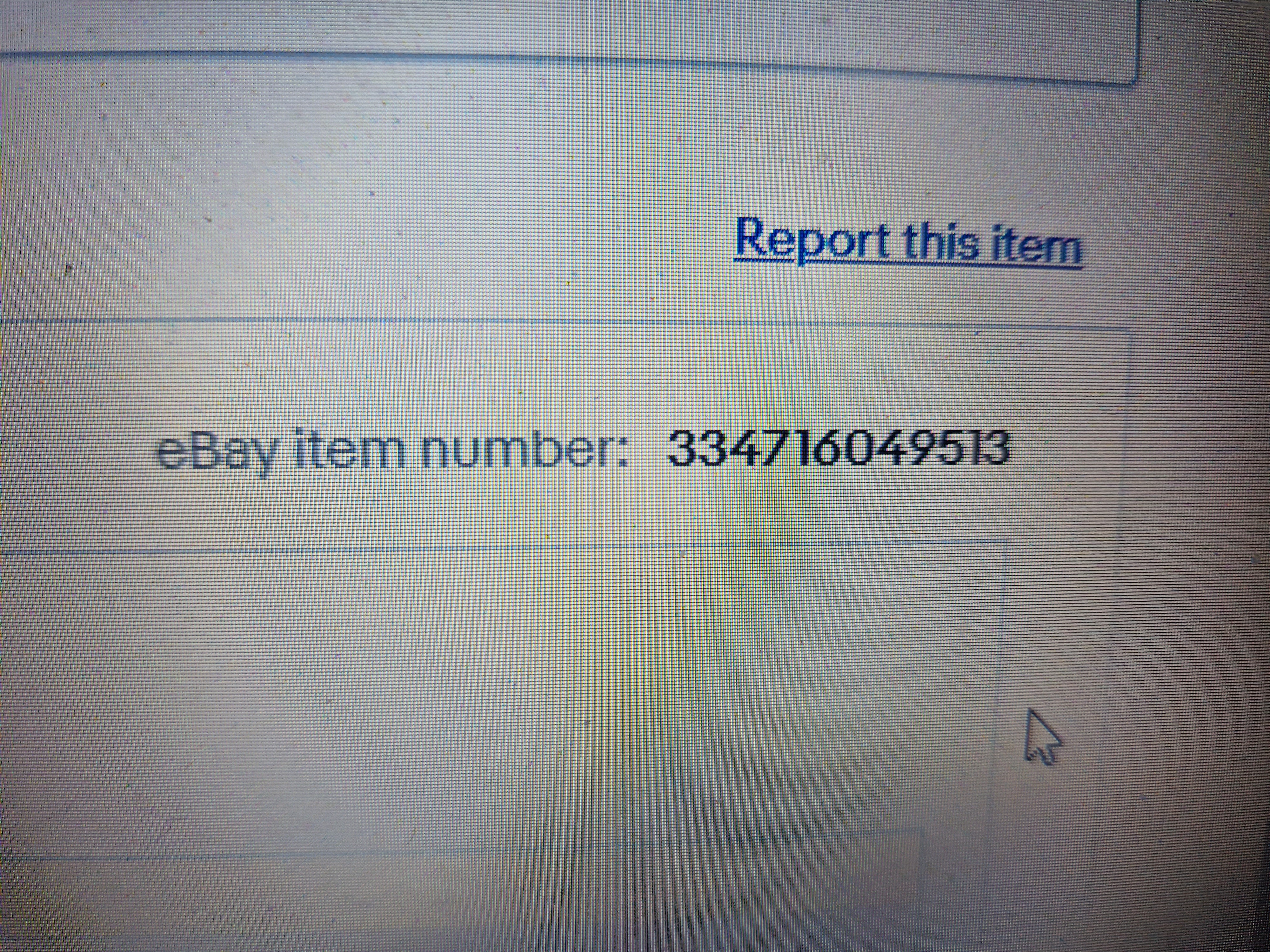

hi just looked in the owners Audi A4 manual and according to the pics its showing as fuses on the left sid panel(right hand side if your sat in the car) fuse carrier A black. fuse 11(5 amp) heated jets and fuse carrier B brown fuse 9 wiper motor(30 amp). and in the boot, fuse carrier D red fuse 8(15 amp) rear window wiper(avant).i removed both the 5 amp and the 30  amp fuses but the wipers and jets still work checked all other fuses in the book and cannot work it out for you which fuse it is for the jets or the jet motor...see pic 3 for eBay item no could this be the oem number needed.i am now intriuged myself to which ones they are lol.i think the pump is behind the front right wheel arch cover.so to sum up checked all fuses in the book and no wiser🤥
