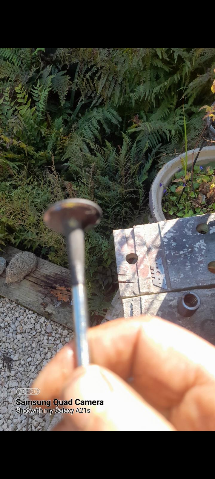

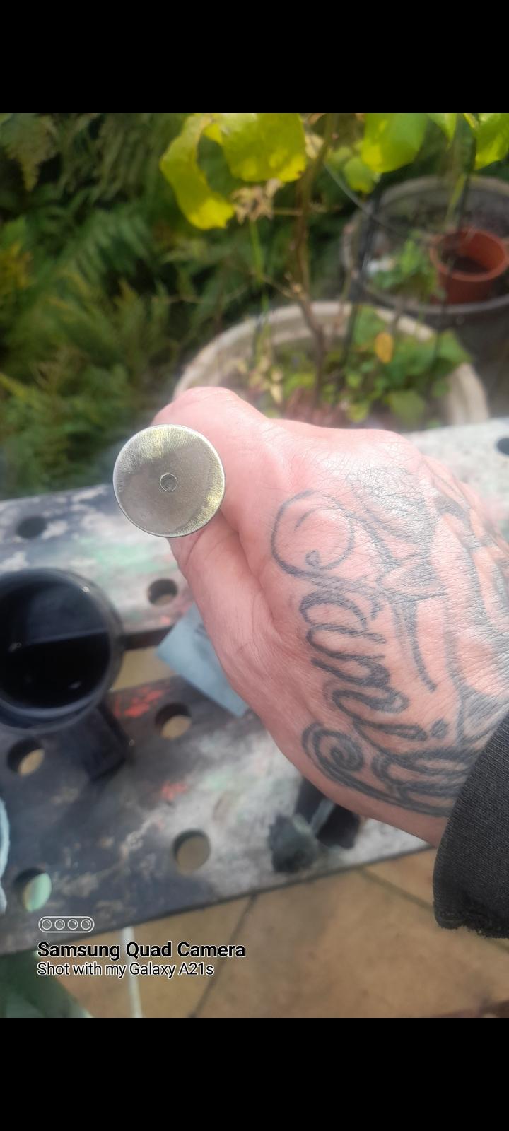

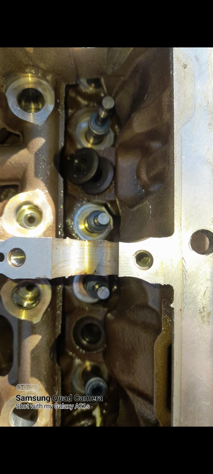

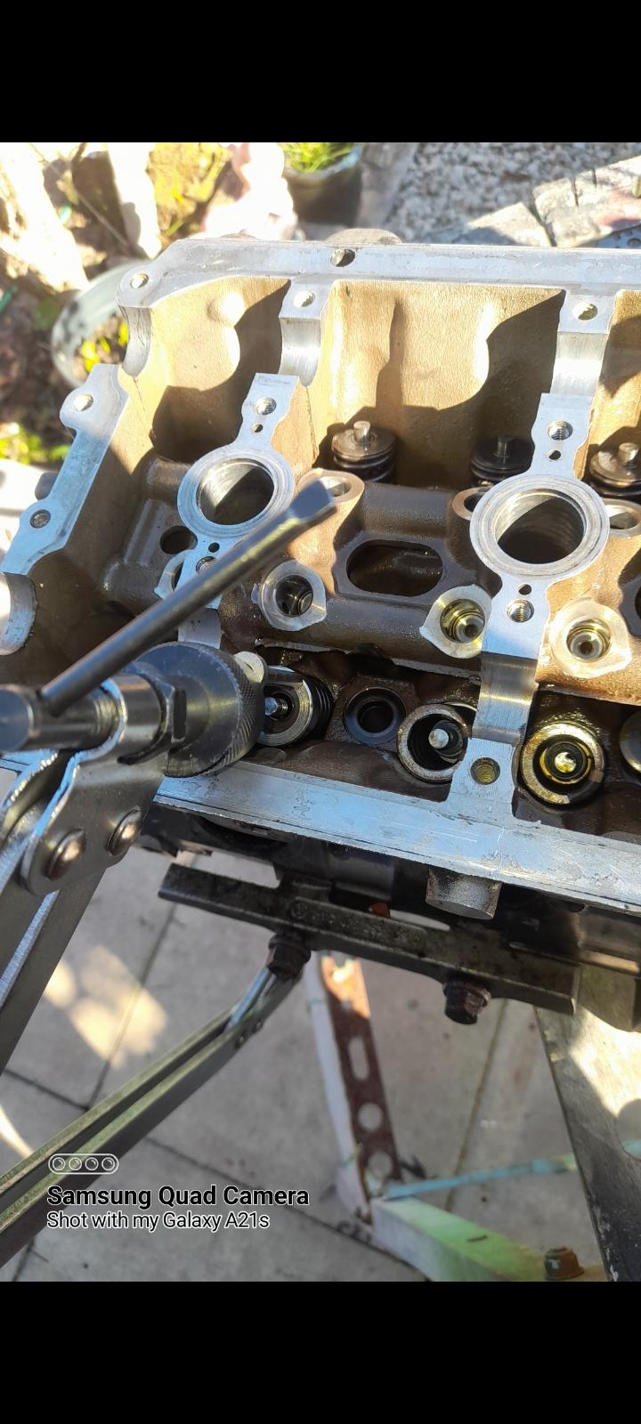

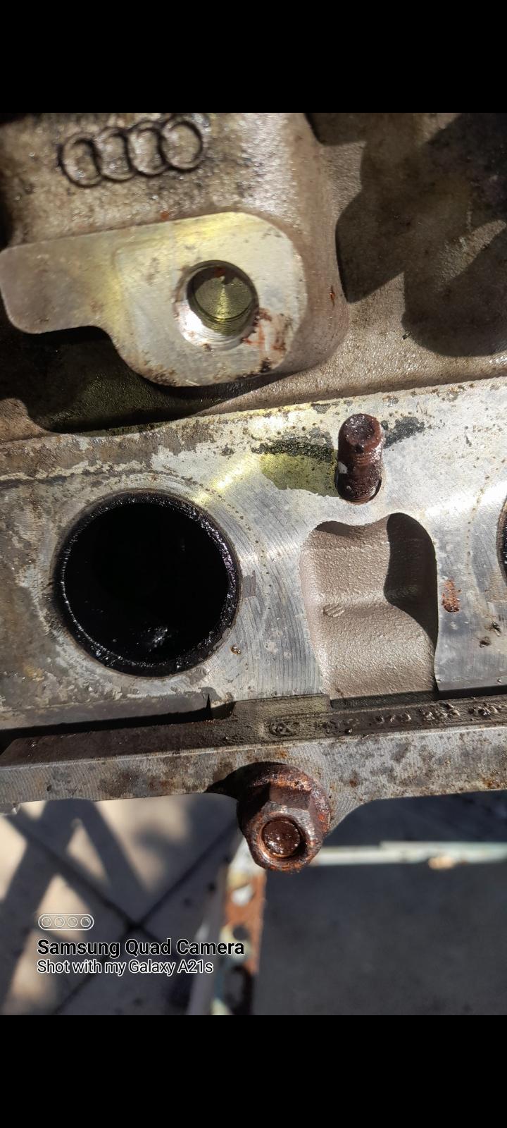

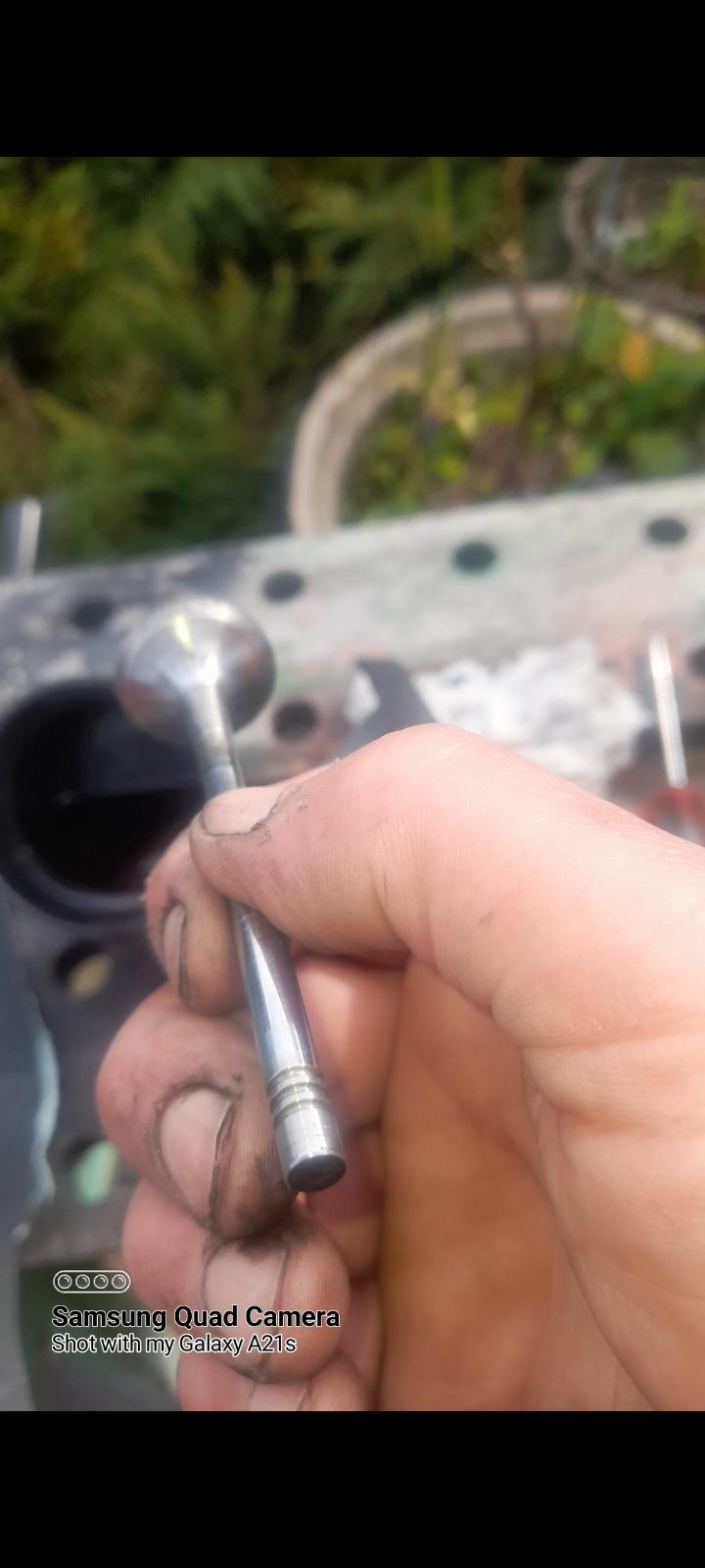

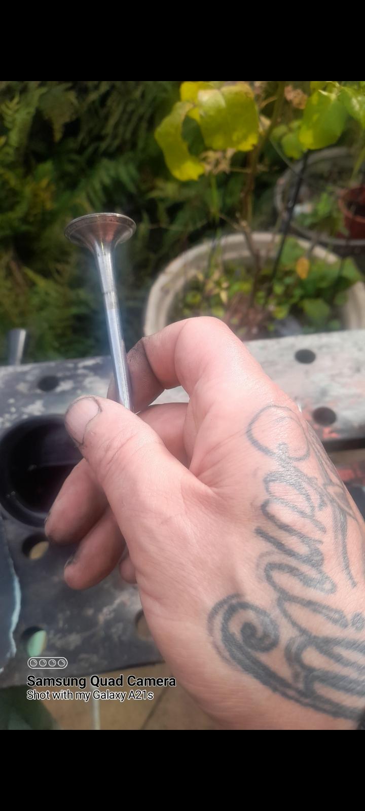

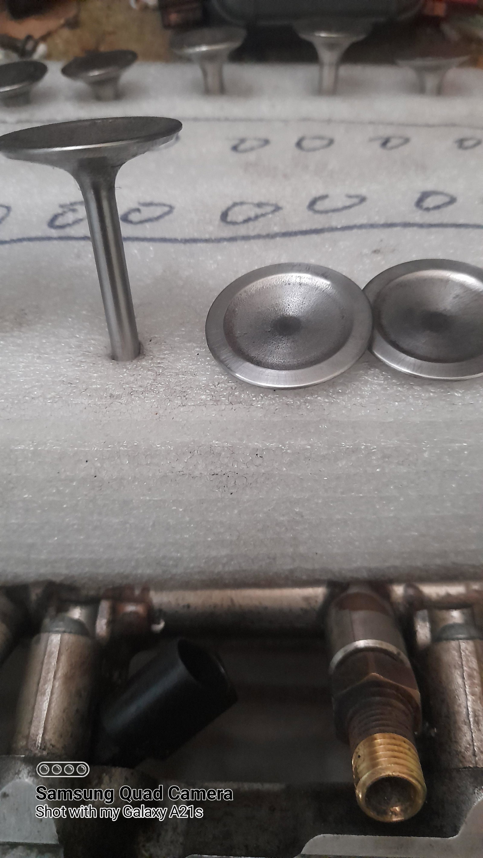

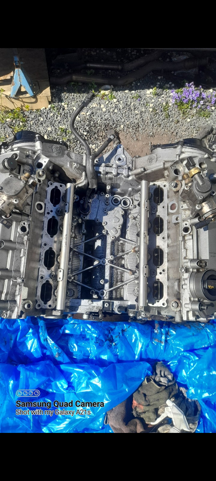

Valve stems are going on lovely not going the put the collars on yet as iv ordered and good few k44 from bg so I can clean the Valves and port holes lot af carbon there

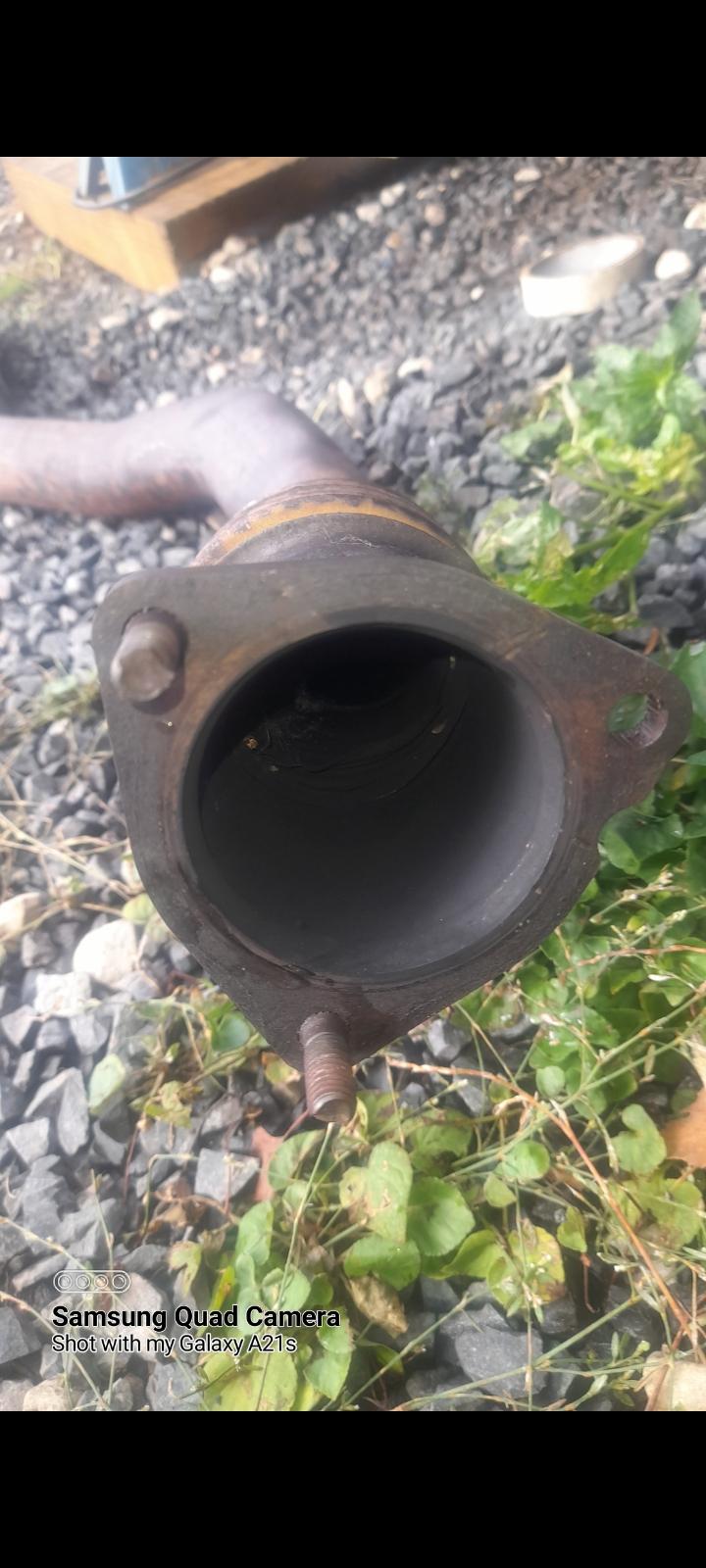

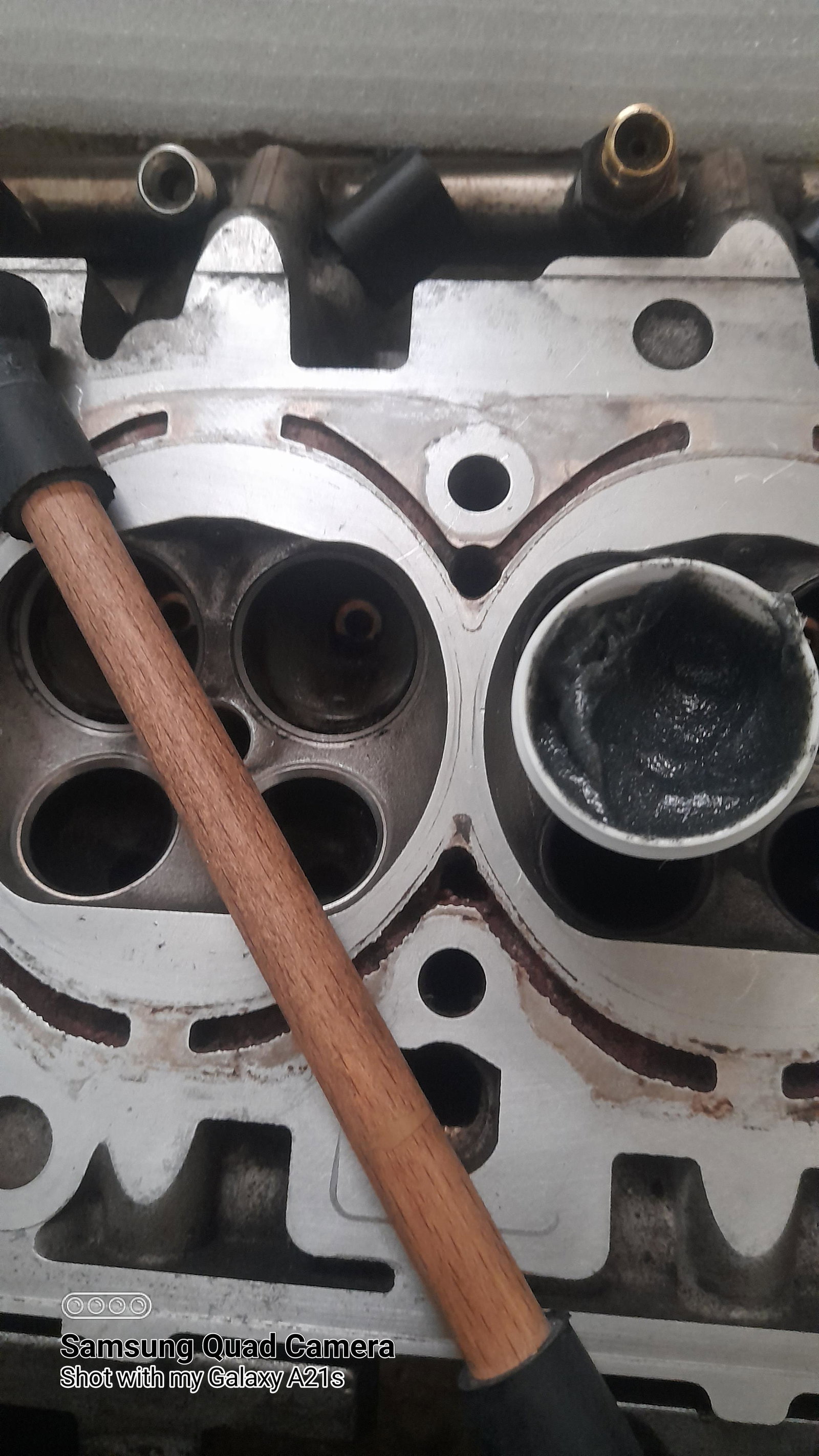

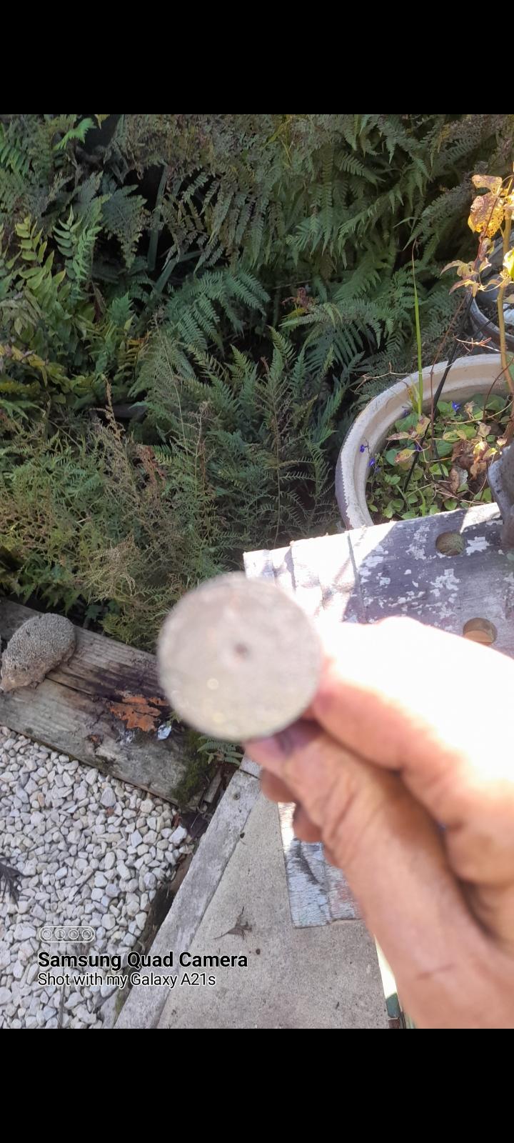

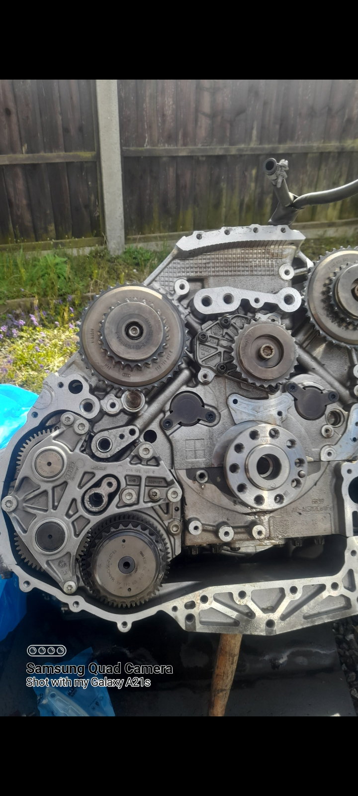

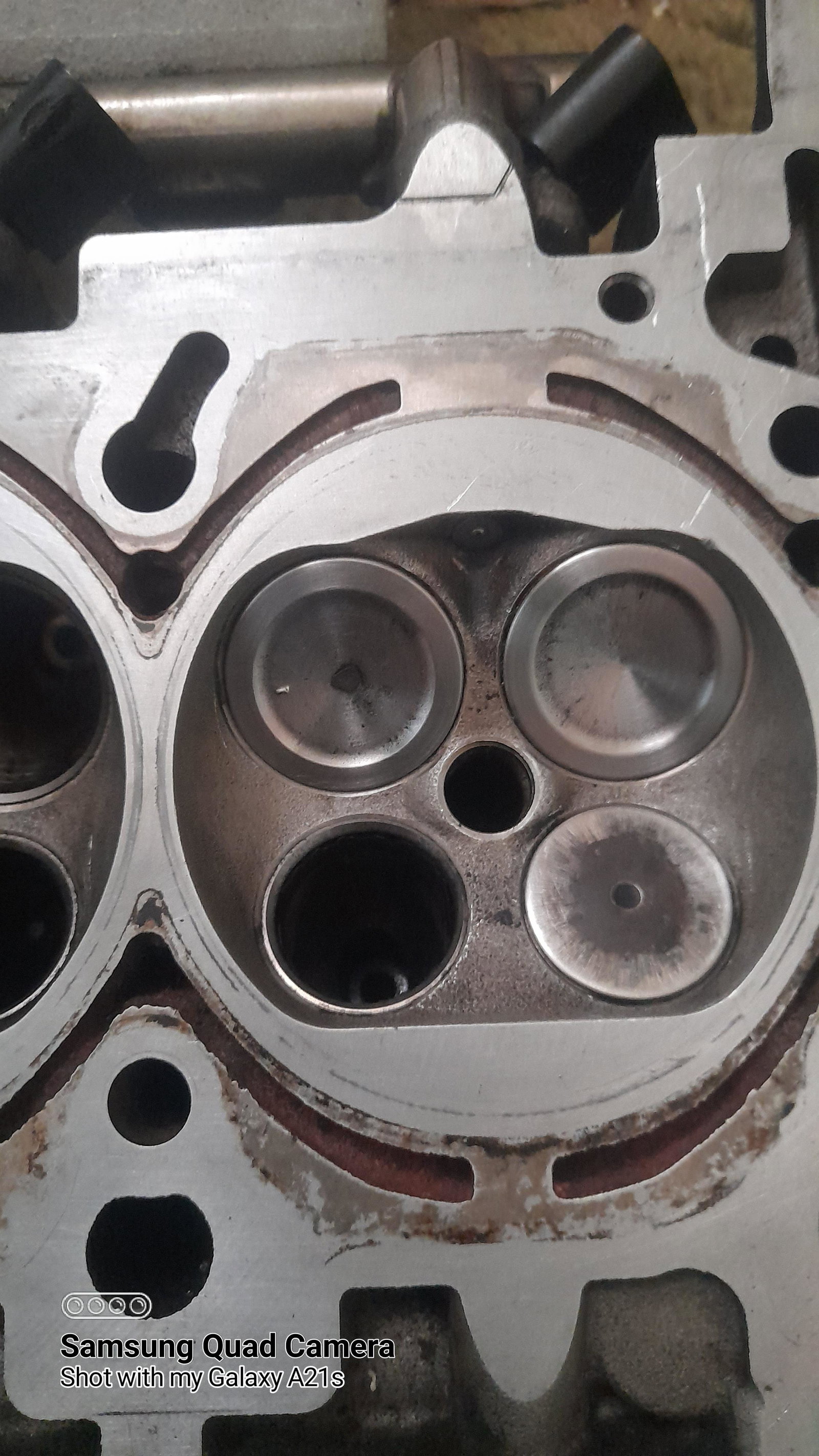

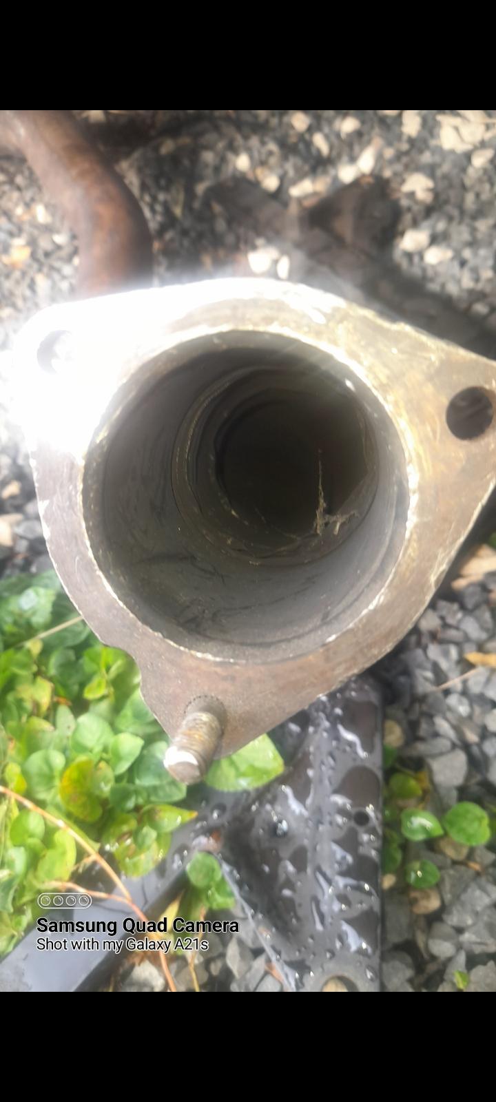

Not much done today removed 3 studs off the exhaust as thay snapped easy enough job and found a little bit of carbon cleaner so started on cleaning the valve still not finished but it's looking good

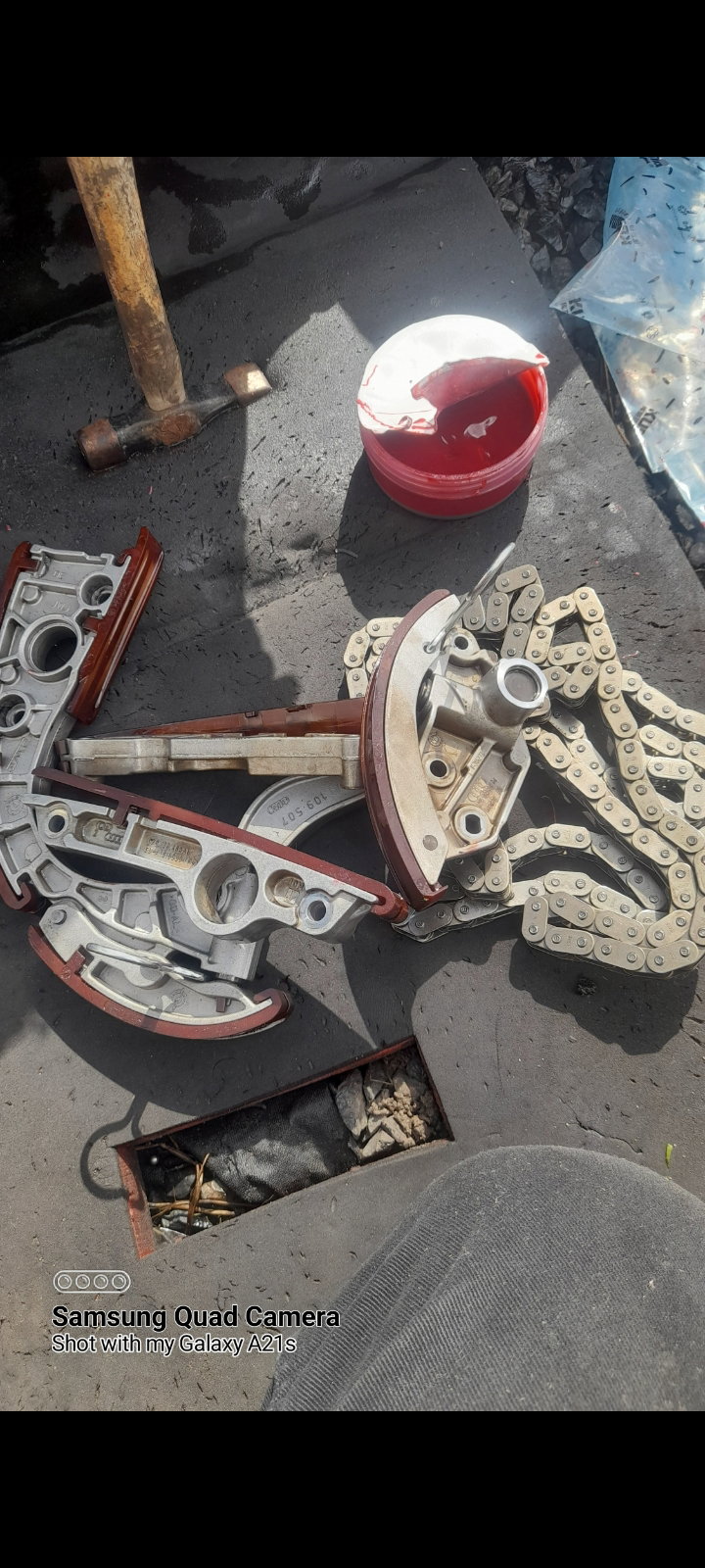

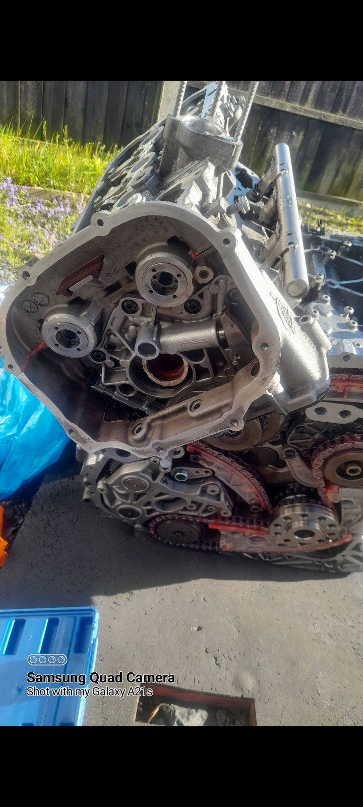

So come too a stop for the moment ordered so stuff wet and dry 800,1000,1500, another torque wrench as can't fined the small one and a full timing chain kit ouch

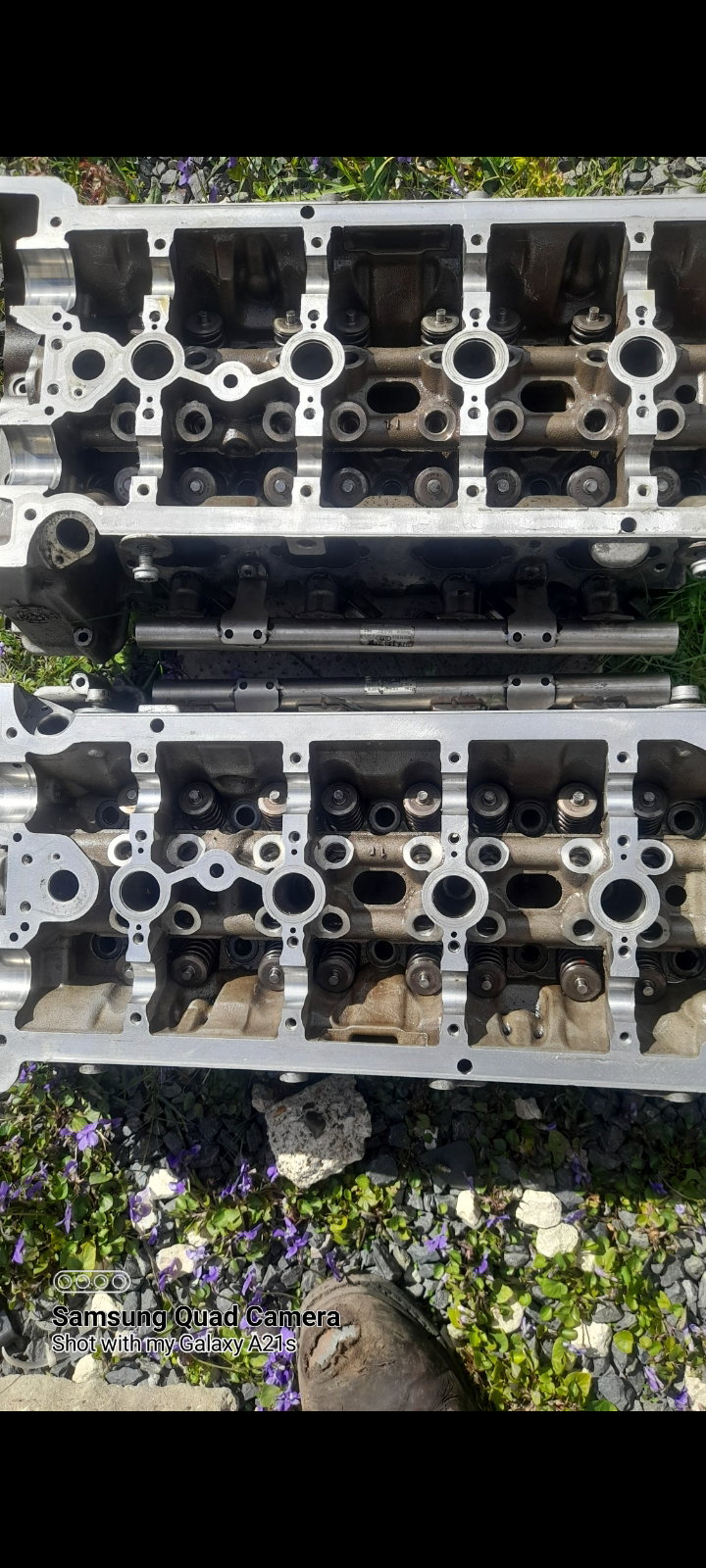

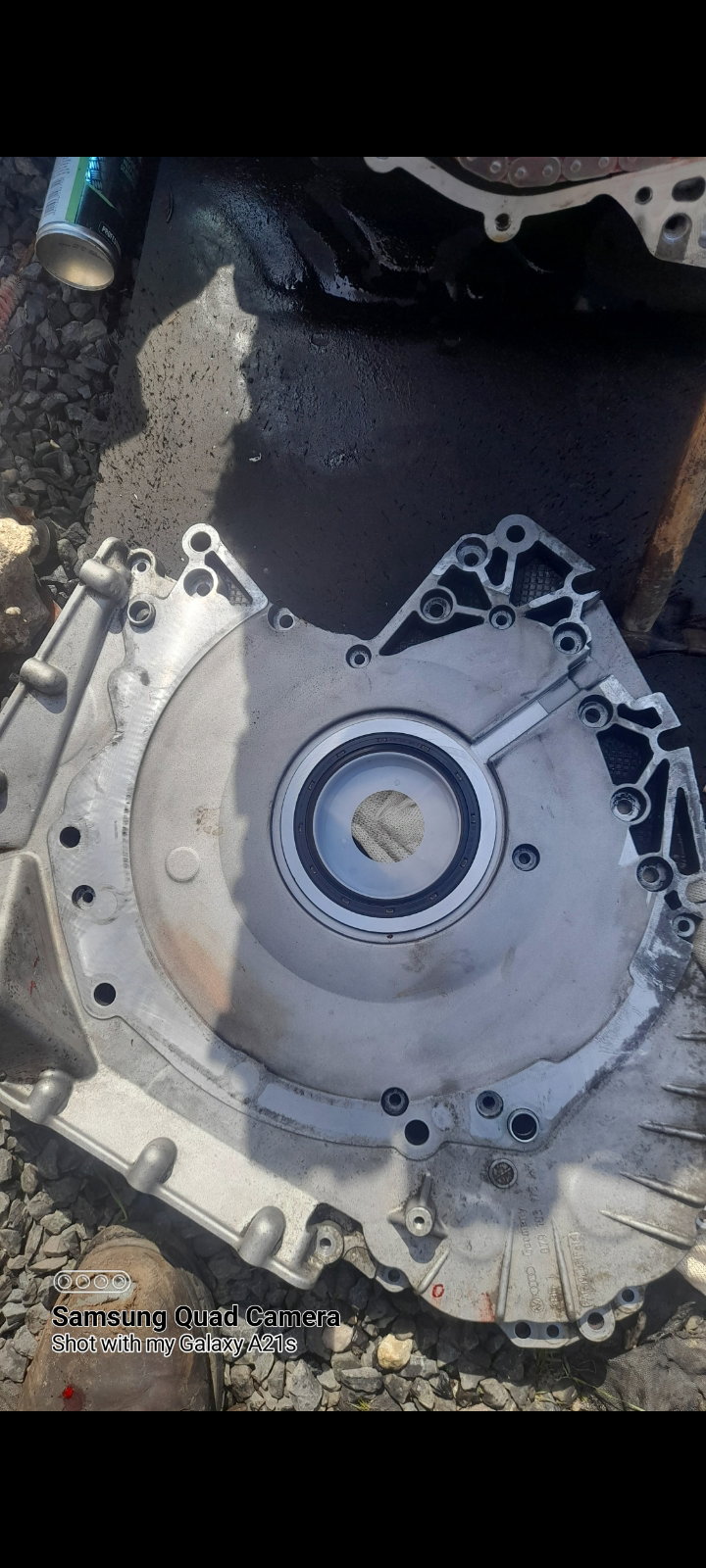

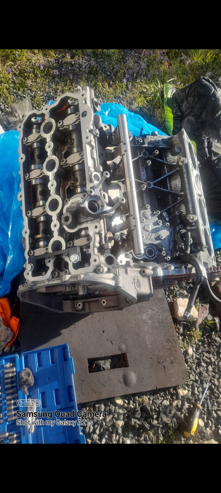

Haven't been on for abit due to work and other things so started on the valves clean and cutting back in new stems are on putting the keepers are a pain to put back on got 12 days off so should put a good dent in it and if all goes to plan engine should go back in

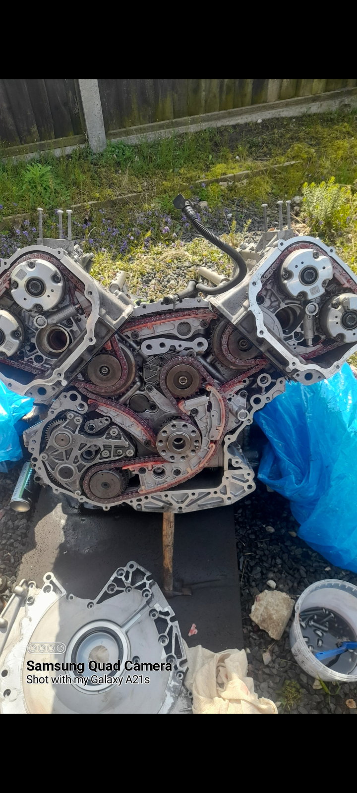

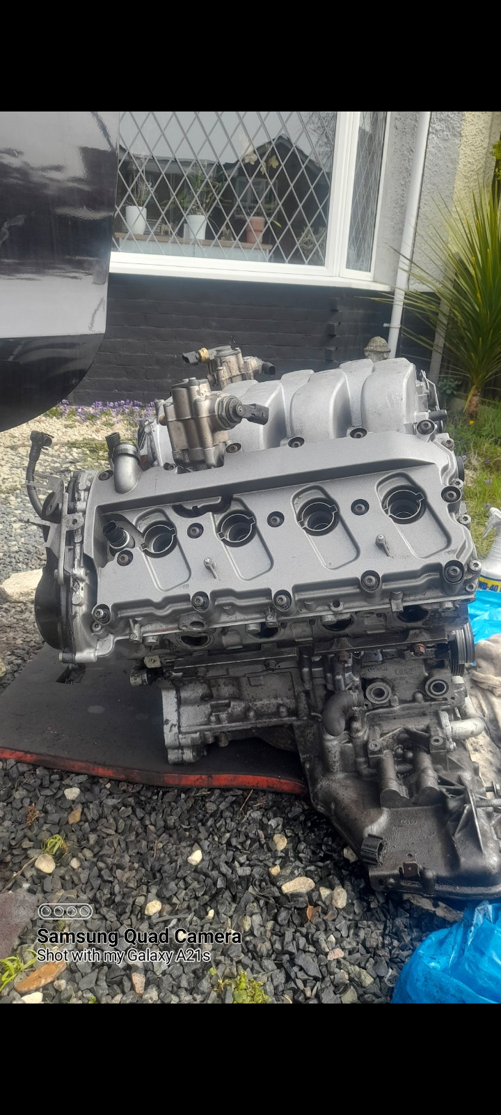

Well its coming along nicely

Its definitely a labour of love but she starting to look like a v8 now

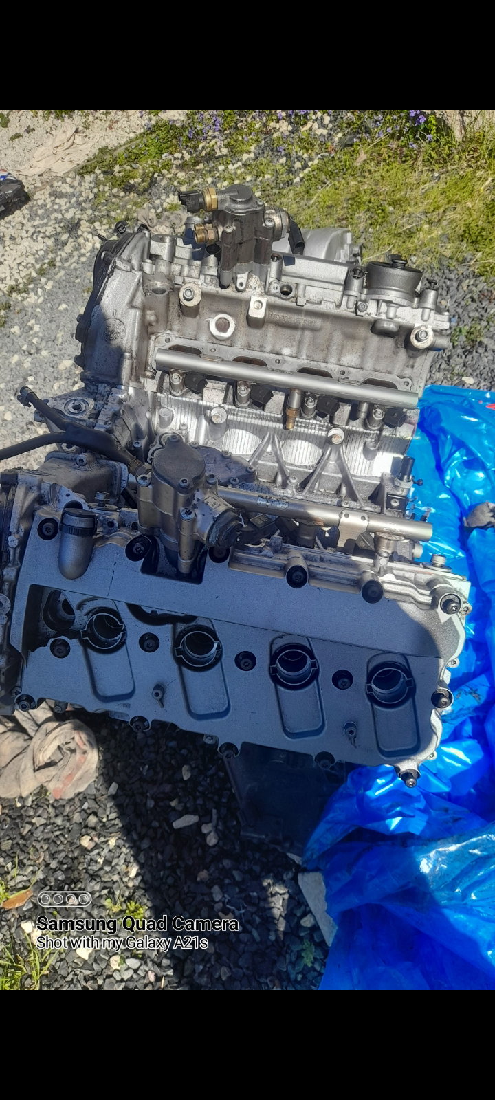

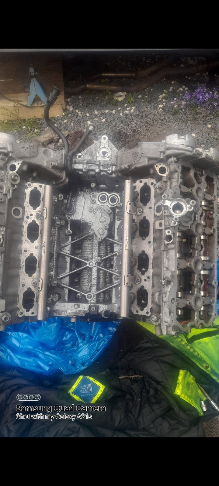

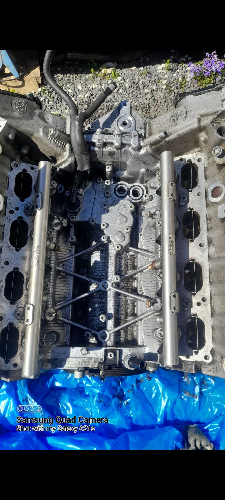

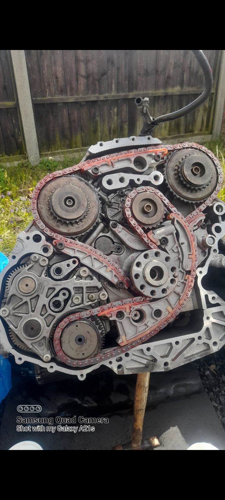

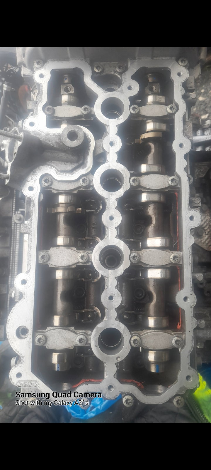

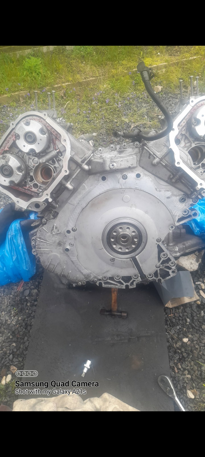

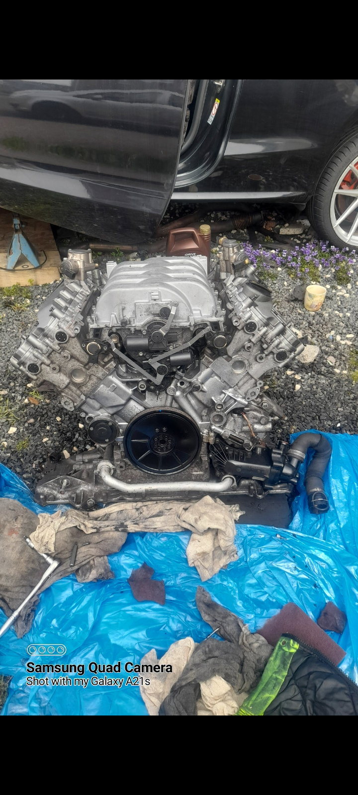

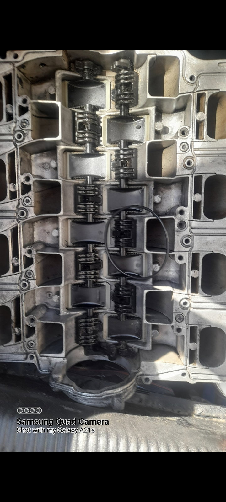

Why is your the same as mine valve stem seals gone Steve, the scary part was doing the head bolts and the 4 cam shaft adjusters on the torque setting especially the head as it was 30nm 60nm then 90 degree and a final 90 degree

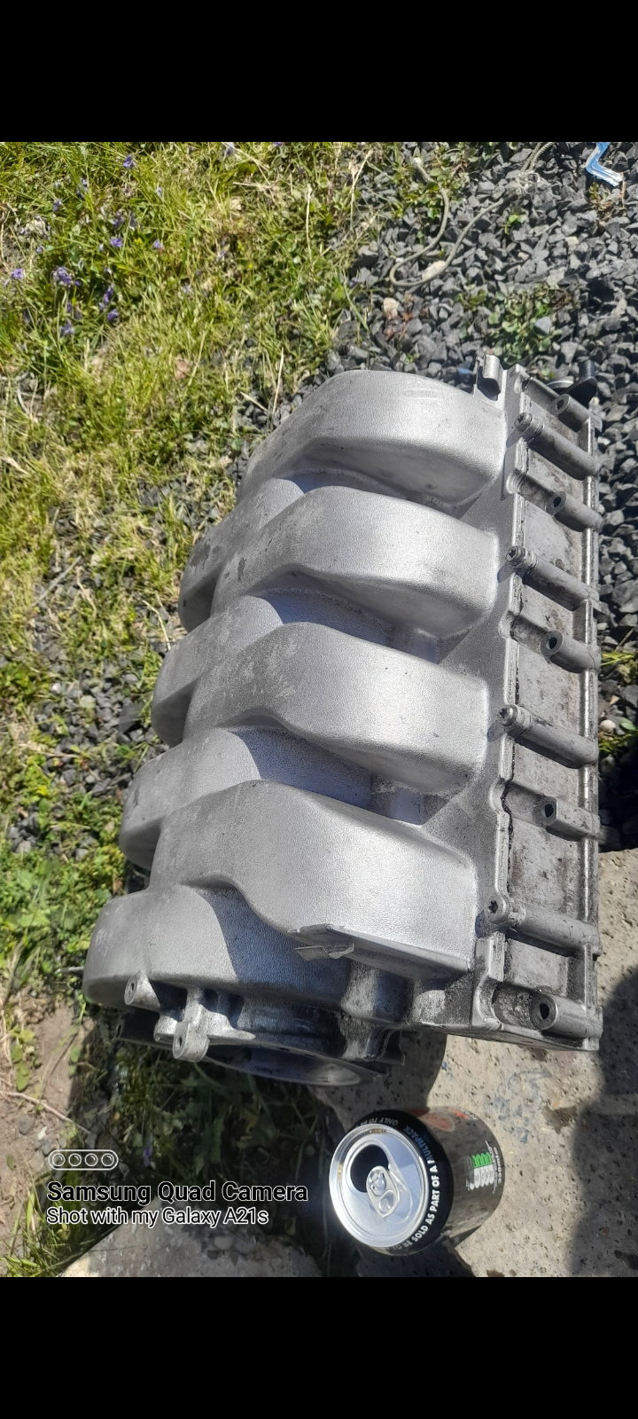

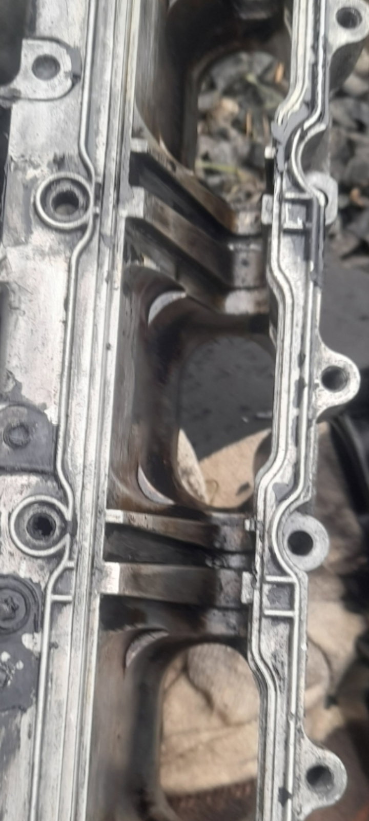

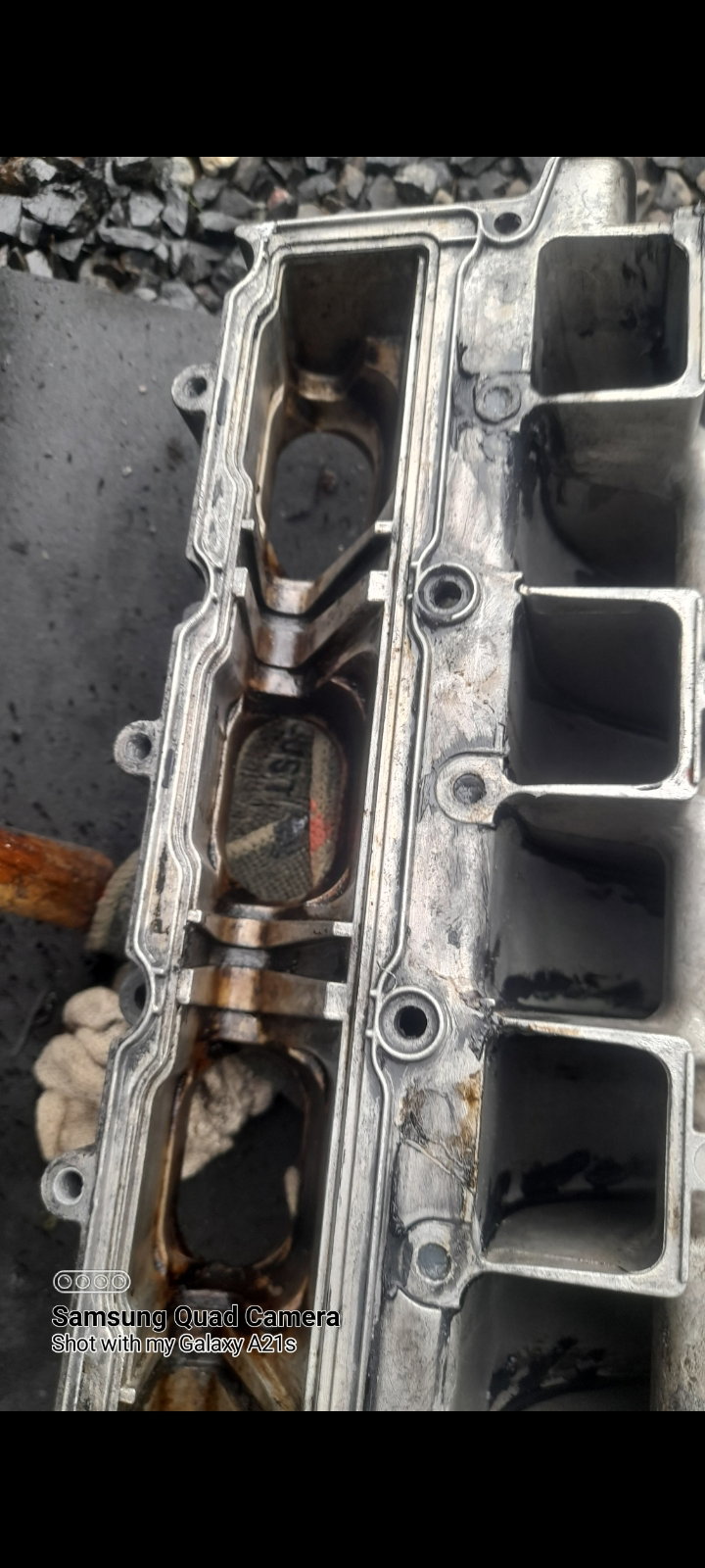

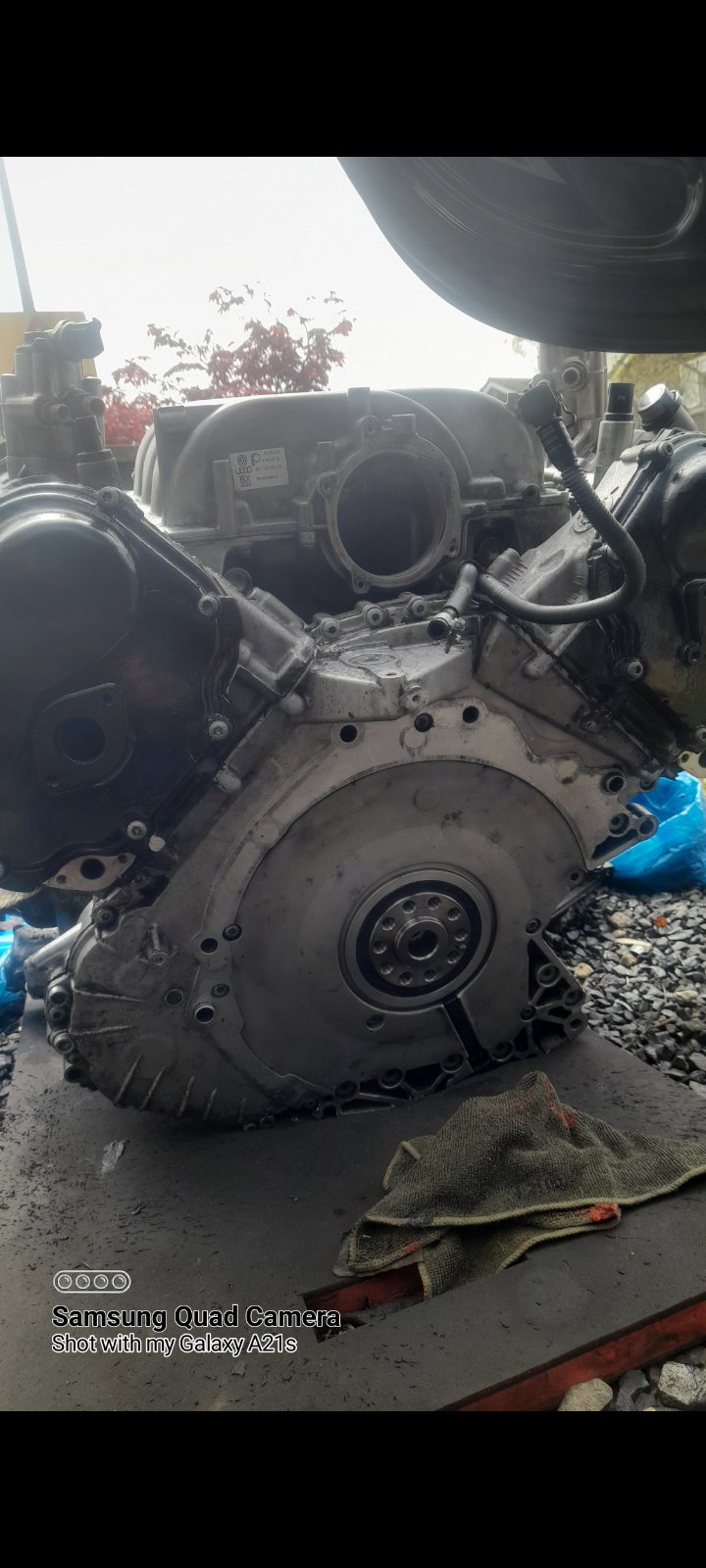

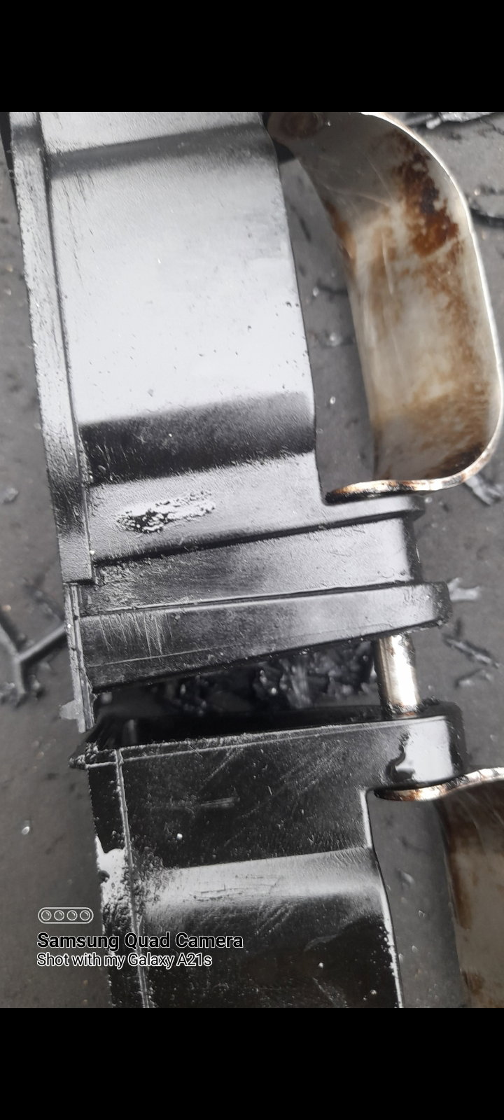

Well the back plate on and new gasket what a pig too do and cleaned the valley and changed the gaskets in there
2 hours ago, Teddynewson said:

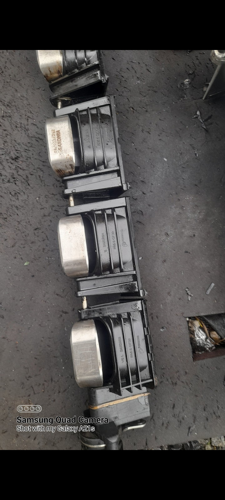

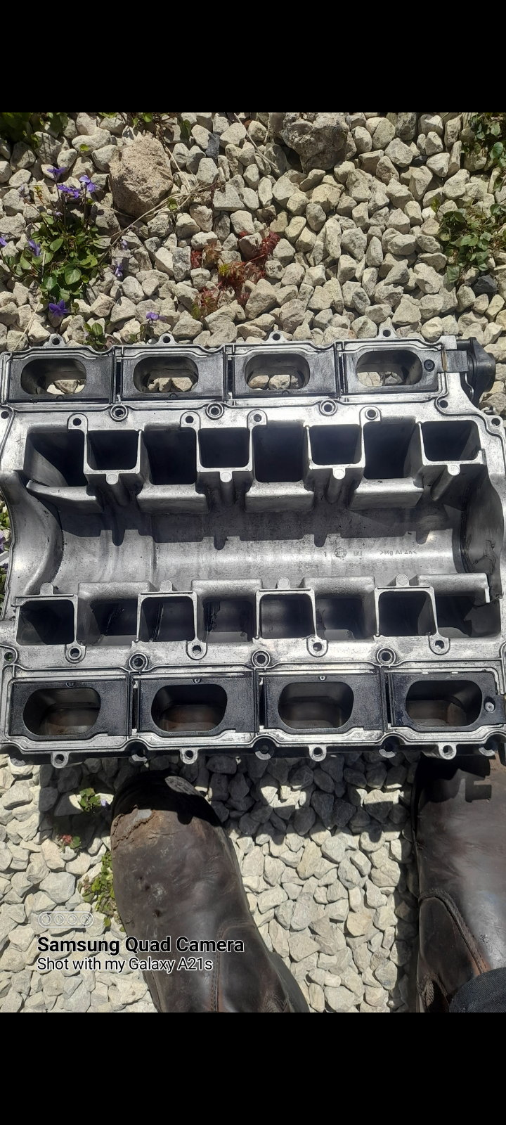

Well the back plate on and new gasket what a pig too do and cleaned the valley and changed the gaskets in there just opened the plenum up and may have found why it was smoking these should be sealed in place and thay wasn't so oil would have gone down the exhaust area

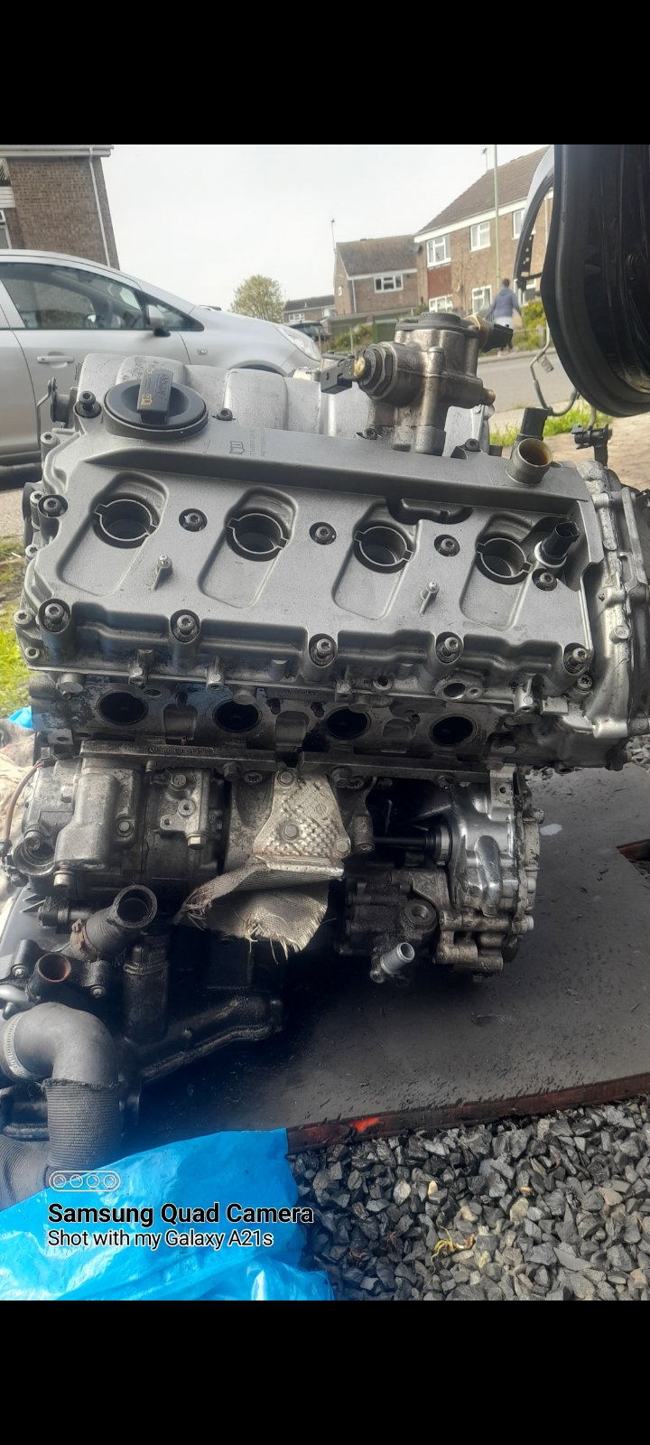

Well engine done for now and the plenum sorted just going too let everything settle but I'm happy and on the plus side nooo extra bolts haha

Well she done just need to put it in the car now but do that on the next holiday

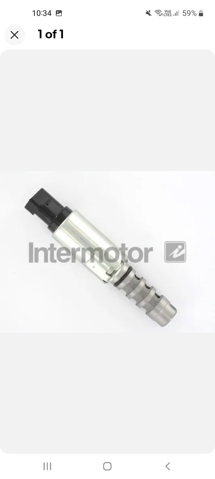

4 new vvt here and pcv Breather hose audi wanted 75.00, got for 25.00 new off ebay exactly the same not Chinese rubbish and 4 cam ajustets

Engine now finished and back in the car having a problem putting the cat on drivers side gearbox lowered, and subfram, seems  very very tight and not much room
