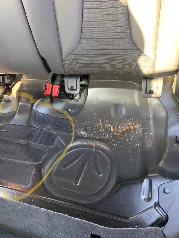

Doesn’t seem to anything there, does anyone know what these highlighted strips are as they are wet also.
image.thumb.jpeg.a110aacf9df7a3657db99126fa13aba6.jpegimage.thumb.jpeg.a110aacf9df7a3657db99126fa13aba6.jpeg
Hi the strips are Anti rattle sound proofing and stop the sqab from bouncing up and down and making a noise, can't see any wet from the picture on the metal but you can on the strips, just wondering what that interesting hole is just above the pump cover.
