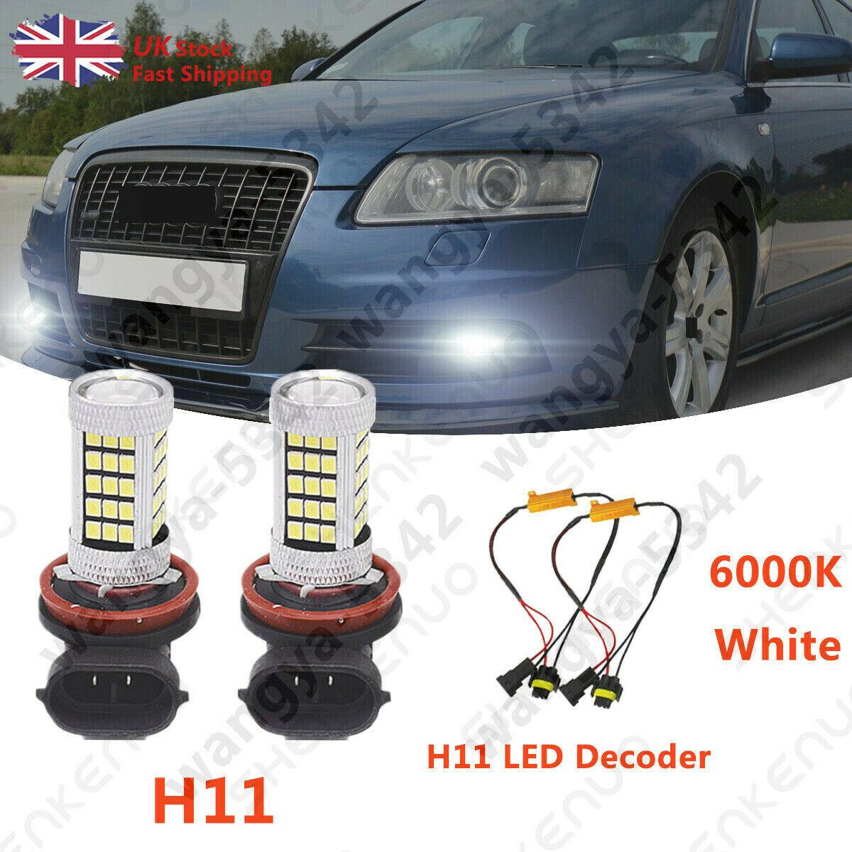

I fitted LED bulbs in my A6 Avant and lived with the warning lights for years.
The warning only came on when starting the car and stayed on until I turned the fogs on, then the warning lights go out.
Just recently I have fitted a connector with a resister in it to stop the warning lights coming on.
The resistors get very hot so best screwed to the metal bumper rail.

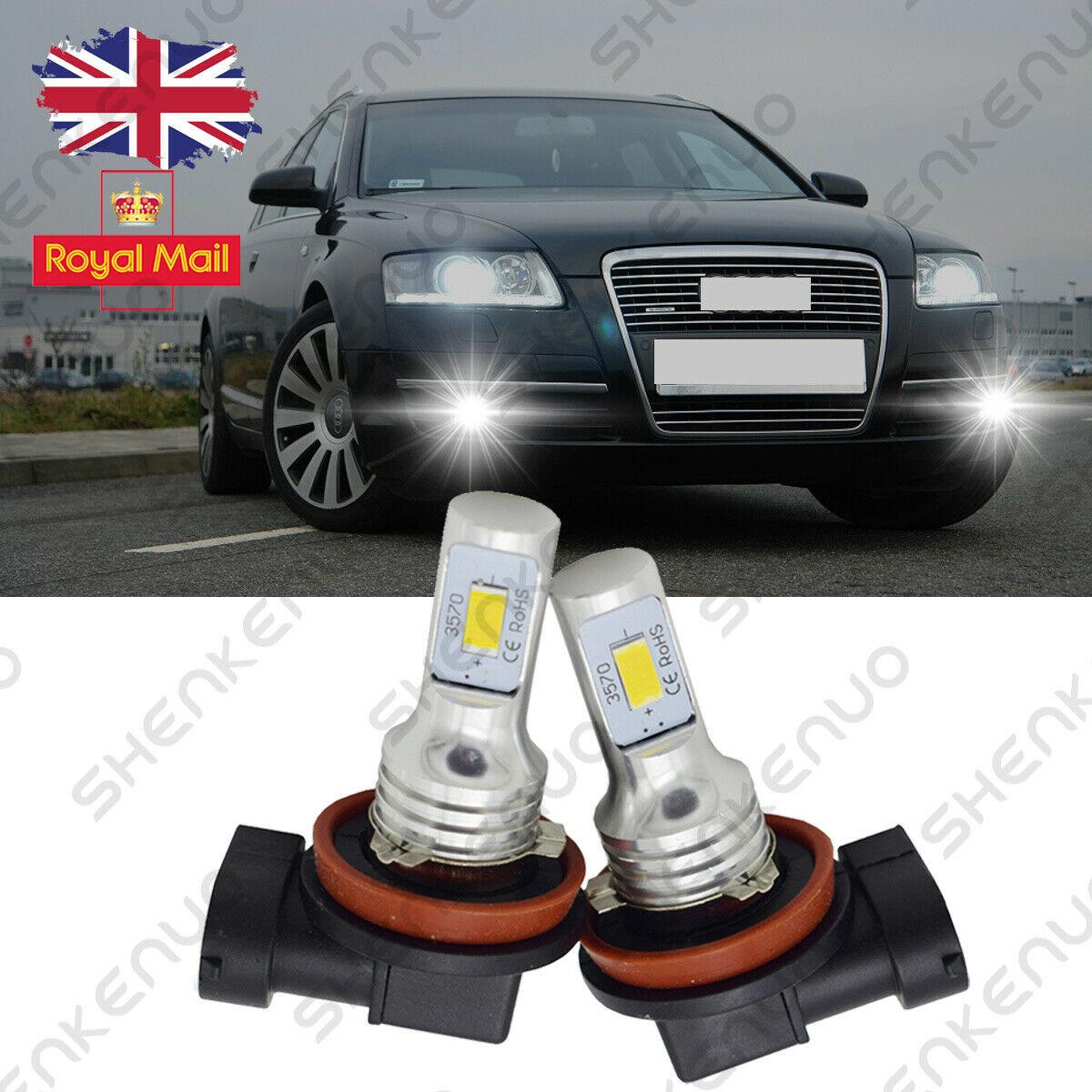

I fitted these bulbs
And these leads.
That’s perfect!
Thanks for all your help RoyC 👍
