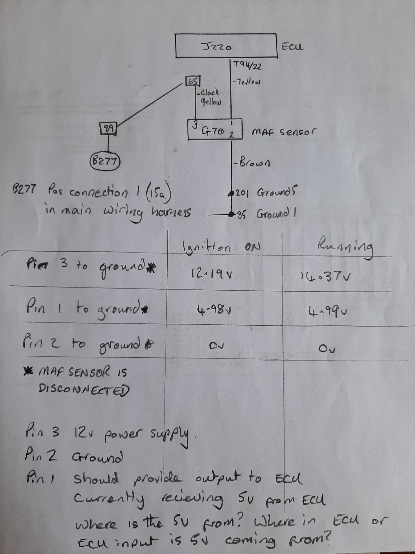

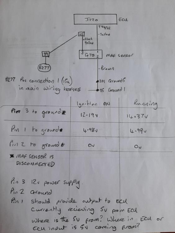

stu.waller Posted 7 hours ago Author Posted 7 hours ago So an update on readings. Been back out to do a better job of recording voltages. Multimeter on car ground to the following pins: with ignition on but not running Pin 1- 4.98v Pin 2- 0v Pin 3- 12.19v Multimeter on car ground to the following pins: car running Pin 1- 4.99v Pin 2- 0v Pin 3- 14.37v - 14.45v when rev'd Variance between pins 1 and 3 - 9.3v And pins 2 and 3 - 14.4v All seems normal yet something blows the maf sensor. Could the Multimeter response time be insufficient to pick up voltage transients? What am I missing here? If anyone could provide their voltage readings as a comparison it would be appreciated. If anyone has any ideas of what to look at next, that'd also be appreciated. Would different measurement equipment be more suitable? Oscilloscope?
