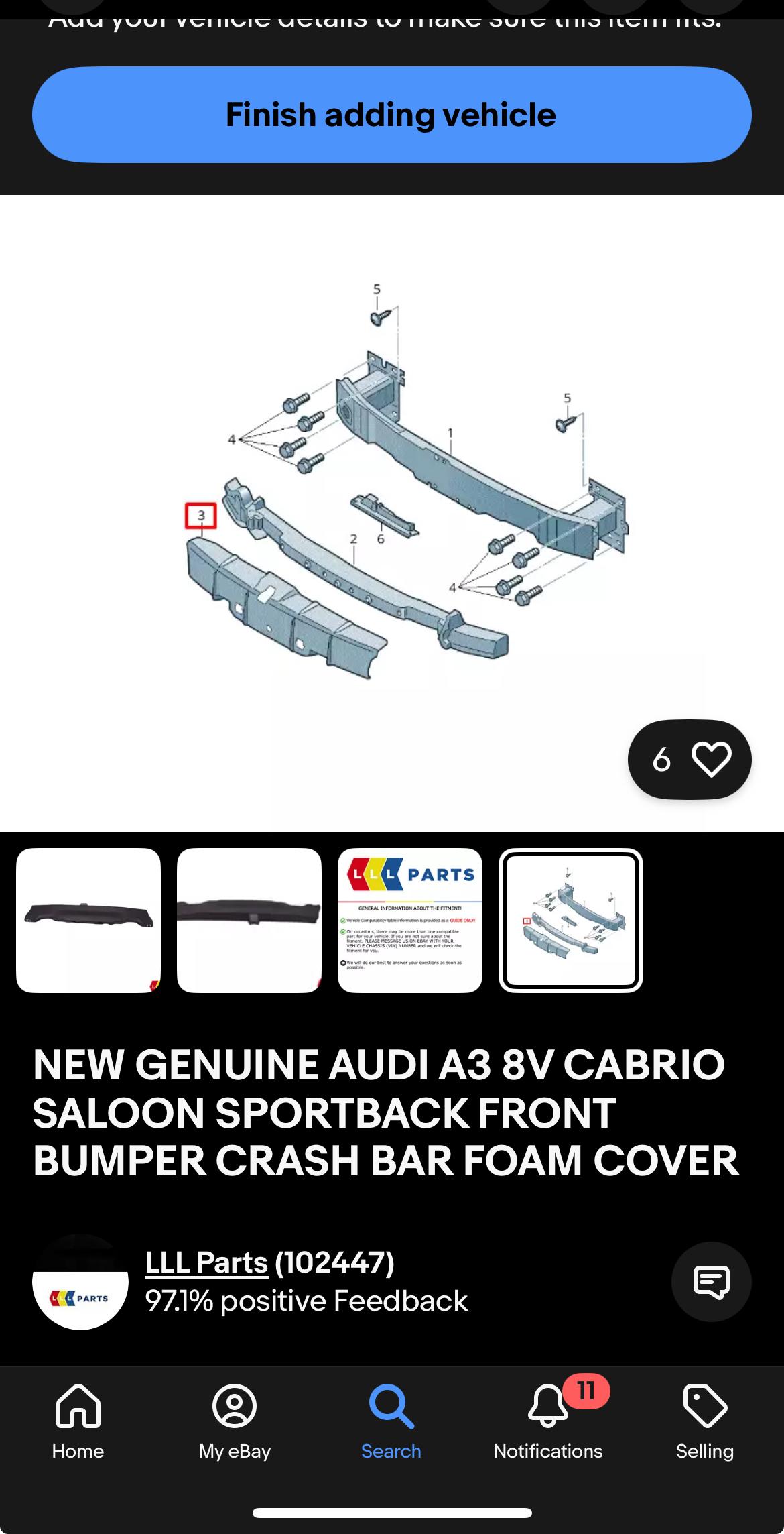

If you have the plastic tube in the back of the foam then it must be kept as it’s for the active bonnet. The foam is also there to protect pedestrians from the crash bar as part of the active bonnet system. Some older Audi’s had a thin textured plastic cover that covered the foam behind the grille so this might be a good option
This is a example of what I mean
