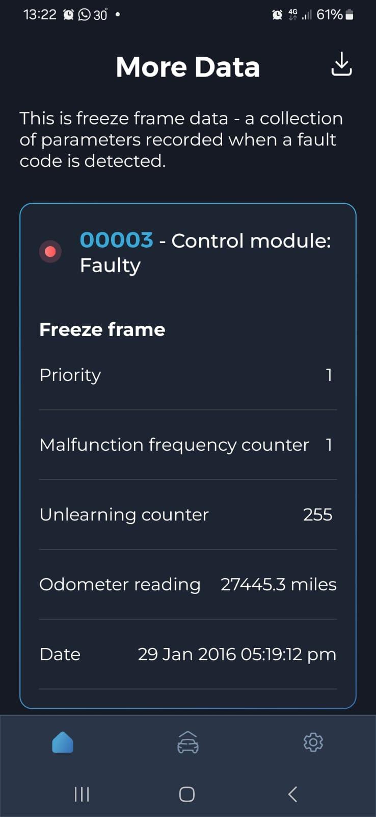

I ran carista and it has in its memory an instrument cluster fault but it appears just once i think 9 years ago at a much lower mileage of about 27k, its now done 68k. I'm new to carista so I`ll post a screen shot if I can to see what you think.
thanks for your response!
