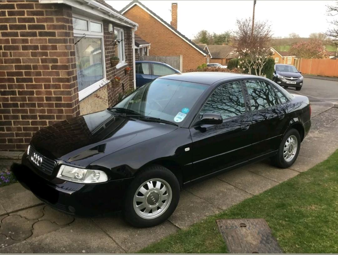

I have a  1999 model 1.8 petrol A4 b5 saloon; again it's full Audi service history.. I serviced it myself 3 days ago, as its 20 years old not worth taking to the stealer ship anymore..my car is hesitant under acceleration and misfires when reved past 4k..any ideas? I didn't change the fuel filter.
And maybe I should check all the earth connections.
One thing I've learnt about Audis over the years is that although the mechanics just keep going, there comes a point where some aspect of the ever more complex electronics fails and it can be a bugger to find. I eventually solved the misfire and tracked the problem down to an intermittent fault in one HT lead. I proved it by swapping a couple of leads and seeing the OBD fault codes report different cylinders. Audi of course wanted £46 + VAT per lead, Euro £54 (including) for the set of 6.
Thanks for the reply.. Its appreciate.
Seems to be running fine at the minute.
Its a 1999 model face-lift A4 petrol 1.8 manual.
12 months mot
2 new tyres
New exhaust
Mint condition
117k miles
I paid £507
Then spent £135 on a full service. I just need to change the petrol filter.
Road was £145 for 6 months.
Its a good car.
Central locking is not working and srs airbag light is on in the dash.. But not the passenger side one near the rear view mirror.
Front electric windows work.
Alloys are clean.
Interior is mint.
Good car for the price.
