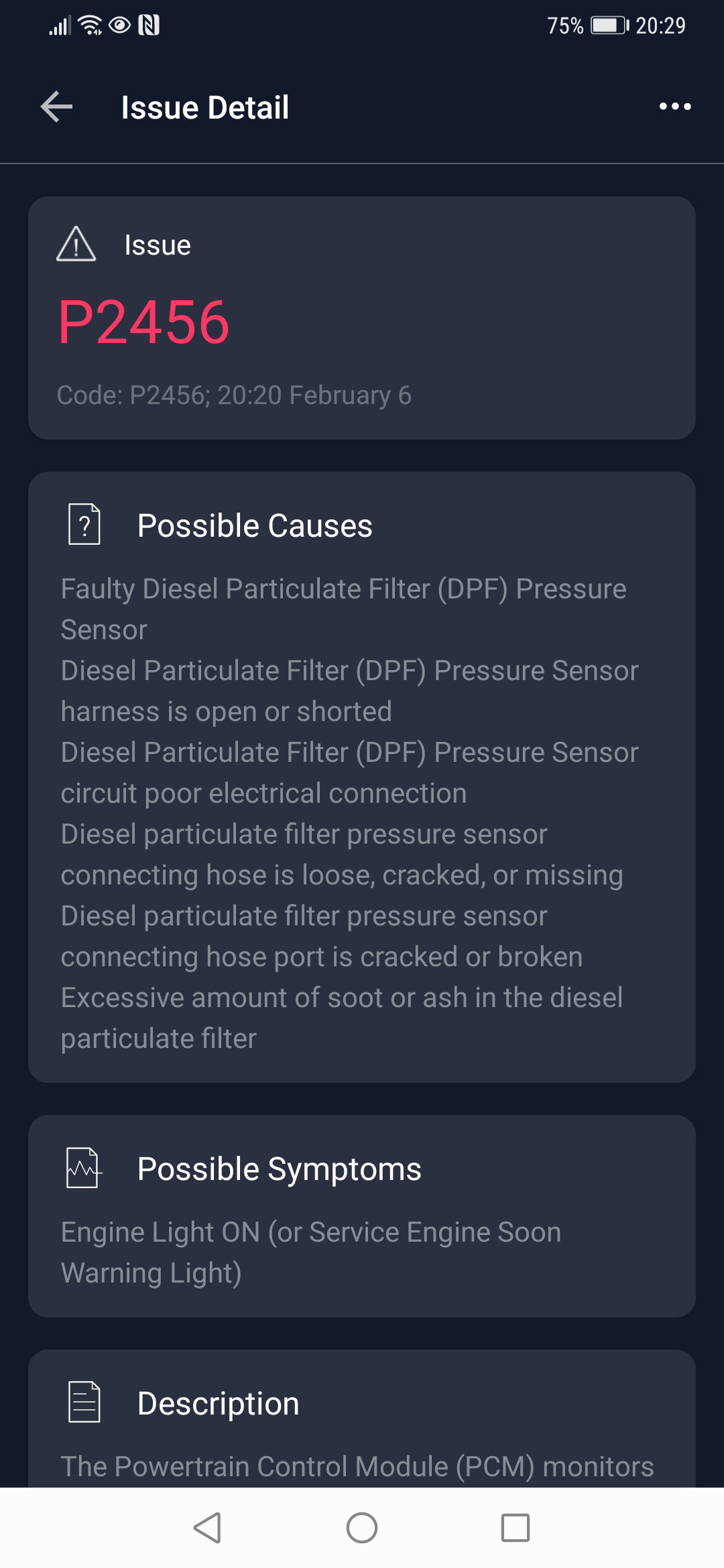

Hi, i have Audi A6 S line TDI ultra 2015 model, its giving P2456 error and when i checked the code its related to DPF, could anyone tell me how much DPF regen or removal costs and what is the best solution. Ill attach the pic of error.
Thank you

Екранна снимка_20210206_202939_us.nonda.zus.jpgthe differential pressure sensor is replaceable
