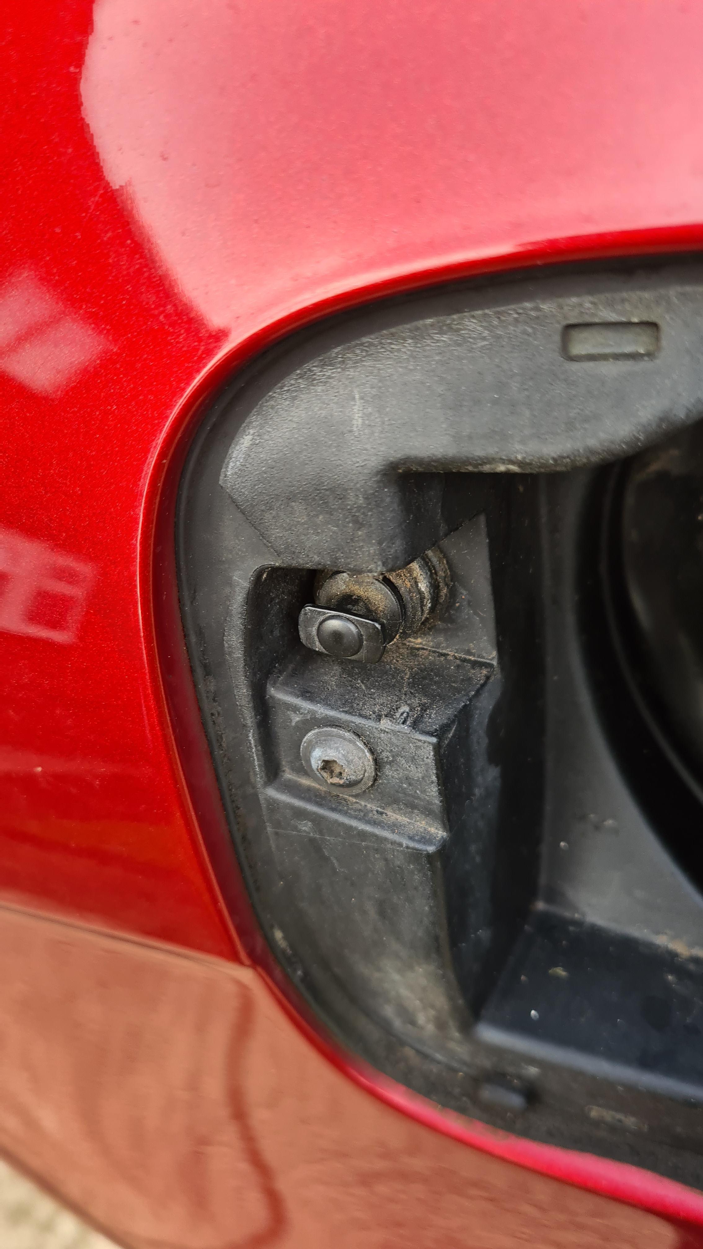

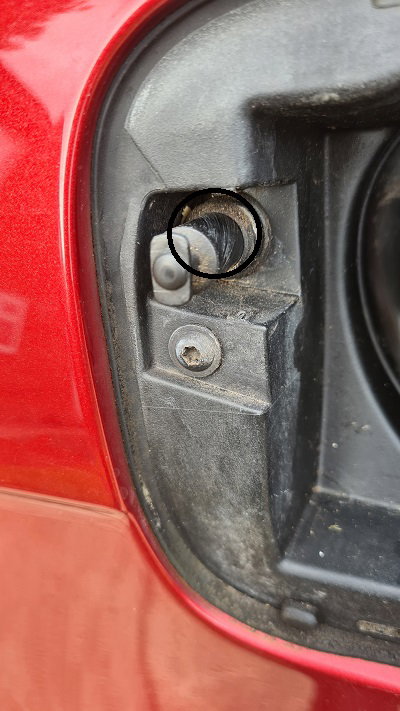

alpha omega Posted February 20 Share Posted February 20 hi louise, i know i have a different Audi to yours, but is yours a push in and out button like mine.(see pictures)if yes,do you have any wd40 or similar spray,and spray the part were i have circled it(pic 1) and keep pushing the button in and out while occasionaly spraying it.,and it may eventually come out. (pic 2 showing button in/locked).regards stephen 1 Quote Link to comment Share on other sites More sharing options...

Anton8 Posted February 20 Share Posted February 20 Hi Louise. Had a look at my Avant. Stephen is quite right as you close the lid, the plunger spirals in locking the flap. Perhaps as he has said it may be stuck in the down position. Tony 1 Quote Link to comment Share on other sites More sharing options...
