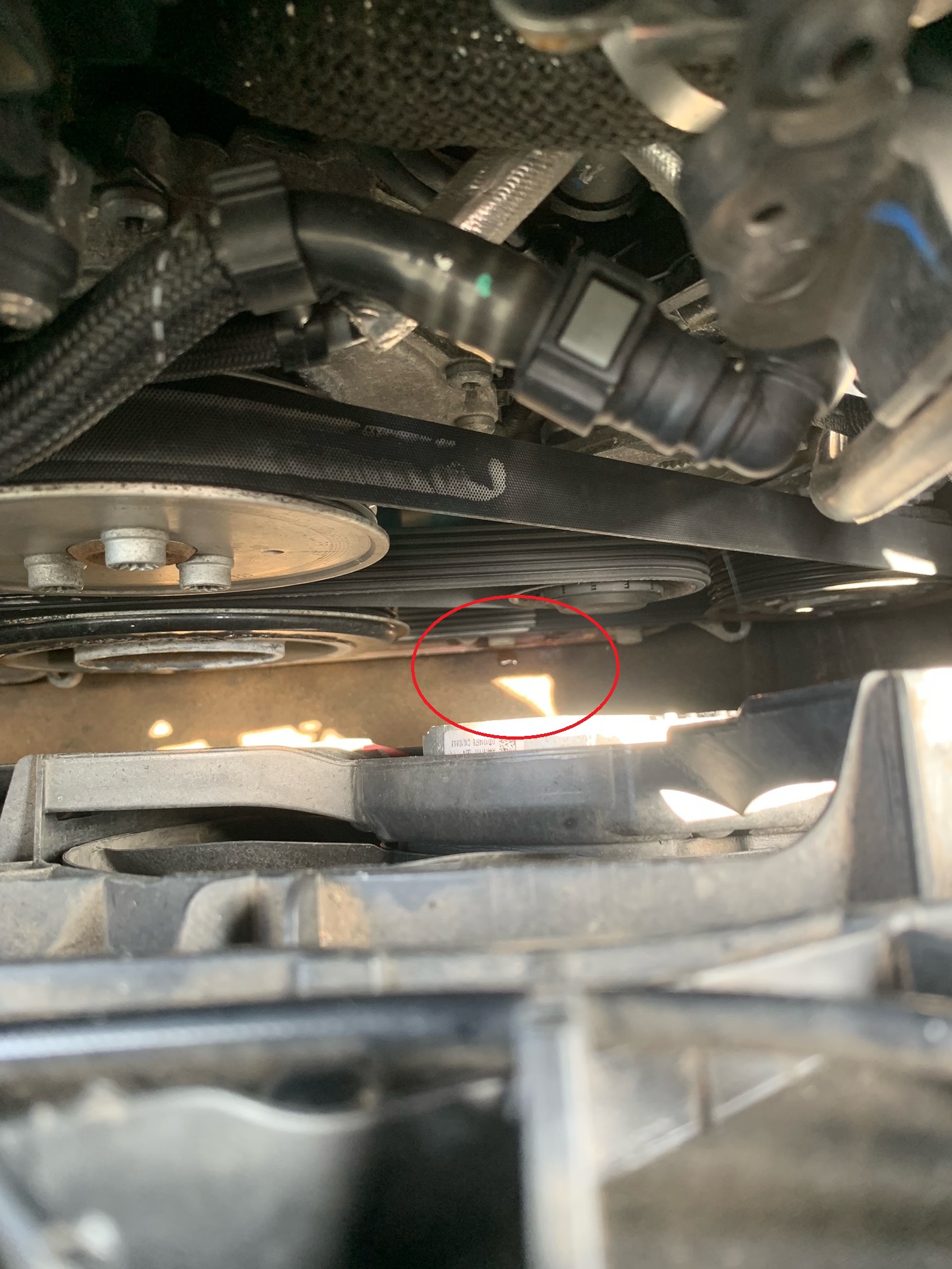

My first post on here despite lurking and reading for a little while to learn a bit about the C7/general issues.. I bought a 2016 A6 Allroad (218PS) in Feb and have had no issues with it since then - until now.. (It was only a matter of time, it's done 86k miles..). The day I bought the car and drove home, I notice the coolant was a little low so I bought some and topped it up to max and thought nothing more of it - since that point, I've done 2500 miles in it and thought I'd give it a check again. It was on the minimum line, and I think I can see the likely area (given a small drop of red water on the undertray) - is this likely to be a water pump issue given the location which is looking into the engine bay, from the front of the car on the right hand side of the floor (picture attached)? Or something else that the 3.0D is known for? I've got a warranty on the car but as I bought it from a dealer, the onus is really on him to fix it as the fault was there on purchase.
The second issue is an amber MIL light which came up on the dash a couple of days ago (not driven since). I've plugged a very simplistic wifi OBD fault code reader onto the car and had code P20EE & 17277 come up which I believe relate to a NOx sensor below threshold, but I can't get much further than that to work out which one with my device. I probably should just take this one to get sorted under warranty (but I know how these places like to squirm their way out of paying for things like this) so I'm trying to do a bit more homework. Do the codes I've mentioned relate to a specific NOx sensor or is it too difficult to tell that from those codes and more investigation is required?

A good friend of mine had a RS6 with the same issue, he would top up the level and it would leak a little 'from somwhere' so he took it back to Audi after becoming obsessed with it... Apparently it was releaseing additional coolant to bring back to nominal level, so he stopped topping up and remained steady around the min level.

Absolutely, I think the leak was there when I bought the car so a dealer has an obligation to rectify that fault via warranty or otherwise. I've got plenty of texts to/from him covering that so should all be fine - good point though!
Agree - but like with all things, the warranty is pretty incomprehensive.. It includes £50 diagnosis (cost to diagnose is circa £70-80), then they'll cover £50 an hour labour, but labour here is £80-85.. So if I can do a bit of diagnosis here, I'll end up saving myself some money as I'll have to shell out for the diagnosis cost over £50, along with any labour costs over £50 too..
4 hours ago, Morgan79 said:
A good friend of mine had a RS6 with the same issue, he would top up the level and it would leak a little 'from somwhere' so he took it back to audi after becoming obsessed with it... Apparently it was releaseing additional coolant to bring back to nominal level, so he stopped topping up and remained steady around the min level.
That's interesting.. I'll keep that in mind. I'd be a little surprised to see coolant weeping from the area in the picture if it was just settling to a nominal level though, I'd assume it'd come out of the expansion tank overflow rather than from somewhere that looks suspiciously like where water pump is located. Is the water pump in that area? I can't seem to find any diagrams that I'm sure match my engine..

Coolant Leaks
Take the plastic engine cover off... Shine a torch down the 'V' of the engine and look for the reflective shine of wet metal and/or puddles down there... (V6 Engine, has two sets of 3 cylinders, and a lot of pipes and cables running down the V that runs front to back between the cylinder heads - for those that might not understand what i mean) Towards the back of the engine there is a valve called the "Cooling System Bypass Line Adapter" - a valve controlled by a Vacuum line that diverts water to/from the Exhaust Gas Recirculation system when required... That's what failed for me recently, and is a commonly known fault for these 3L V6 TDI Engines.
The good news is that the replacement valve should cost between £35 and £60 depending upon where you get it from.
The bad news is that they have to practically disassemble the EGR system and clear out all the cables/pipes in the V of the engine to get to it and replace it - so Labour to fit the !Removed! thing cost me £600.
The result is good though - coolant stays at whatever level is put in...

Thanks Tigger - yeah aware of the engine layout and had read about that valve leaking on this forum but had a poke around initially and couldn't see any wet areas. Your post made me go out again and have another look and sure enough, I can just see the bottom left part of the oil cooler with some coolant around it, so it'll definitely be a similar thing. On that other forum there seem to be a few other bits which could be leaking too, so I think I'll probably strip the engine at some point soon, buy a load of those bits and just replace them for peace of mind. I haven't worked out how it's dripping down the front of the engine yet but it's probably just the path it travels due to gravity rather than being a water pump leak too. Is the water pump located on the front right or front left of the engine do you know?
