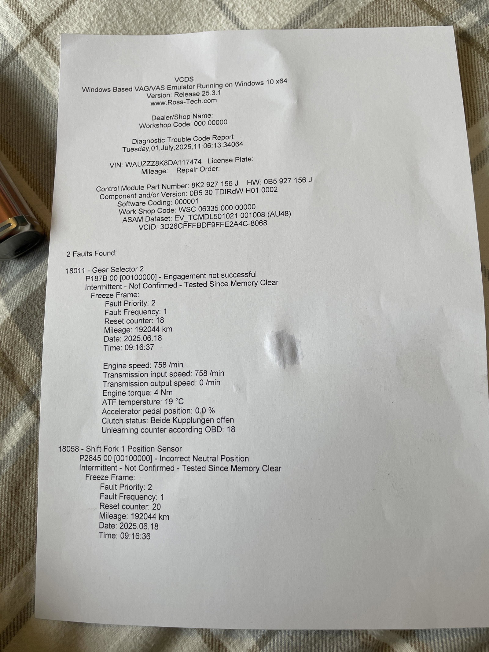

I’ve included the diagnostic report.

Just posting an update to let you guys know, another gearbox oil change has sorted the previous issues. There was an oil leak on the Gearbox. Happy days
That's right, I noticed a horrible smell when driving the car and it turned out the gearbox oil was leaking onto the exhaust. The garage did an oil change again free of charge.
