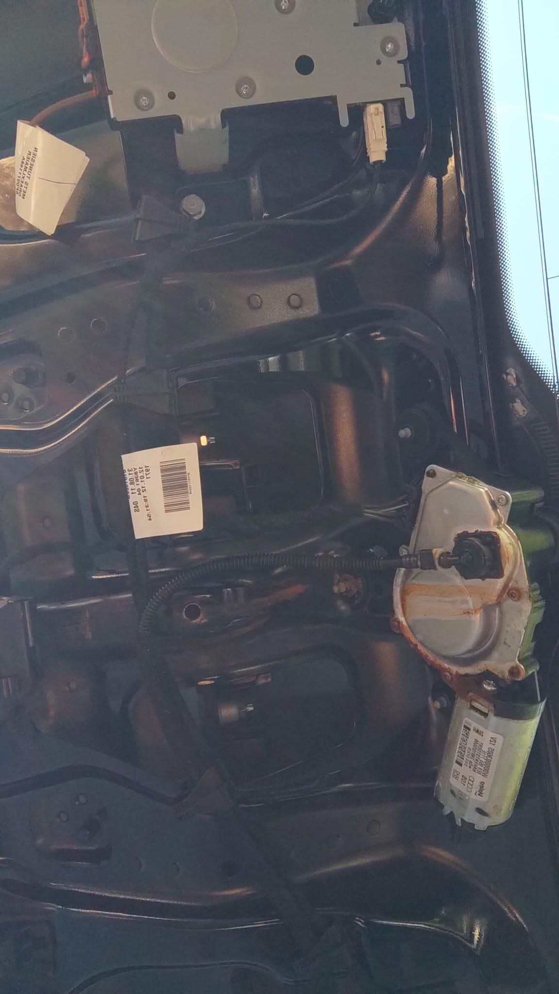

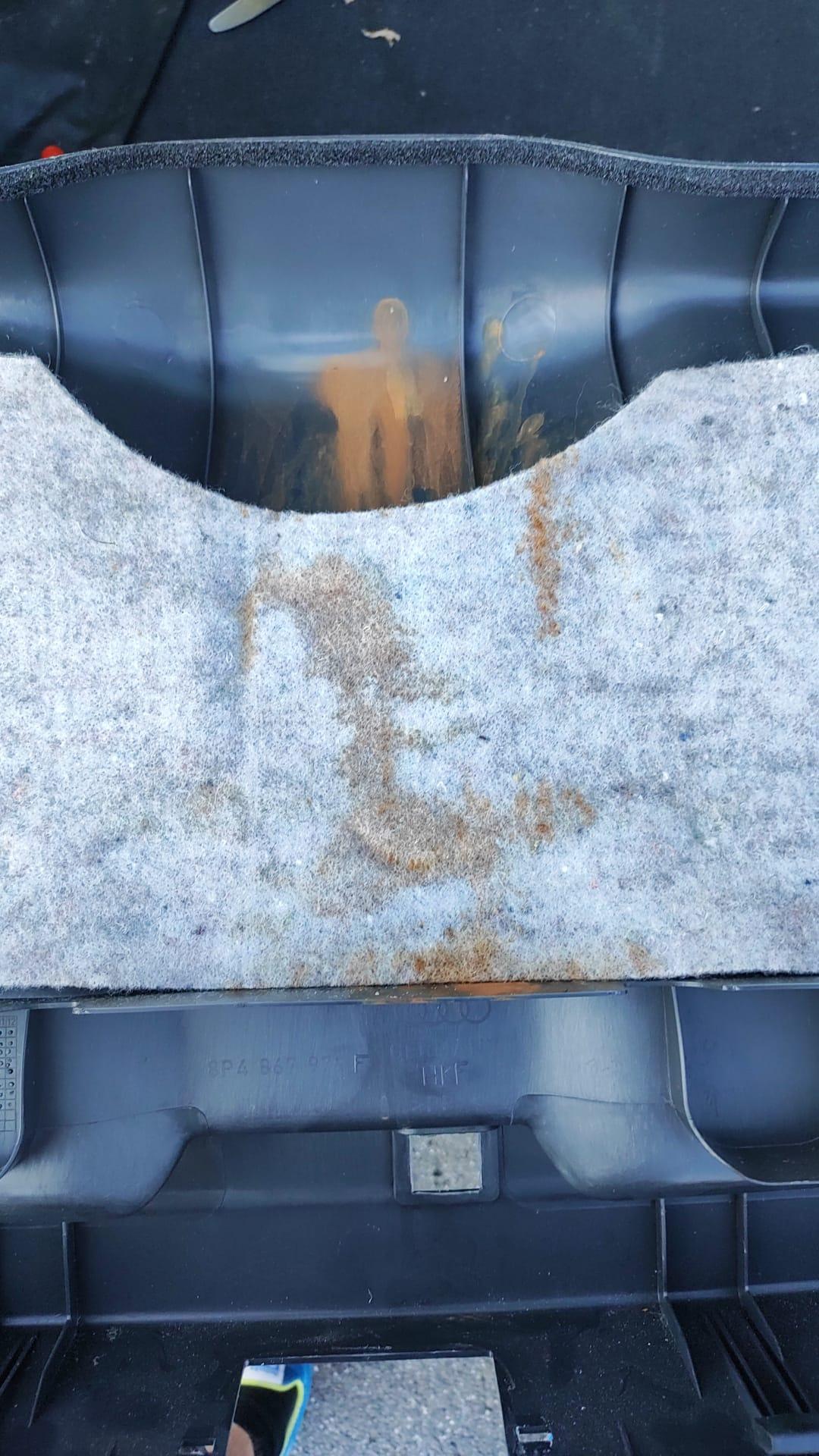

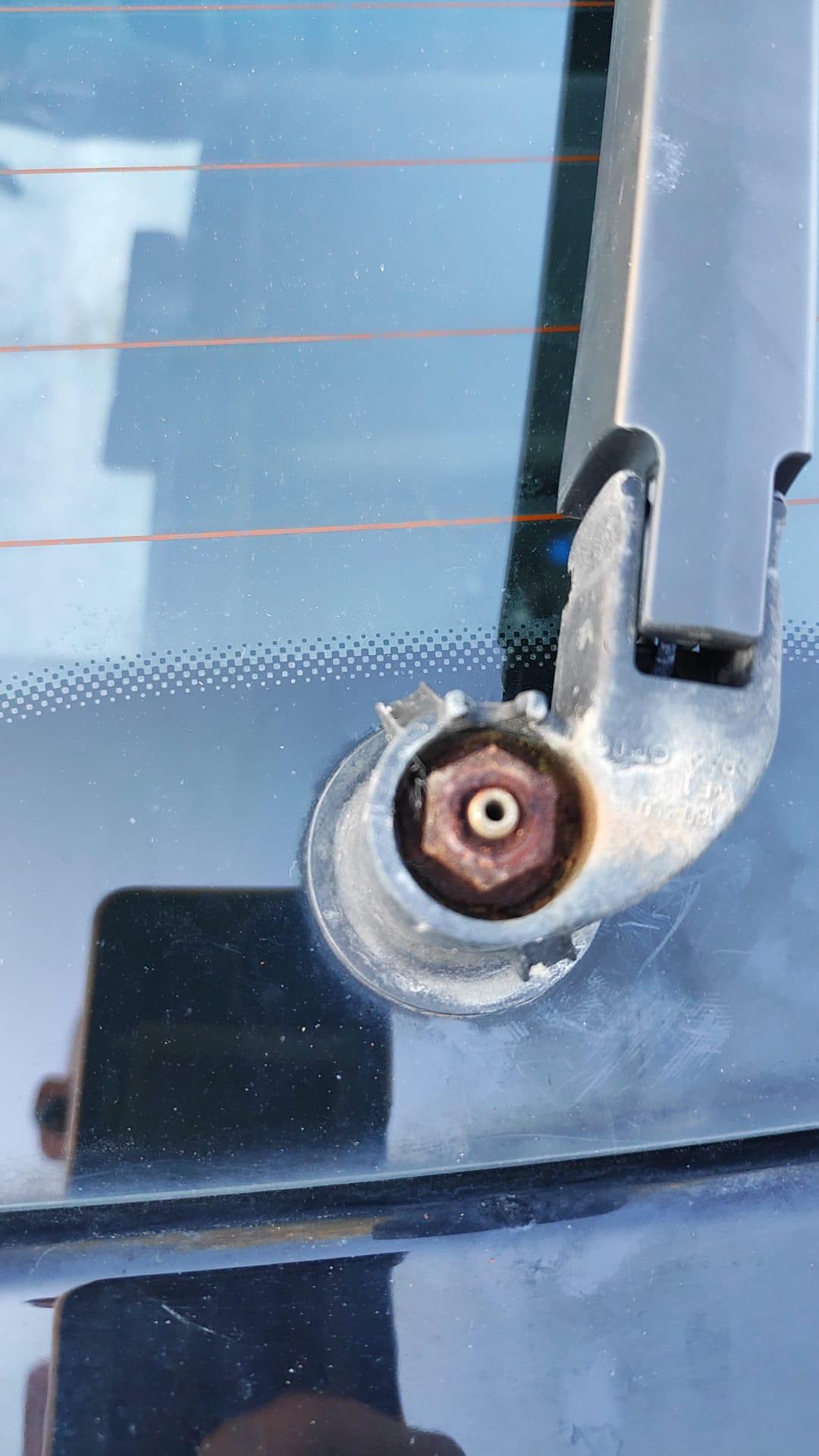

I used some links of Youtube to remove the boot trim and wiper motor. You can see how rusted the motor is, which was leaking down on the inside of the bottom boot trim. I'm pretty sure the water is getting in around the wiper arm/seal.
I will order a new motor unit, but not 100% on the seal. I could order a new seal or use some silicon sealant to make a better seal on the old one. Any suggestions appreciated.

Hi Leigh, does look like a motor leak. Order new motor unit and see I guess. As I noted I also bought a wiper arm removal tool to help in removal of old unit. I did try using silicon spray to 'soften up' the seal but mine was pretty squashed in places so ended up replacing to be on the safe side. Bear in mind that my car was 19 years old when seal replaced (only 10 when wiper motor needed replacing). Good luck.
