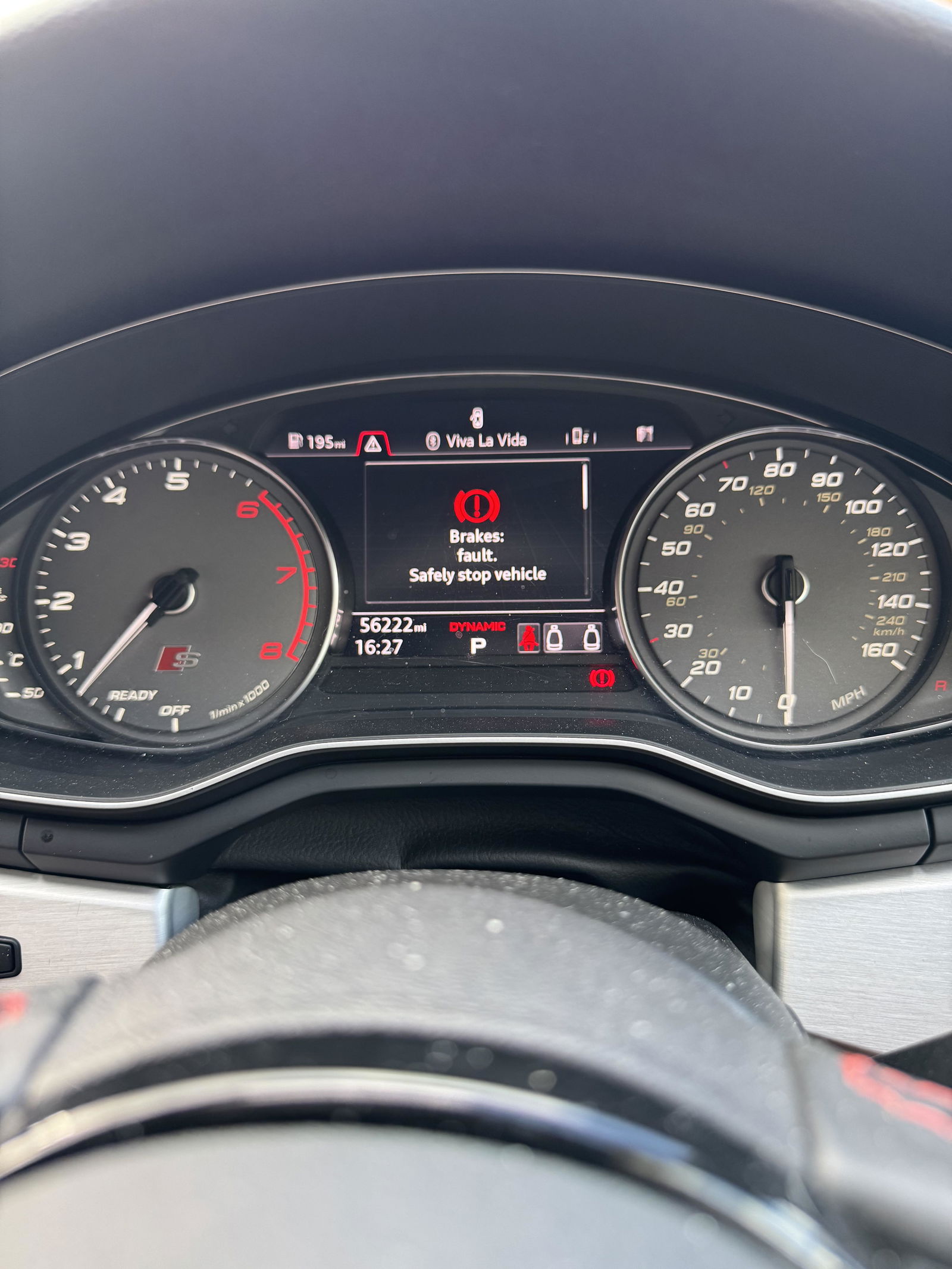

I have had some issues with the braking system on 2017 Audi S5
Currently the ABS ECU has been sent away for repair now 3rd week without the car.
My question is can I find out if these faults, specifically the brake servo one could of been cleared by the car dealer I bought the car from, and is there a way to check this using a specific diagnostic tool?

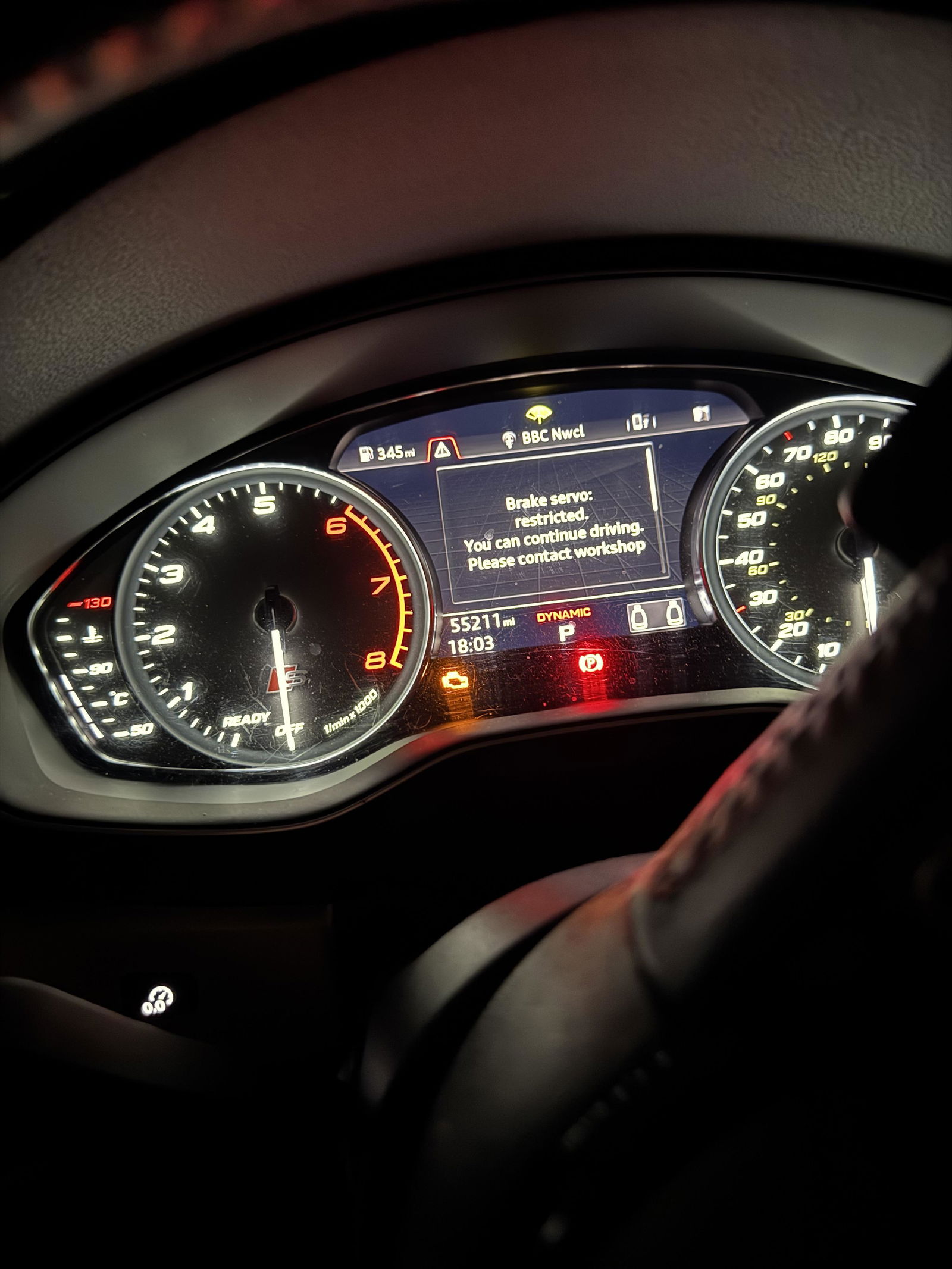

Not sure if you can find a smoking gun so-to-speak. VCDS scan would be diagnostic tool of choice, and if error was previously logged but DTCs were not cleared, then that historic data will be there, including instances. I think that’s remote, but never say never.
I assume this is brake servo pressure sensor error? Audi onboard computer says keep driving but seek service centre. Reality is that damages ABS as you’ve found out.
Other avenues, speak to Audi to see if fault was previously logged with them on digital history.

Ahh, indeed exactly what occurred.
