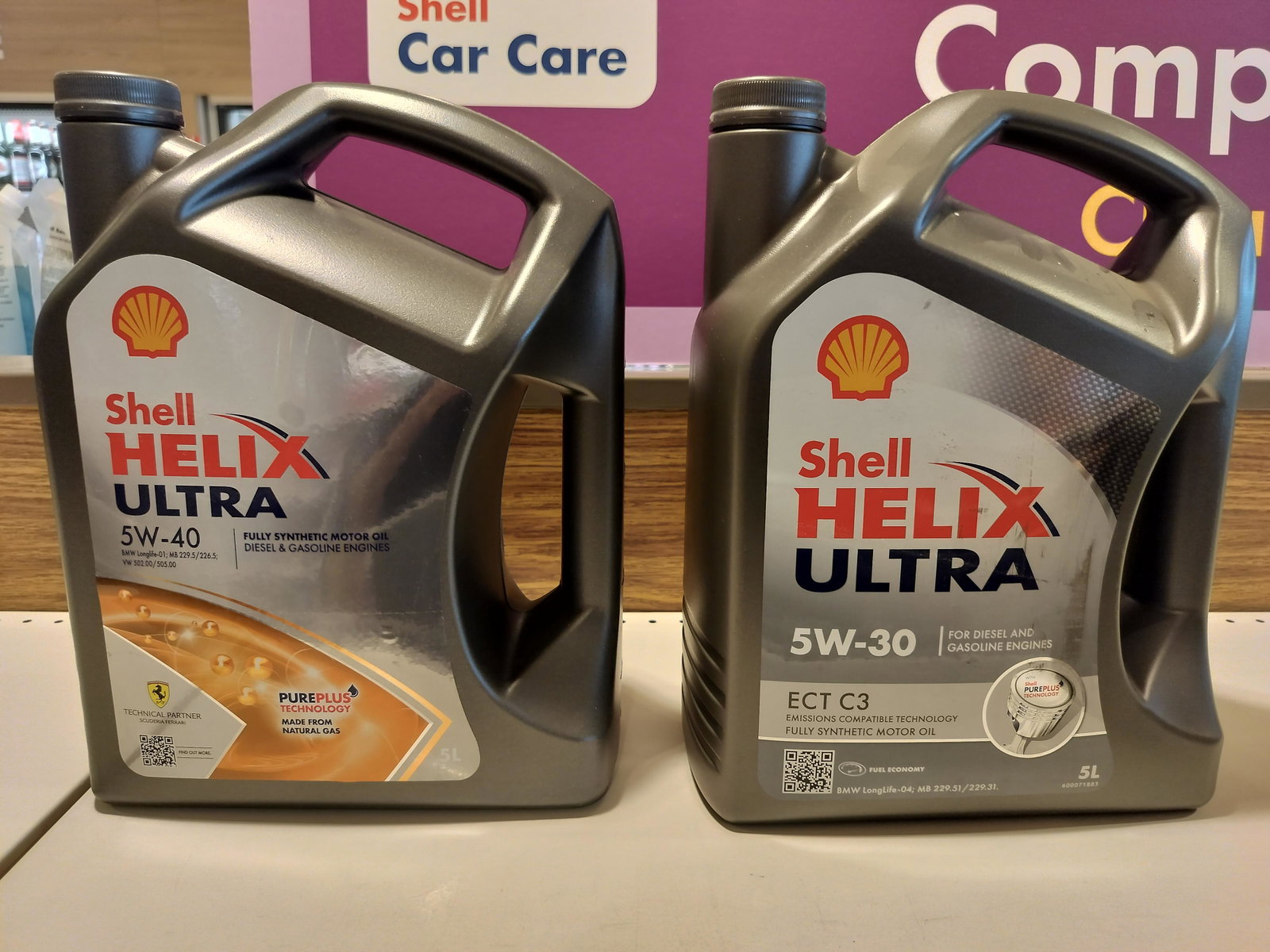

westlondonsun Posted May 29 Posted May 29 Newbie here .. Hi.... I live in UK and own an Audi S5 Sportback 3.0TFSI (2017). Car is no longer under warranty and want to move away from 0w20. I can get engine oil from Shell via my company fuel card.... from Shell ...they sell these two: Which of these is right for my car ? I drive my car : - Mostly on motorways - Don't drive too spirited (only occasionally, never track day etc ) I'm not concerned about fuel economy or frequency or engine oil changes. Want to ensure I give the engine the best protection. Which of these do you recommend? Shell garages near me usually stock 5W-40 in 5-litre containers, while 5W-30 is harder to find. I'd prefer using 5W-40 since it's more convenient to buy, but if 5W-30 is significantly better for the engine, I'm happy to travel further to get it when it's time for an oil change. Thanks in advance for any replies. Hoping to buy on Sunday so hopefully someone can advise before then.
Magnet Posted May 29 Posted May 29 Welcome Parm and thanks for joining. So why do you want to move away from 0w/20 if ( in caps) this is the grade specified in your handbook or some other official VAG publication? As well as the grade, there will also be a VAG specification within that grade which the necessary oil must specify - as they say on the tin. Although I use the correct grade of Shell Ultra for other cars, I only use VAG’s branded oil -Quantum- in our 176K A3. In case it helps, I use their Longlife 3 ,but treat it to an annual oil change irrespective of the much lower mileage covered annually. I usually buy from reputable sellers on eBay. Kind regards, Gareth.

Magnet Posted May 29 Posted May 29 No problem Parm, but if you decide 0w/20 is the way you will go, it won’t just be any 0w/20 - or necessarily a Shell brand because you can get it at a discount - but it must be confirmed to satisfy whatever VAG’s specification is within that grade.

Samurai_J4Y Posted June 18 Posted June 18 Hello, New around here, but I believe that the S5 uses VW 508.00 Spec oil. Although most oils will state VW 508.00 / VW 509.00 spec. Any oil with this spec should be fine for the S5 (B9).
