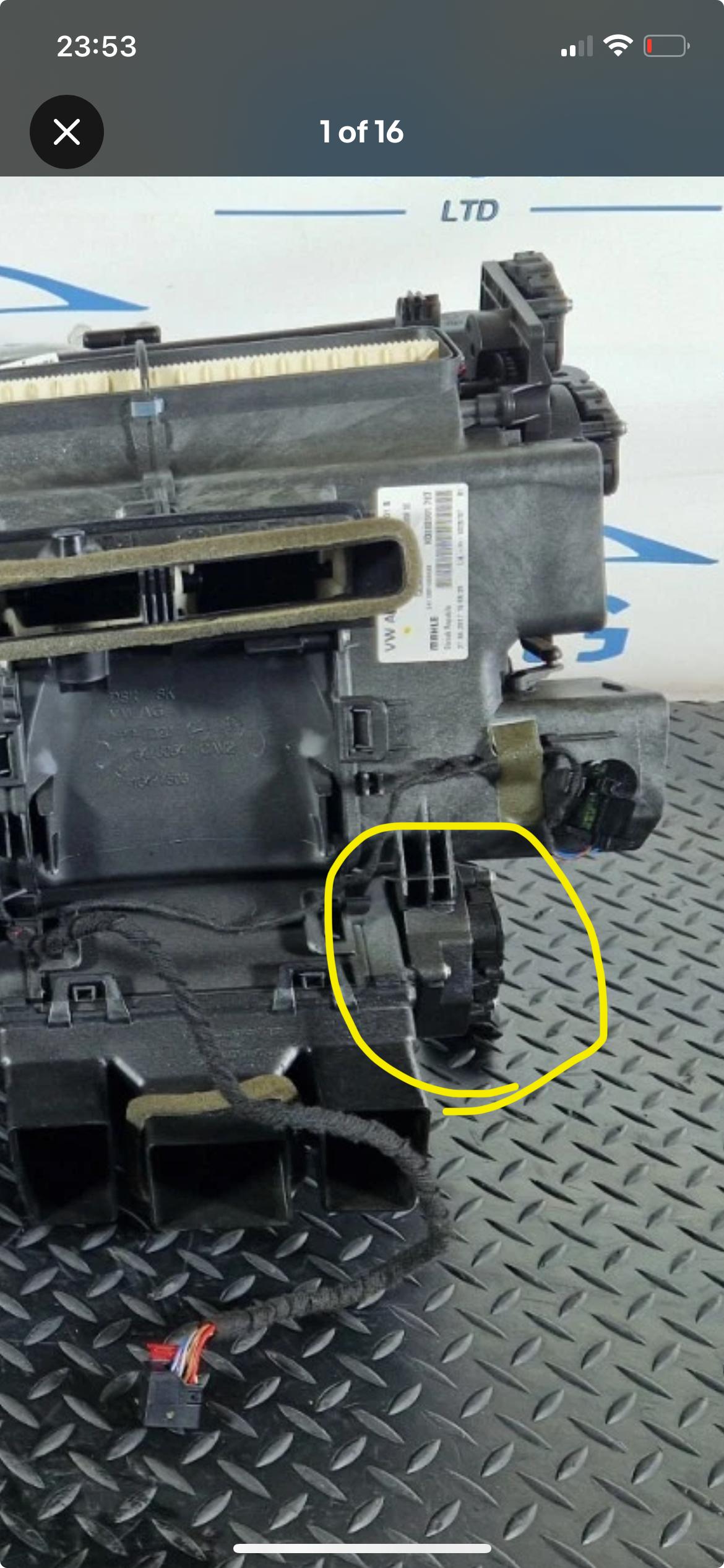

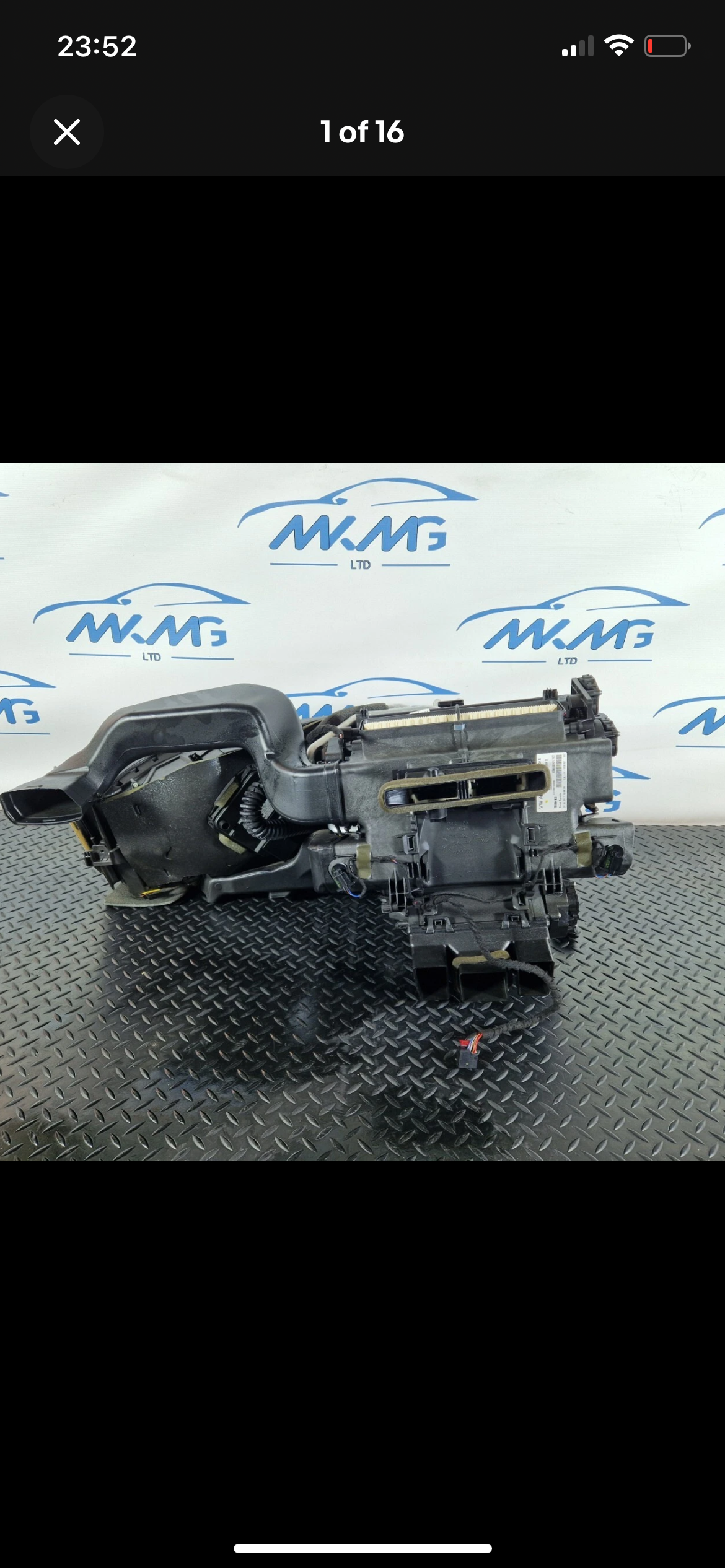

Can’t say for certain but I would think it maybe the motor circled in the photo
I would try unplugging it and scan again and see if you get a open circuit fault or something similar
