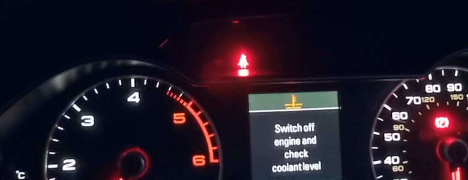

Took my car in for a service ~Oct 2025, before its’ MOT was due mid Dec. A few weeks after the service I say a fault (temperature/coolant) come up instructing to turn the engine off and check the coolant. Did that and the coolant reservoir/bottle was full. Mentioned this to the mechanic when I took it in for the MOT and ask him to have a look at it.  MOT passed, the mechanic handed me the key, so I asked about the fault and what the diagnostic came back as - he said “all clear”.
Since then, the fault has come up quite a bit but the frequency has increased from 1-2 times over a journey to almost every 20mins. Called the mechanic and he says to bring it in this Friday, as it could be it needs a replacement coolant bottle. Another (different mechanic at my tyre shop) said previously it may be a faulty sensor. I also noticed the radiator fan stays on for an extended period after the engine has been turned off. I think it being winter has saved my bacon.
Typing this in the car and recorded the dash - from turning the engine on and the fault came on at 08m06s. I’ve even bought one of those Veepeak ODB2 BT scanner to at least have a better understanding but don’t quite understand it.

I've aded a screenshot, just in case the vid is unplayable
Level sensor, or quite possibly a poor connection onto it, on the reservoir.
Worth getting some contact cleaner and removing the plug, spray and refit.
