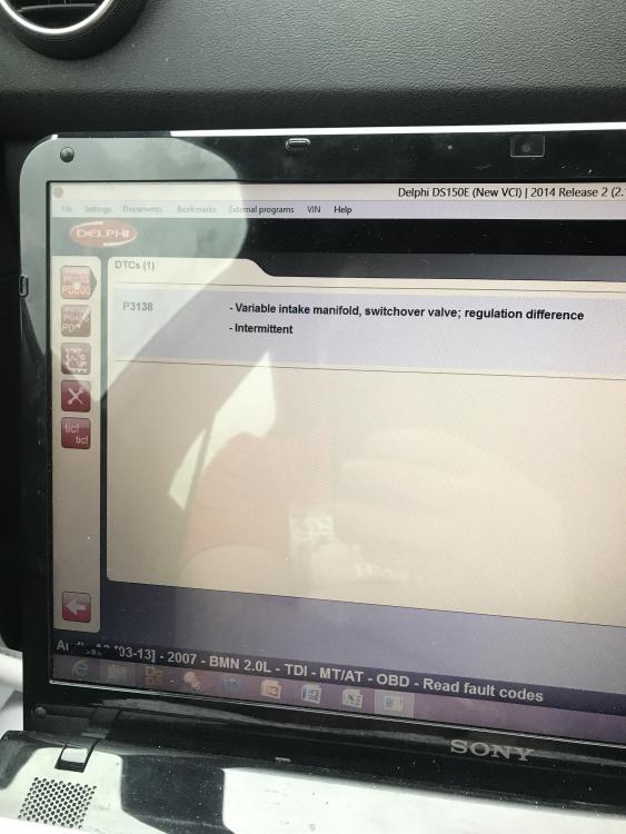

Hi, all had my car read yesterday, and I've got code p3138 which is variable intake manifold, switchover valve; regulation difference. Has anybody had this fault before and could shed some light on it for me please? I've had the glow plug light flashing that's why I had the codes read.
I would advise running a fuel cleaning solution through the engine and also one for the intake as it sounds like the valves are sticking with carbon build up.
Possibly try Terraclean treatment and I believe that they come out to your home or workplace to clean the engine through
Thanks for th reply Trevor, I have a fuel cleaner ready to put it just waiting to use up my remaining diesel. For the intake what solutions are out there for that as I've never owned a diesel before I've always been a petrol kind of man. I was maybe thinking of a terraclean as a last solution.
