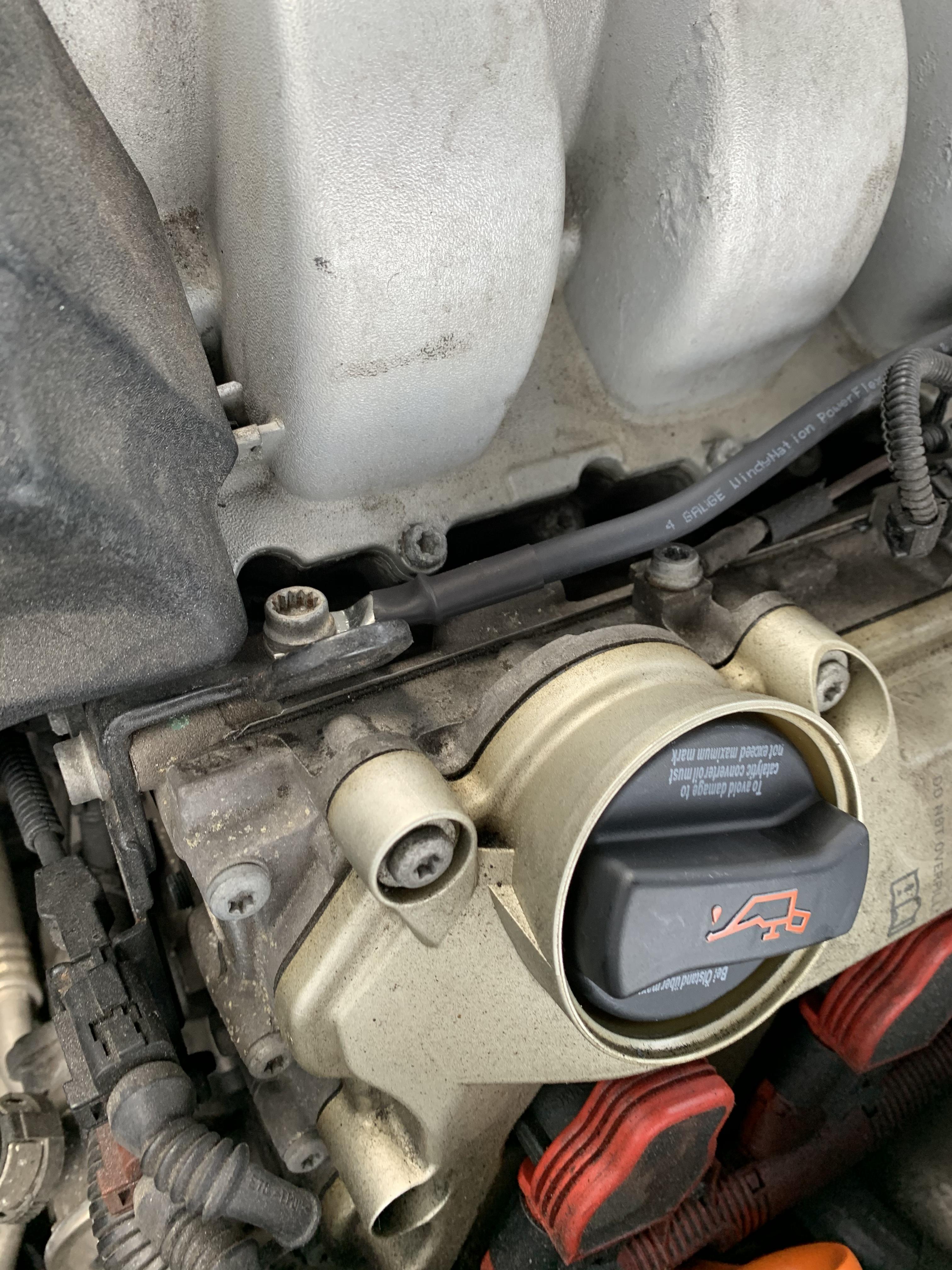

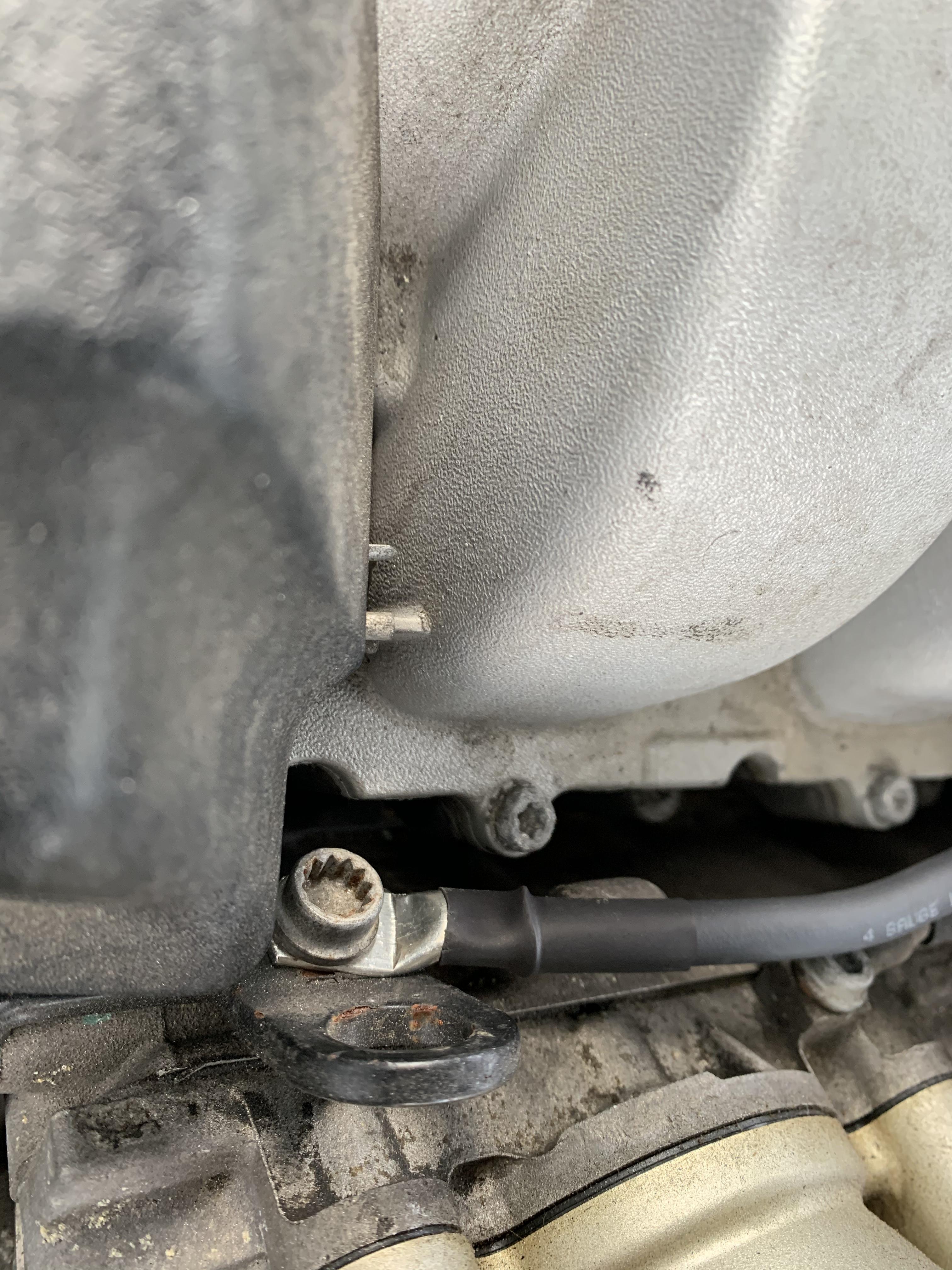

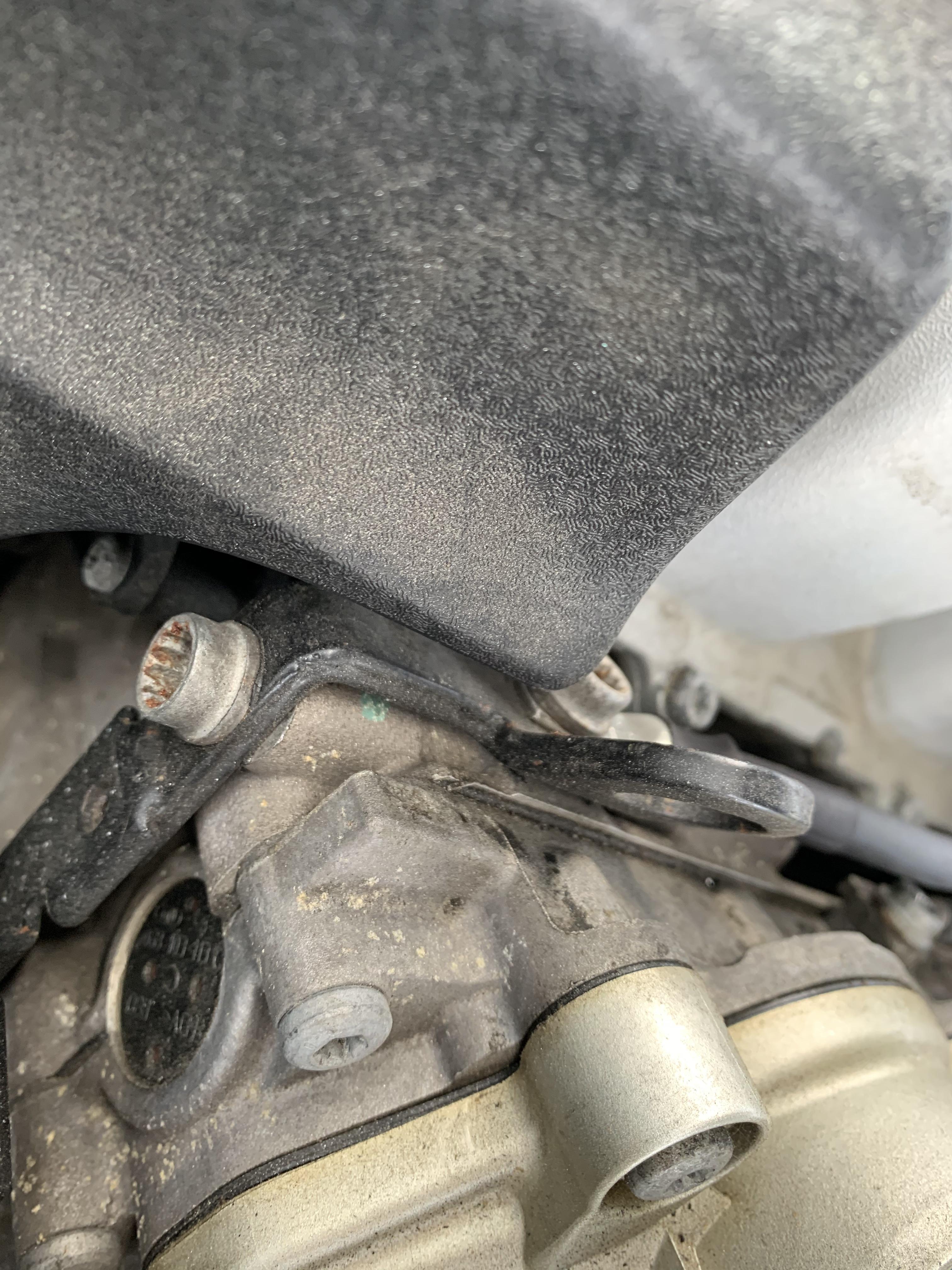

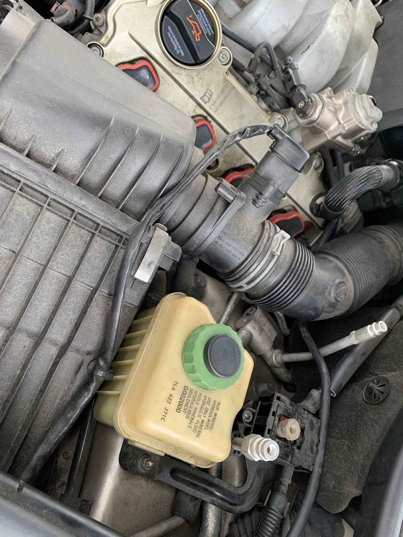

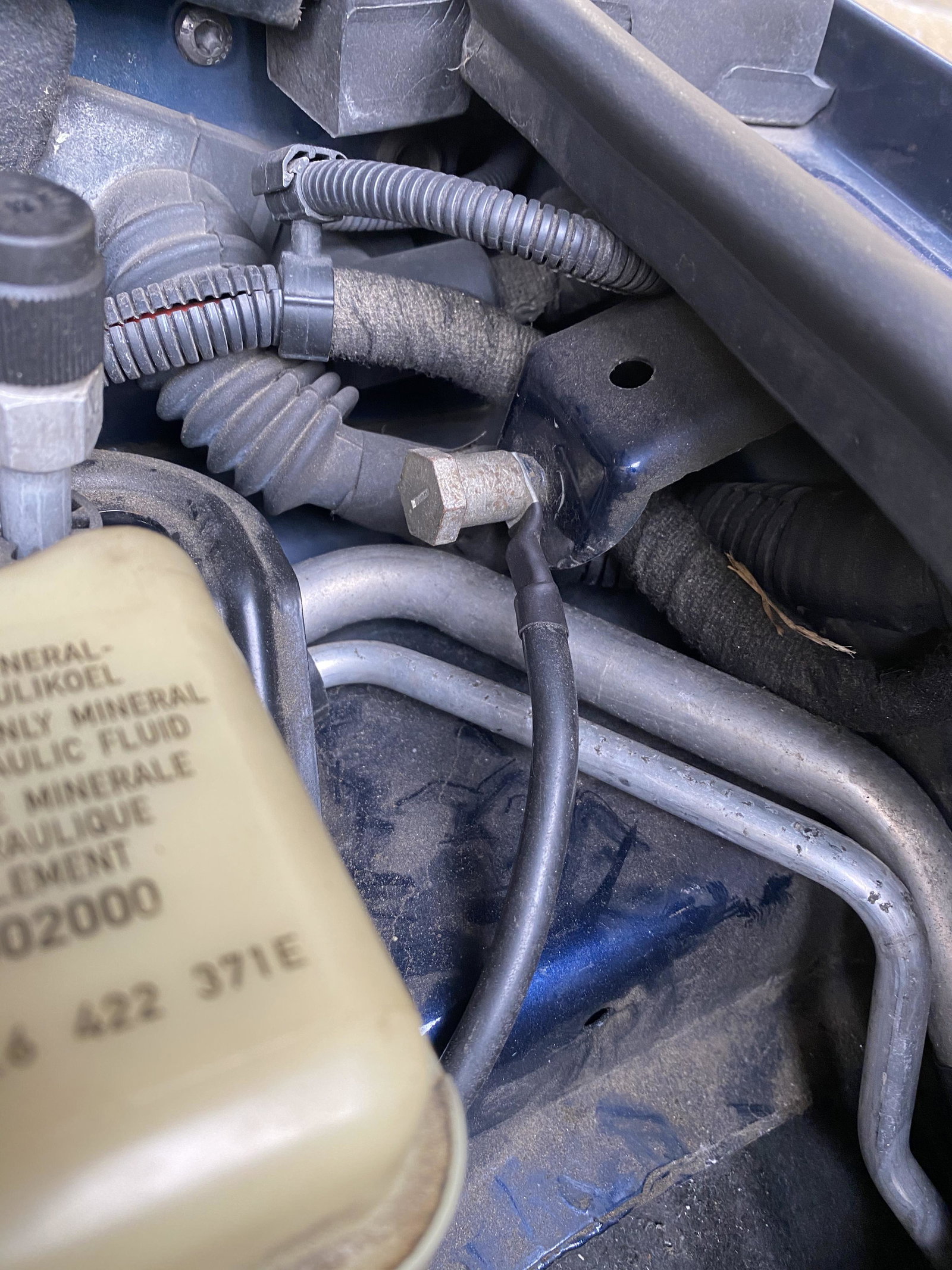

Nycaudi Posted July 22, 2020 Share Posted July 22, 2020 Hi i am having same issue can you provide a picture so that i can see your two grounding points? I want to do same to see if that helps with my slow start Quote Link to comment Share on other sites More sharing options...
Bigdave1230 Posted July 22, 2020 Author Share Posted July 22, 2020 Quote Link to comment Share on other sites More sharing options...
Nycaudi Posted July 22, 2020 Share Posted July 22, 2020 Hi, thanks for the reply. Now how does this help with starting? I know the manifold inlet does not make contact with starter. Now does the negative lead terminal for jump starting making contact in another place with starter? Quote Link to comment Share on other sites More sharing options...
Nycaudi Posted July 23, 2020 Share Posted July 23, 2020 if you can please tell me how this help with starting if the two grounding points are not related to started or engine? its going from terminal lead to manifold bolt. unless the actual negative terminal lead its also linked to other grounds in the car? is that what it is? also what lenght wire and gauge do i need? 0/1 awg 2ft enough? can it go from negative to valve cover ground bolt instead because i have a v8 q7 and not sure if i have that manifold bolt you have there or may be at different location. i appreaciate your help and if you can answer those questions i will appreciate. Quote Link to comment Share on other sites More sharing options...
Bigdave1230 Posted July 25, 2020 Author Share Posted July 25, 2020 😳 it’s negative don’t try it from the positive! You can go to any bolt on the engine as long as it’s not into anything plastic. I’m not sure what gauge cable it is as the auto electrition supplied it but you should be able to get one from any car spares shop. Quote Link to comment Share on other sites More sharing options...
Nycaudi Posted July 25, 2020 Share Posted July 25, 2020 Yes i know its negative but how does that help with starting? Is the negative linked to ground off the starter? Quote Link to comment Share on other sites More sharing options...
Bigdave1230 Posted July 25, 2020 Author Share Posted July 25, 2020 All negatives on the car are linked. The negative terminal on the battery goes to the body of the car. The negative from the starter goes to the body that’s why they are called earths/earth straps. The problem isn’t the positive as that’s a dedicated wire that indirectly goes straight to the positive terminal on the battery. The negatives/earths at the bottom of the engine are open to the elements and corrode against the body and as such mean that the system can’t make a good circuit. By putting an extra earth/negative at the top of the engine the you are improving the circuit. You could just get a jump lead and connect from the terminal in the picture to anywhere on the engine to see if it cures your fault. Quote Link to comment Share on other sites More sharing options...

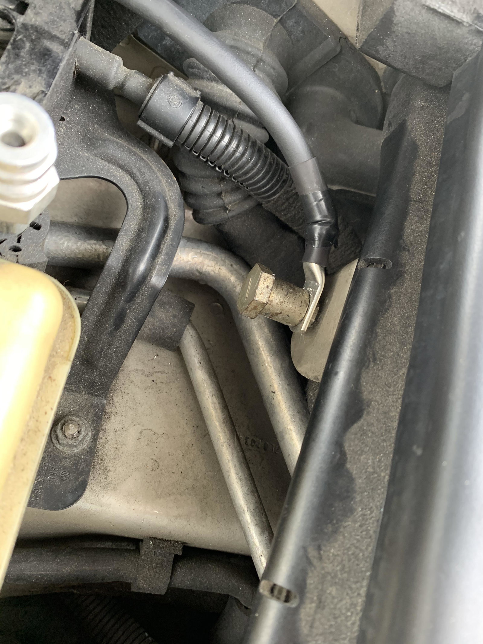

Nycaudi Posted July 26, 2020 Share Posted July 26, 2020 I used this bolt to ground. Is this a good ground? Cable i got was too short and i found no other places in the engine without a gasket Quote Link to comment Share on other sites More sharing options...
Bigdave1230 Posted July 27, 2020 Author Share Posted July 27, 2020 Should be fine. Has it fixed your problem? Quote Link to comment Share on other sites More sharing options...
Nycaudi Posted July 27, 2020 Share Posted July 27, 2020 Unfortunately no, but ill keep that extra ground as its good to have. I am thinking leaking valve cover gaskets and bad pcv may be issue now Quote Link to comment Share on other sites More sharing options...
