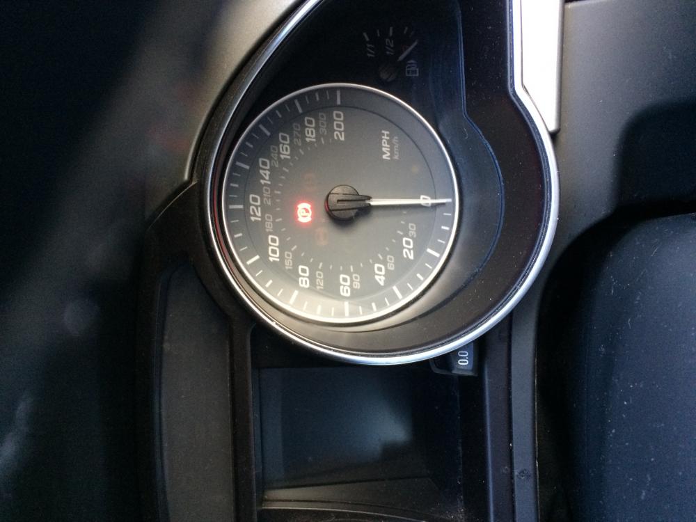

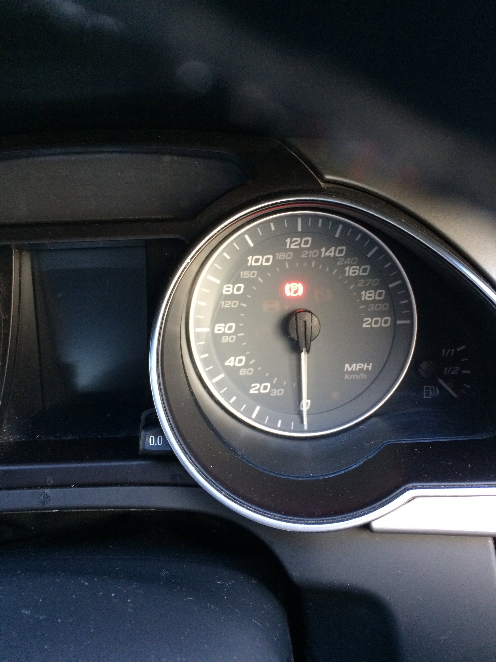

Speedometer back illuminating light flicker
The dimmer control knob doesn't affect the light but the section flickers from 20mph to 40mph so partial flickering very distracting while driving any way I can resolve it?
It's hard to explain it flickers just in that area will take a picture or video an upload maybe that can explain better than me lol where is the resistance switch located? Cheers
No unfortunately not bought private. 😒 I bet main dealer charge through the roof for replacement.
Just flickers between 20-60 rest is ok.
Ok so went to Audi this morning they confirmed haven't had any issues with these being a common fault, talked the warranty card but unfortunately not in so either pay £1,000 to them to replace whole instrument cluster or try Dash Repairs a company who would take your faulty item and repair surely got to be worth a try right. Watch this space.........will upload details as and when i get more info.  :)
I have just got off the phone to Cluster Repairs Uk located in Great Yarmouth the guy informed me on this model this is only the start eventually all the illuminated cluster will go including the needles so based on that the whole Cluster Unit would be repaired and would be 10-15% brighter illumination at a cost of £150 includes VAT and return postage.
