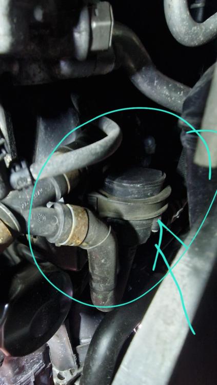

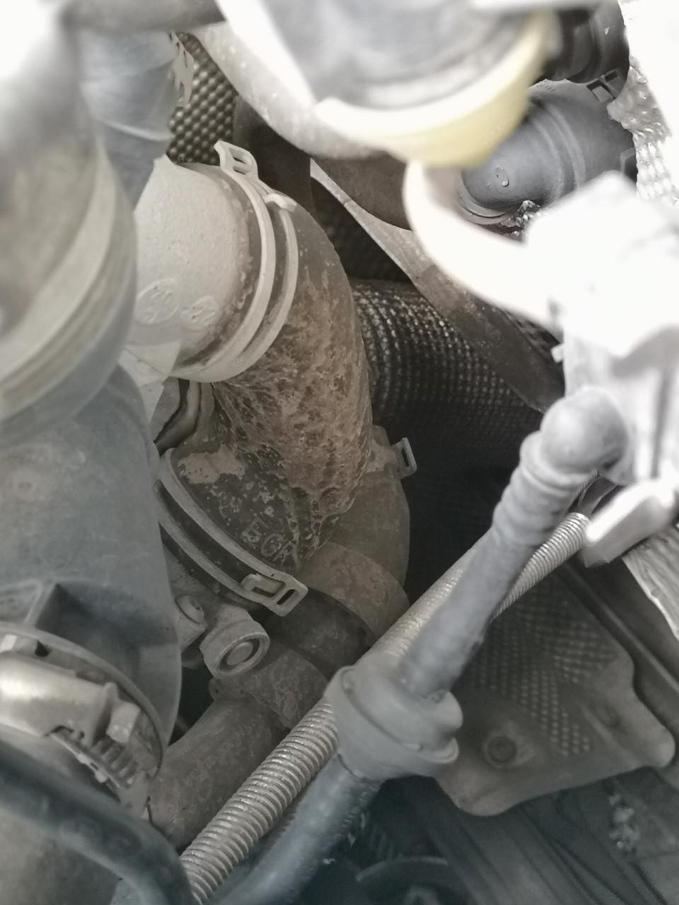

Hi all,
I'm trying to diagnose why I've got no heating in an A3 2014 8V.
All my temps seem to be fine and we're not overheating at all.

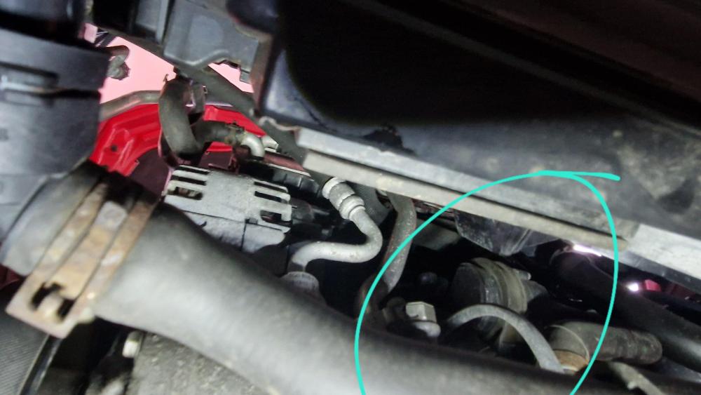

I don't have VCDS so this makes it slightly more difficult however.. I have located the what I presume to be the in/out feed into the heater matrix.
The top hose feeding into this gets hot and I would assume this is the in, however the lower feed remains consistently cold even when up to temp. I am assuming the heater matrix is blocked, however is there a solenoid or valve behind this at all that could be stuck?
My other way of trying to clear this blockage was to maybe disconnect the lines and pump fresh water through the matrix to try and clear any blockages from both ways. Thoughts?
The heating hasn't worked in around a year and i'm sitting at 110k miles so it's due a full coolant flush any minute anyway.
Any help much appreciated!

Hello Tom,
I assume you have individual heater controls to separately regulate the temperature on driver and passenger sides, and by what you say about the different temperatures of the heater hoses, it is probable that both sides lack heat.
You could try squeezing the hoses with the engine up to temperature and running, and controls set to max. heat - obviously respecting all safety requirements. You might find you will feel air locks and the hoses will then reach the same temperature. I have my doubts this will work however, but worth a try.
Blocked core? I seriously doubt this on a car of this age. Personally I would not try to back flush it?
My stab at this is that it is some form of electrical control valve issue, but a guess it is.
By what you say about the fault existing since last year, it would seem that the car was marginally in/ just out of warranty, but....

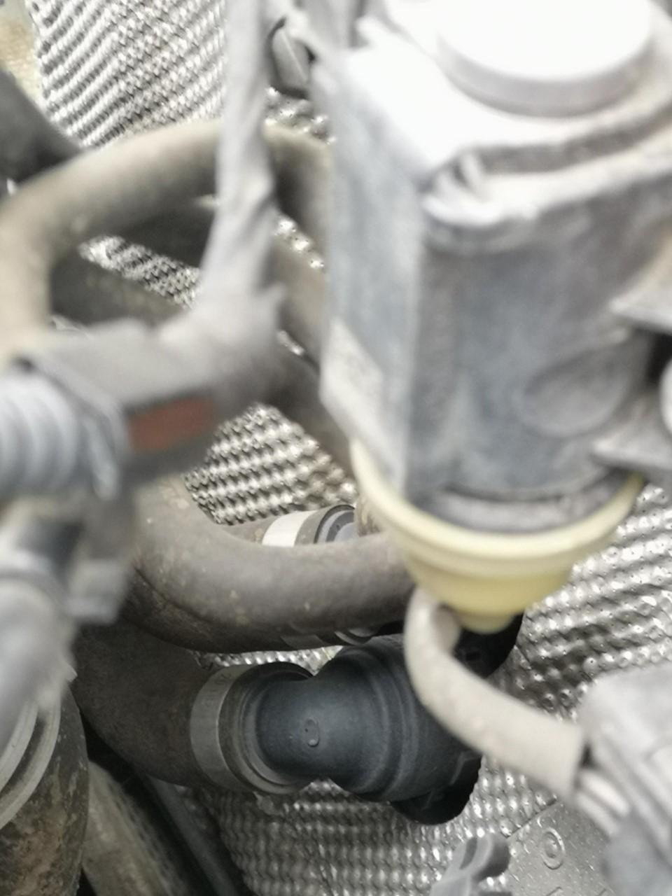

Is anyone aware of the solenoid that controls the heating? To me everything is pointing toward this core being blocked OR the valve control (if any?!).
The thought of the backflush would be to see if anything is passing through the system, which currently it seems like it's not. Other option would be to leave the hot (in) feed and disconnect the line thats running cool and see if coolant passes through. I'm looking to do a full change on this anyway along with cambelt/waterpump so it could be a good time to address it.

Back to heater:- I share your opinion that the problem here relates to a heater control valve, and if this were mine, I would wander into my local Audi dealer and ask about 'this valve'. They would then clarify what is what in relation to what it is, and if they tend to give problems.

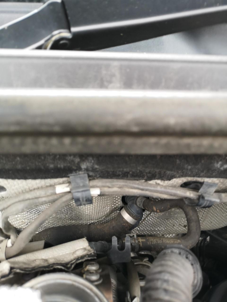

Hi there,
Sorry for my late response I've been working on this in the background.
So I had the dash apart and looks like the heater control flaps in the matrix are working, when AC is on the flaps function and without AC the flaps function from hot/cold.
This would indicate that the matrix itself is blocked OR the control flap itself has actually snapped i.e flap inside matrix isn't opening but I think this is unlikely..
Next step for me is a full coolant flush and I'm going to try and push fluid back through the matrix in the other direction.
I need to get a cambelt/waterpump changed in the next thousand miles or so, so I think I will be checking how pressured the system is via the waterpump as if this is damaged (shouldn't be, but never know) then it wont pressurise enough to push through the matrix. I'm thinking out loud here but might be totally wrong.
It's getting cold so I need to get this sorted next weekend.

There’s clips on the 4 corners but the part is in so tight that I’m unable to see how to get at them to release them
Just a thought that part may be component protected so replacement isn't a simple case of swap out/in.
Yeah it may need coding, the luck that I’m having at the moment it definitely will!

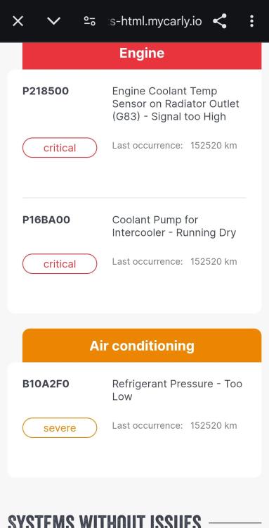

Hi guys/girls.  Any one got an answer/follow up to this? Ive tested all my auxiliary electric water pumps which are working fine. Putting a hose through the heater matrix reveals 0 flow, Nothing at all, like its completely blocked solid. Is there some sort of flow valve in the dash or some other form of skulduggery that  i'm not in the know with? I'm doubtful of the control panel idea helping due to the lack of flow through the matrix. Cant see how the two could be related....  Unless there is a cunning flow valve somewhere yet to be discovered?  2014 1.6tdi with 45k on the clock by the way, full audi history.  HELP! its cold 🥶

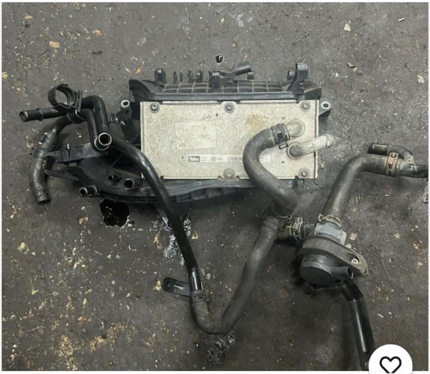

Hey, hopefully you have all solved this by now but having fixed mine in November - it was heater matrix being blocked by the sealant from the header. I replaced the heater matrix and all is well wit hthe world. yeah, A/C was becoming painful to clear the windscreen, lol.
I tested the old matrix afterwards and it was completely blocked - both with normal flow and pressure flow.
It's a bit tedious as a lot of the interior has to come out, but it works a treat and is a damn lot cheaper than getting the garage to do it!
