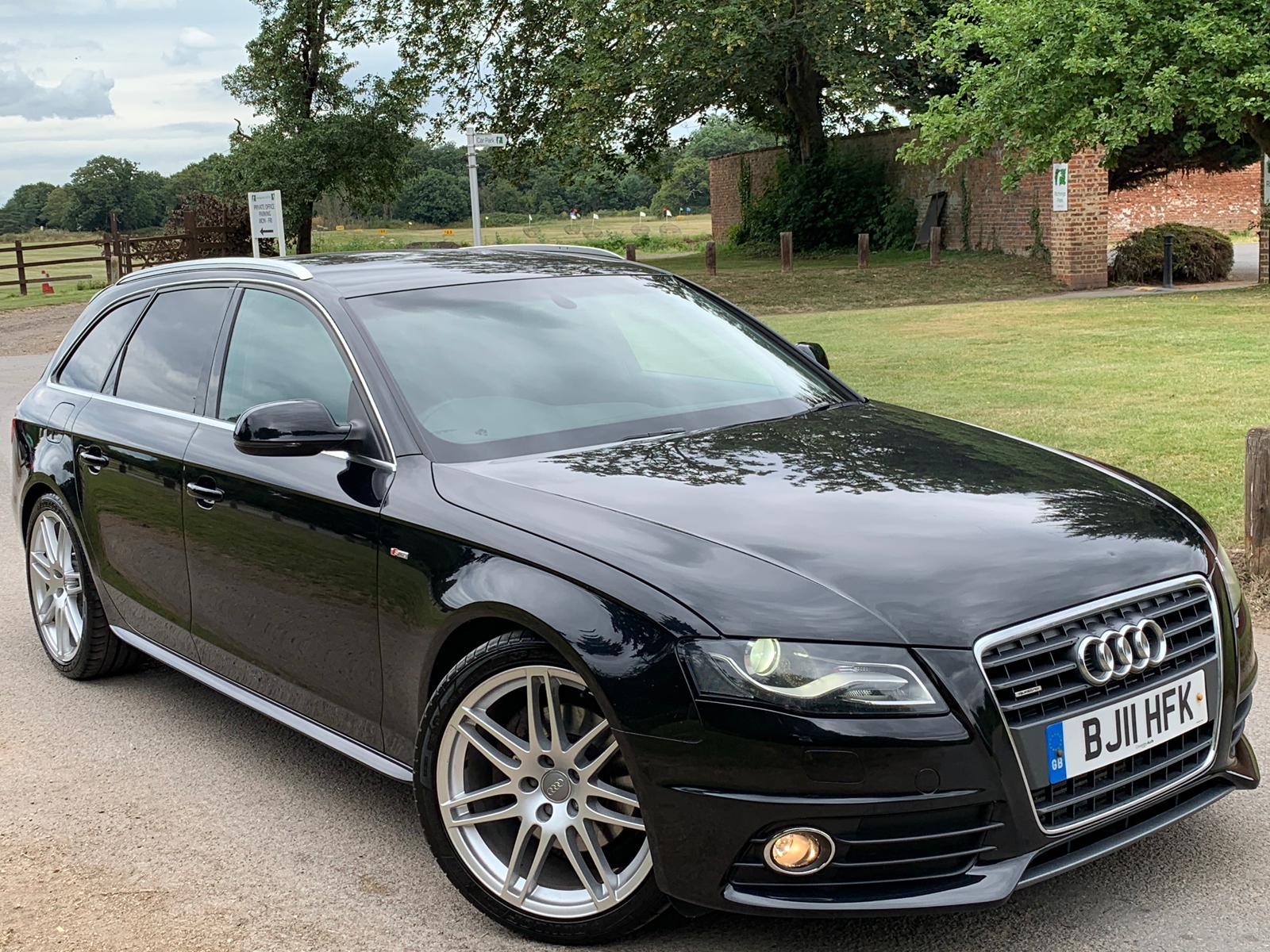

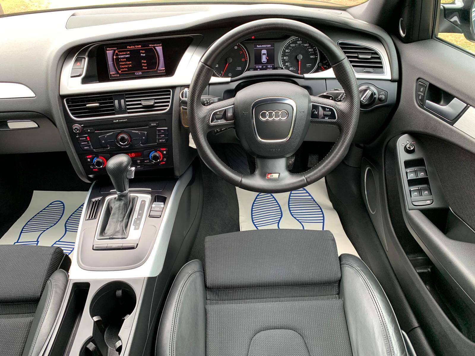

New to the forum so bear with me, please.
I got my genuine Ross-Tech vcds software copy + cable and did a bit of coding..
I was trying to enable my Battery Percentage and I did it but as soon as I did it I can't see anything apart from the Battery Percentage on the screen..so now I don't have the options available to control my DRL, WIPERS, SOUND, WINDOWS, ETC..i also noticed I've lost my steering wheel commands too..
I have no backup done or if j have the backup I don't know about it..
Can anyone help me to get my settings back or recommend me a place to go?
Vin WAUZZZ8K4BA048490
Thank you in advance, please.
go back into adaptions then car menu 1  when the options pop up enter the number of the first option 1 and the last 256 ie. 1256 test then save this will enable all options including battery do the same in car menu 2 to get the service option on hope this makes sense.
