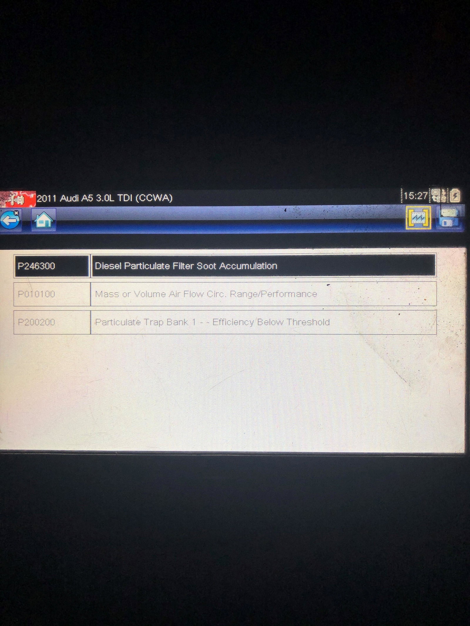

Driving home last night, the car went into limp mode with the orange coil symbol flashing on the dashboard. I took the car straight to have the codes read and this is what came back...
Apparently the DPF is heavily sooted up! Diesel specialist told me they can take the DPF off and thoroughly clean it for £720!!! Is that excessive or is that how much the process costs?
