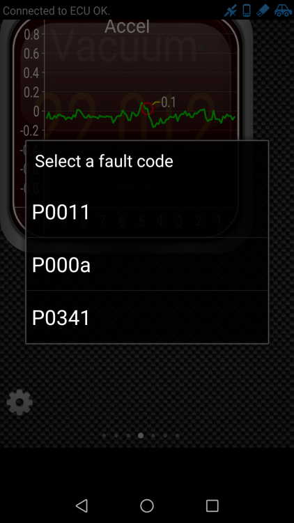

Vorlockfoss Posted March 21, 2020 Author Share Posted March 21, 2020 Hi, Small update: Thursday and Friday I had issues starting my engine, just as described above. Today I had no issues for the first 2 starts, i.e. cold & first warm start, but then starts thereafter were as before. Could this be fuel related, i.e. filter/pump/injectors/other? When I put the key in the ignition I don't hear the fuel systems 'priming'. Also, when I try to start as normal the ignition failure is almost immediate; it doesn't even try to fire. However, when I wait 3 or 4 seconds the ignition doesn't fail immediately, but does at least attempt to ignite. If I do this 2 or 3 times then ignition is successful. I am at a loss to be honest. I've had failure after failure after failure, where I fix 1 thing and another rears its ugly head. I'm starting to get fed up and I don't want my car any more, but I'm stuck with it as I have a conscience and can't just palm it on to another unsuspecting victim... Thanks, Paul. Quote Link to comment Share on other sites More sharing options...

Vorlockfoss Posted March 24, 2020 Author Share Posted March 24, 2020 Riiiight..... After an 8 mile round trip with my dog to the local Audi Dealership (we're allowed excercise once a day...!), I've changed the Camshaft Sensor for a new OEM one & for the first 7 or 8 starts all was brilliant, and I thought "yes, it's fixed, at last...!"; I was elated...! Anyway, rather than walking away and enjoying the moment, I then tried one more time, and the fault returned, as previously explained. However, there are 3 initial caveats to that; 1) the fault codes have not returned (yet) (see attached screenshot for codes before I cleared them), 2) the starting symptoms are similar or exactly the same, but, it does start perfectly normally after around 4 or 5 start attempts, 3) starting from cold 'appears' to be rectified & normal... I'm going to have another go tomorrow & I'll report back here... I want to either cry, set fire to my car or sell it... Thanks, Paul. Quote Link to comment Share on other sites More sharing options...
