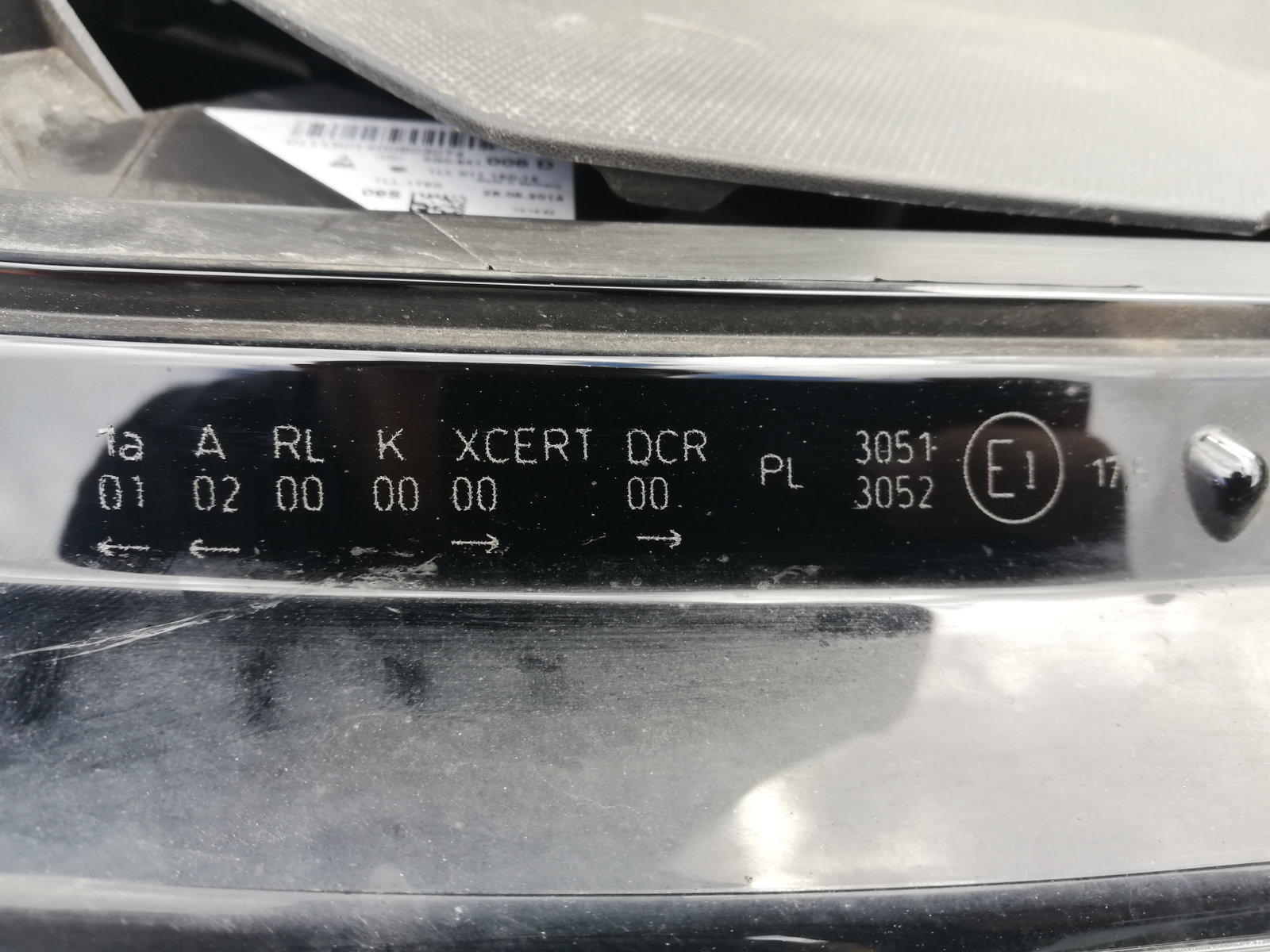

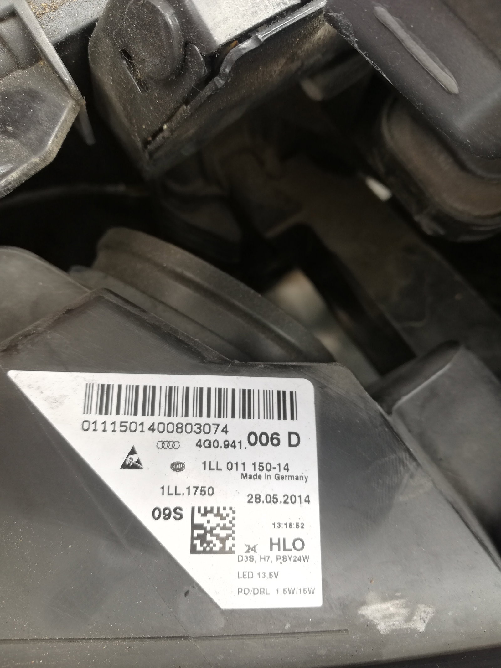

My drivers side headlight glass has broken - probably got some water in the unit too now - and now get message on dash saying dipped and high beam not working.  I was going to replace the whole unit but I've looked high and low and all these parts sites and none of the units seem to match the oen number or part number of the unit I have in there.  There are a few on eBay that match but they are nearly as much as Audi want for one plus all seem to have damage and tag missing.  I'll attach a photo of the info, if anyone can advise a replacement that would be much appreciated as Audi won't give me any help with part numbers and matching/suitable units.
