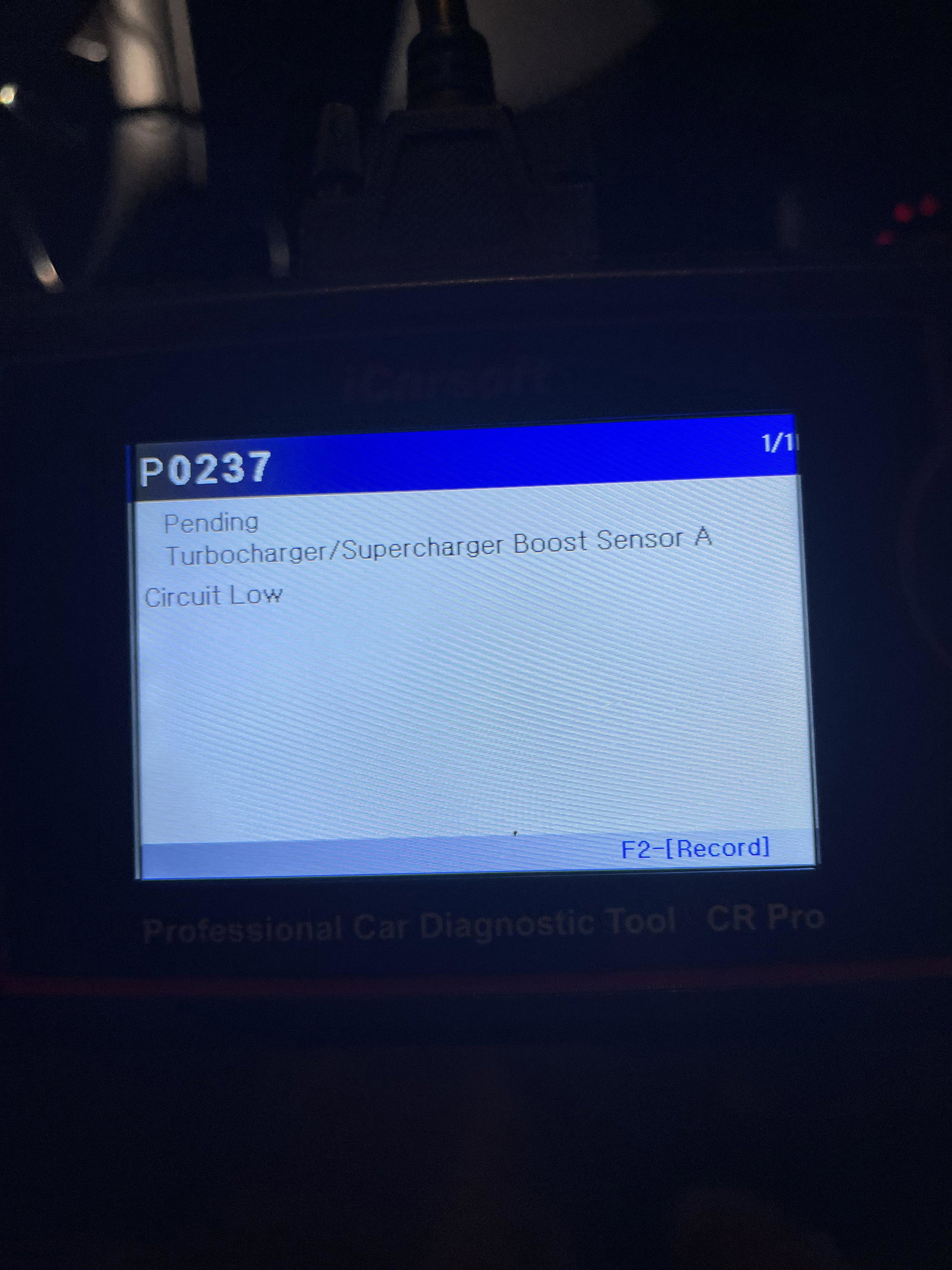

My A6 went into limp mode last night, diagnostic shows issue with turbo sensor. Can anybody tell me if this a huge fix or easy fix? Common causes? Price to fix etc? Please help. Thanks
Hi what engine does you car have if its the same as my 16 plate a CNHA unit the boost pressure sensor sits at the back of the engine on the right hand side just above the inlet manifold on its own little bracket and a pipe which runs down to the inlet manifold, its easy to change and is about £60, if you can post a picture of your engine bay without the plastic cover then I can confirm.
Appreciate the information mate, I’ll be able to show the engine bay in the morning. Hopefully you can let me know as soon as you can. Thanks
