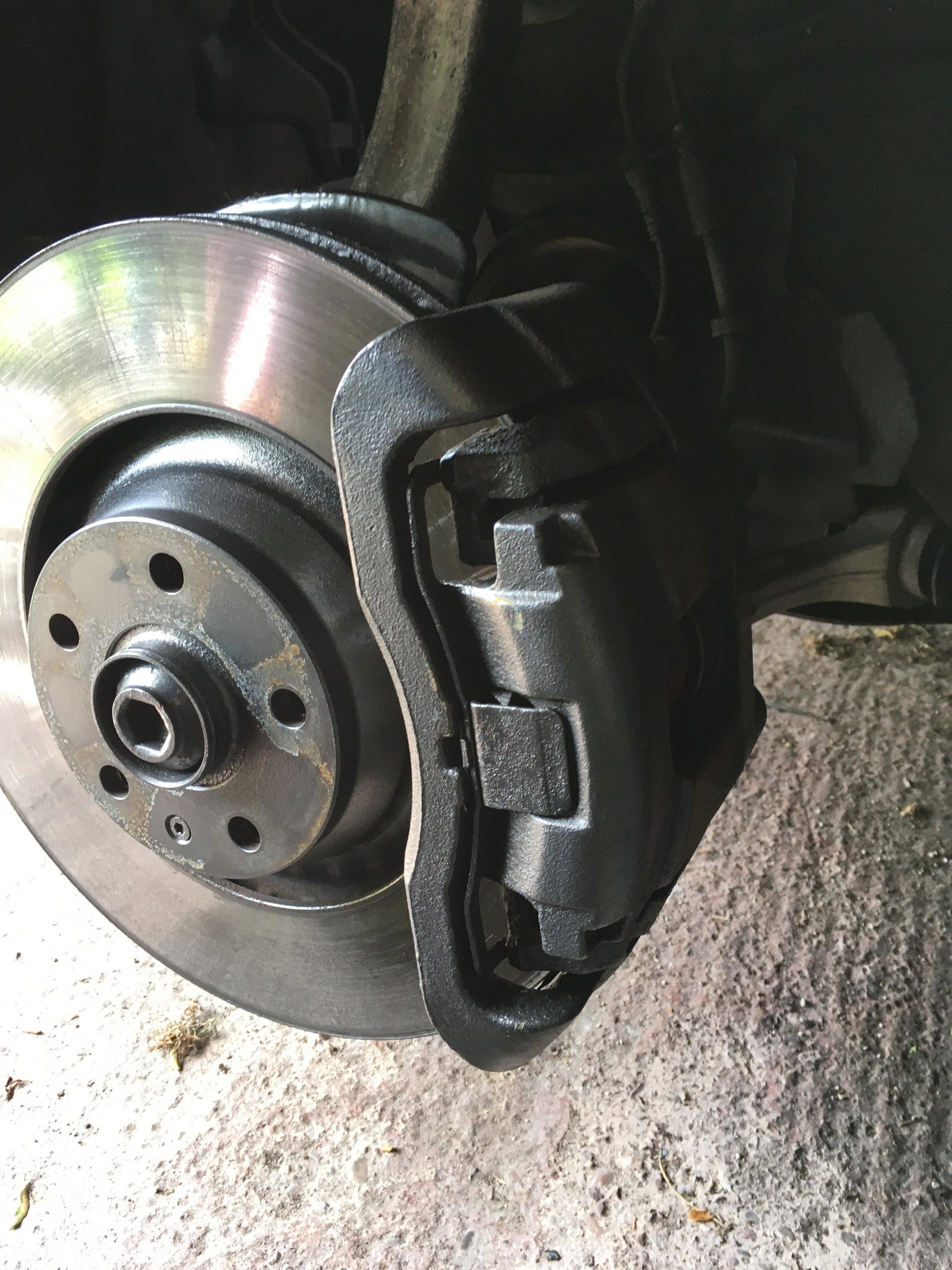

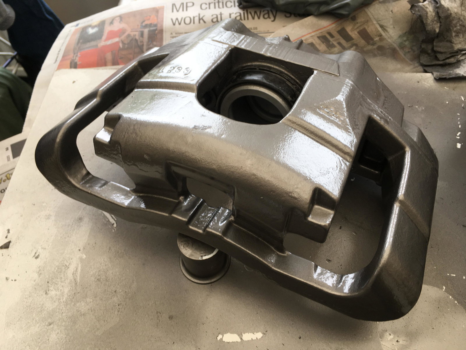

This is one of the new front calipers that I have painted.
16 minutes ago, RoyC said:
Nothing wrong with the calipers that are on there, I just want new calipers so that I can paint them. (the car has only done 42k)
So you are saying, OK to remove the new servos from the new calipers, paint the calipers then fit the old servos without unplugging them and screw them to the new calipers.
Hi if there is nothing wrong with the old callipers I would of given them a good going over with some 120 grit oxide paper then a good clean with rubbing alcohol before painting, and yes just use the existing servo units. Nice job with the painting.

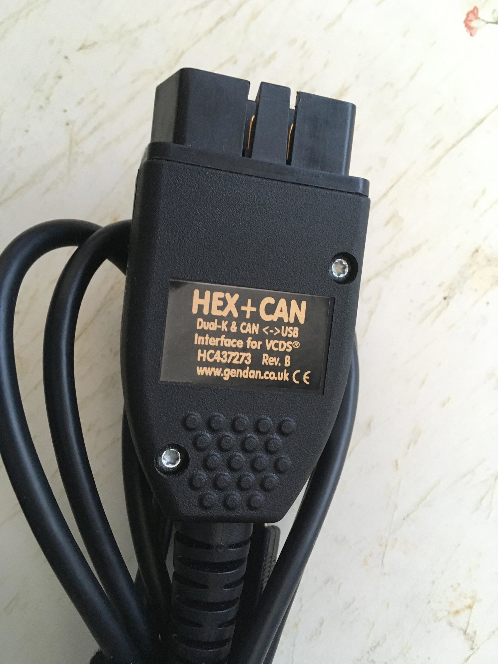

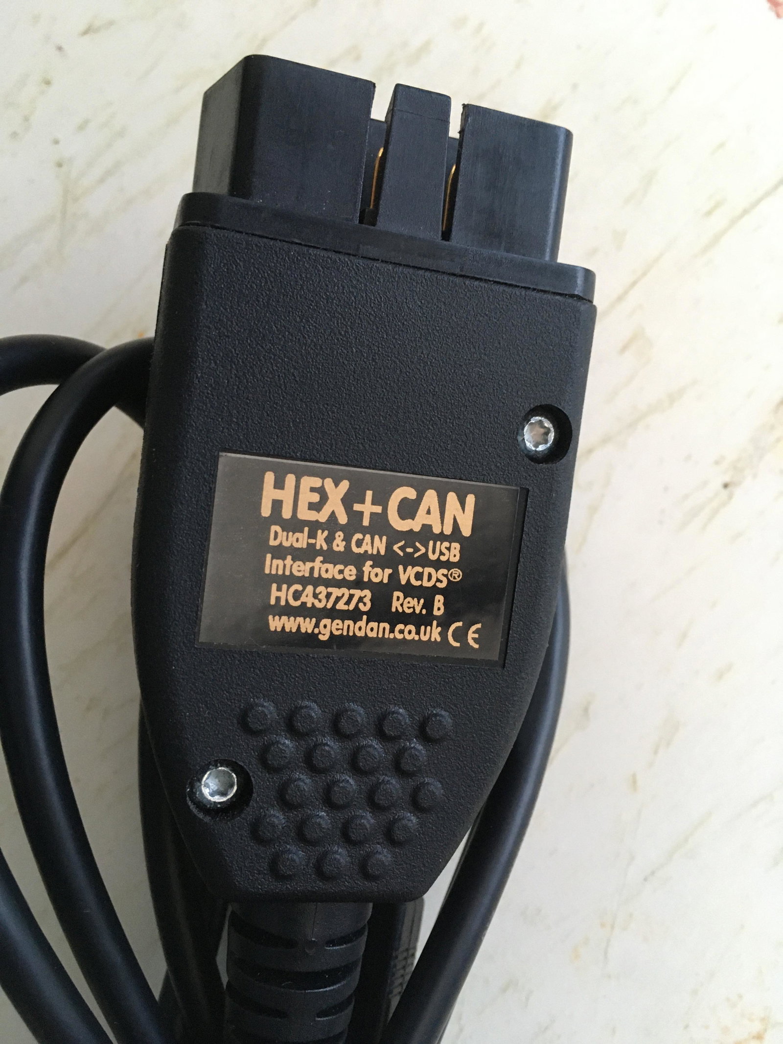

Yer, I think so as I can't get vcds to work on this useless windows 11 laptop.
Can any one recommend an alternative to this useless VCDS thing ?
Hi its not the VCDS cable or the program thats useless its windows eleven thats the problem as it thinks the VCDS program is a virus in simple terms so it blocks it, what you need is an old laptop like I have that is running windows seven and has NO anti virus software downloaded because it never gets connected to the internet regularly it won't need it.
Haha, Great minds and all that.
Sorted my old PC out with windows 8.1, wiped it clean and installed chrome and VCDS only.
Works ok now.
I think Win 11 is too unstable any way to risk programing with, it crashes too often.
