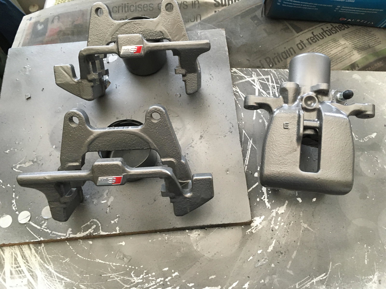

I'm in the process of painting some new rear calipers and discs.
When all done and fitted I will power bleed thw whole system and see where I go from there.
Hi I have power bled systems before after fitting a new ABS unit and rarely had a problem in all fairness you will be best served to use clear tube bleed pipe and have all four bleed nipples open and a gallon of brake fluid, should clear all bubbles after two and a half litres, nice paint again well done.
