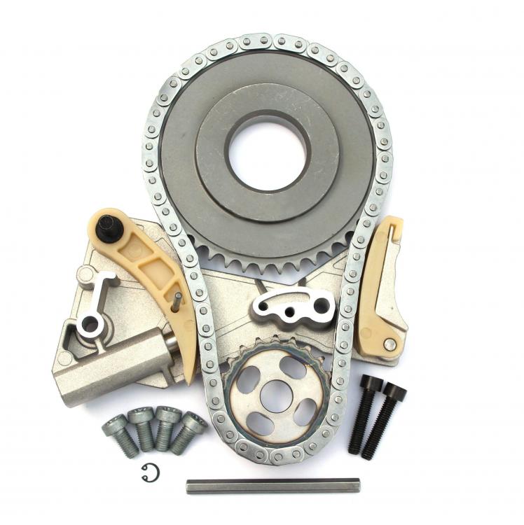

Hi are they going to change the drive chain and sprockets as well.
OMG - there’s MORE? 😱😆
OK, I’ve done some searching and found this kit.
I assume this is the parts you mean Steve? Is there much more disassembly needed to fit it, do you know? Is it something that’s prone to failure?🤔
Mike 😎
Just been having an interesting text exchange with my mate at Norwich Audi. He makes a good point - that I can get a replacement engine for £1000 or so - he questions doing any of it. I think I'm still going to have hex-drive done, but that's all...😎
Hi £1000 or so sounds like a bargain plus gaskets, plus fitting, plus anything else they think needs replacing, the engine will be bare for that money why not spend a little extra now to maintain the longevity of your existing engine the kit is right that you have sourced and will remove any future worries, I can't think of any of my friends in the trade that would try and steer me towards a potential money pit, furthermore if the drive is a major strip down why not do the whole lot while you are in there, the nylon guides wear and the chain will have stretched.
So, here's the strange thing. He hasn't had to order a hex drive in as long as he can remember. This chap has been a mate of mine for 30yrs and isn't spinning me a line.
He was tongue in cheek about the cost of a replacement engine (to make me look at it pragmatically). Replacing the hex drive will be an expensive job. I understand that one has to make a value judgement on these things - the hex drive certainly has a lot of anecdotal evidence of failures, but I'm not convinced that the extra work (especially) and outlay on the chain and sprocket set is worthwhile given my low mileage use and the age of the car...
Sell me on the idea, Steve 😃 - I'm minded at the moment to just get the hex drive done...
Thanks,
Mike 😎
Thanks,
Mike 😎
Hi it all depends on how long you intend to keep the car, whats the advantage in spending money if you intend to sell it in the not to distant future, none, but the whole point of what I was saying whilst in expensive process mode why not replace the whole kit which brings me to the point of why he has never ordered a drive before, thats because most people buy a kit and get it done at the local independent, my guy I use has done loads of them mostly on the V engined Audis the kit from them is nearly £1800 but the Febi repair kits are about £300, its entirely your choice but from my logic why spend all that money to do half the job.
