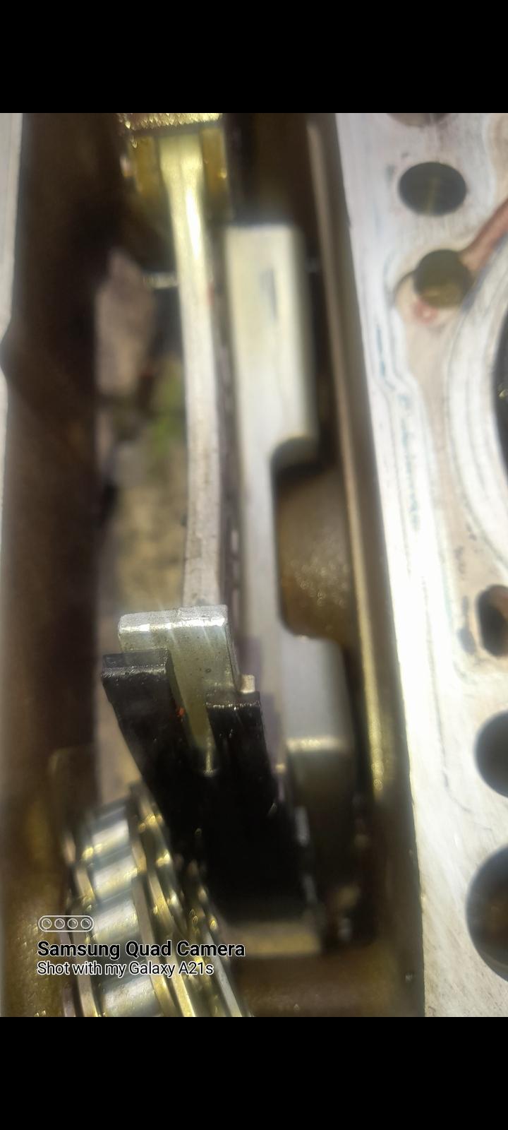

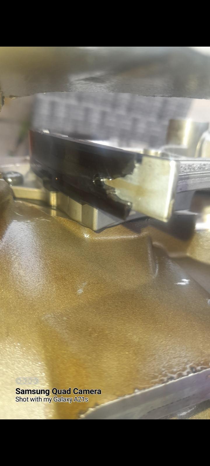

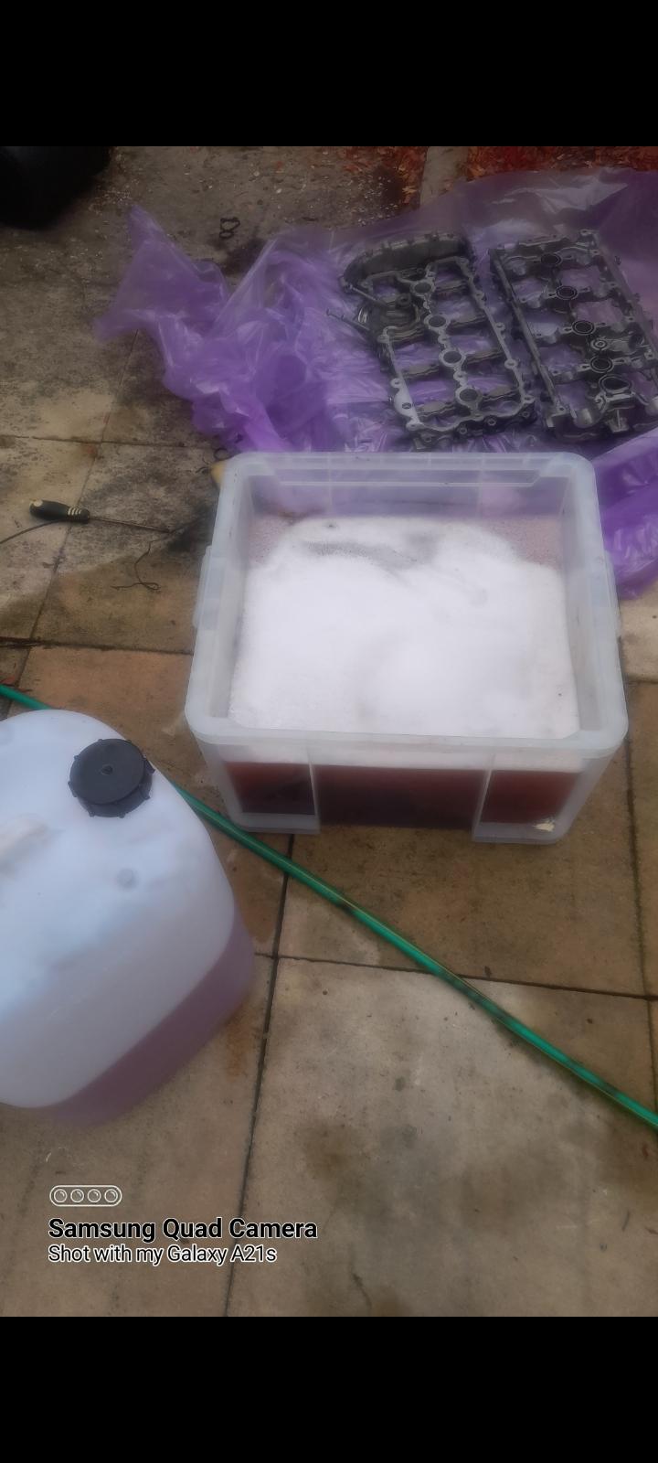

Engine out and broken down timing chain tensioner top left and top right got broken runner on the ends so need replacing rest are in very good condition had too order a new valve springs remover as mine to big to do the seals, mainly doing cleaning for now and leaving the cats and headers in a cleaner solution
