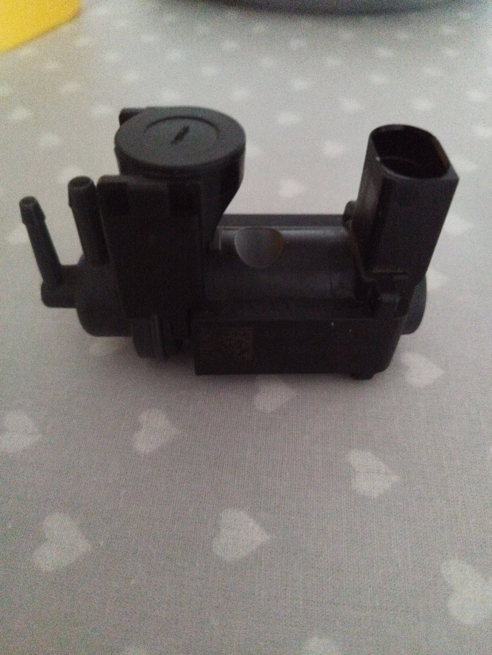

Hi all..new member here and unfortunately looking some advice on a problem..
I'm getting code p0299 ( only this code)so far I have checked the turbo actuator is moving freely and that it is holding vacum.so far all seems ok.i have checked the vacuum hoses and again all seem ok..but what I have noticed is after a short drive the n75/ vacuum control solenoid for the turbo actuator seems to get very hot..I assume this isn't normal and needs replaced..
Does anyone happen to know the resistance rating for this part so I can maybe try and test it both cold and after a short drive..I have attached picture of what I assume is faulty
