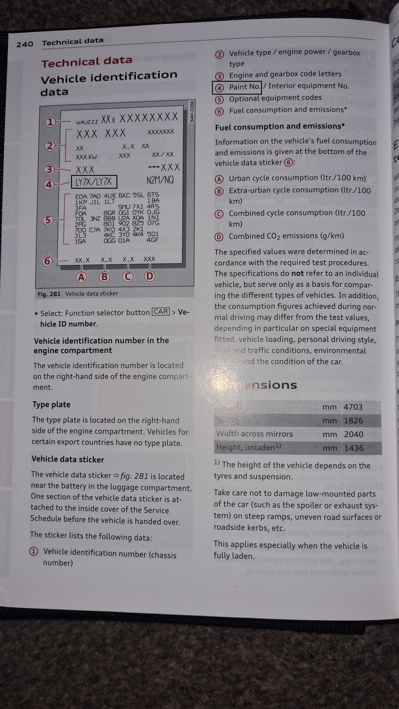

Hi, I am trying to find the paint code for my Daughter's 2009 Audi A4 Avant.
I fully expected to find the white label on the inside of the spare wheel well but hers is fully carpeted and no sign of any label.
I have checked under the bonnet and on the inside of the door jams and still nothing obvious.
Any ideas please? Thanks
Thanks for that. I've had another look and eased the carpet back on the left hand side of the wheel well. Code is there LY7G.   👍😊
