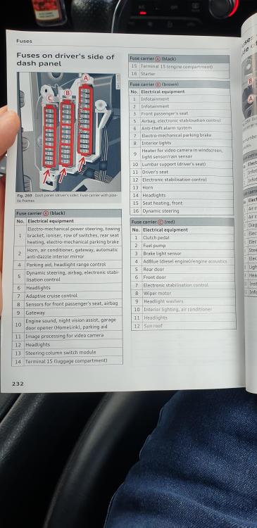

Hi All.. jumped in the car this morning, and neither front or rear screen washers are spraying water. No noise either. So assume its the fuse or pump, and I'd rather start with the fuse! Can anyone tell me the fuse number & location, please?
Thanks Gareth... had a look but can't see it in there, unless called something other than screen washer ?
Possibly together with the wiper motor Chris, but not sure I’m afraid.

It was the pump in the end, luckily not an expensive job! Mechanic agreed most likely on same fuse as wipers. Thanks for your help!
