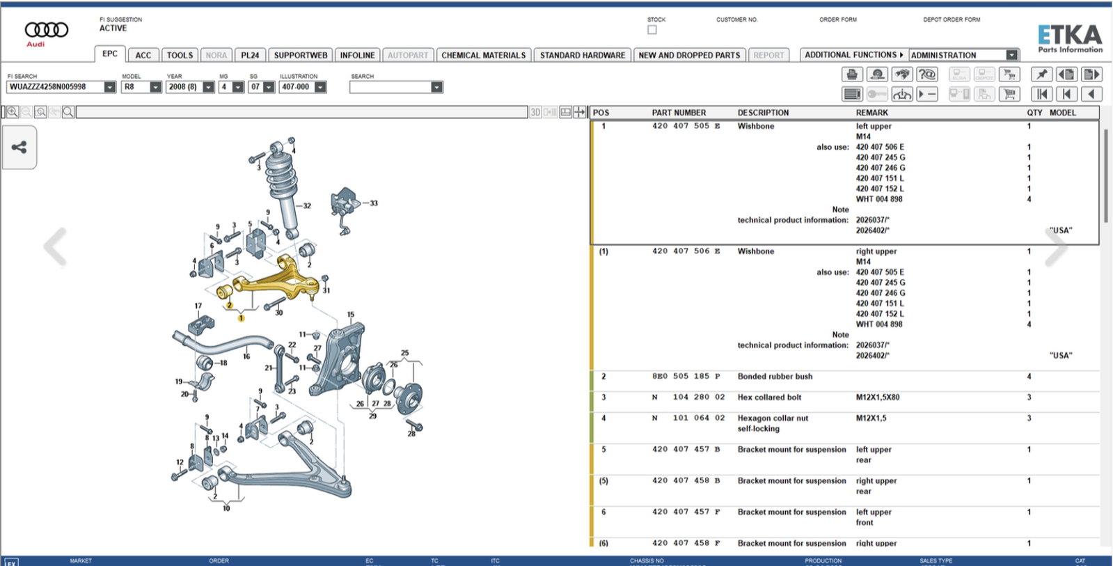

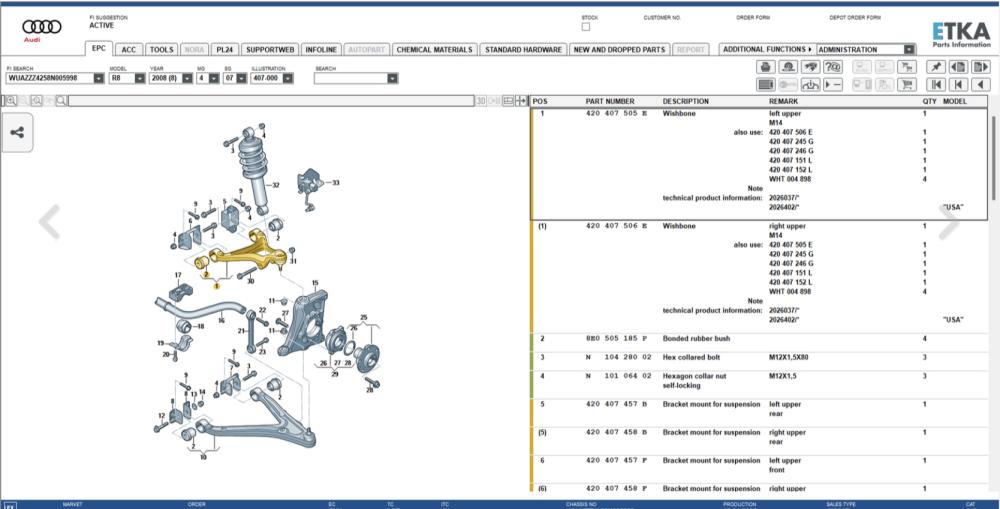

I have downloaded an “exploded” picture of the part(s) in question which is 420 407 506 E Wishbone Right Upper M14 which I can source via an on-line organisation who seem to have a good reputation.

If the ball joint isn’t available as a separate part, then replacing the complete upper wishbone on the offending o/s is the way forward.
Need to replace both ‘for safety reasons’ ? Don’t agree that this would be necessary.
Not sure who your on-line respected supplier is, or more importantly what aftermarket brand you have been looking at, but I have used Febi for such components, and have used Car Parts in Motion as a competitively priced supplier. Lemforder would be an alternative, and likely more expensive brand, and may have been the OE supplier to VAG for such components.
Summary:- buy and get fitted (at a trusted local garage) the off side upper wishbone.
