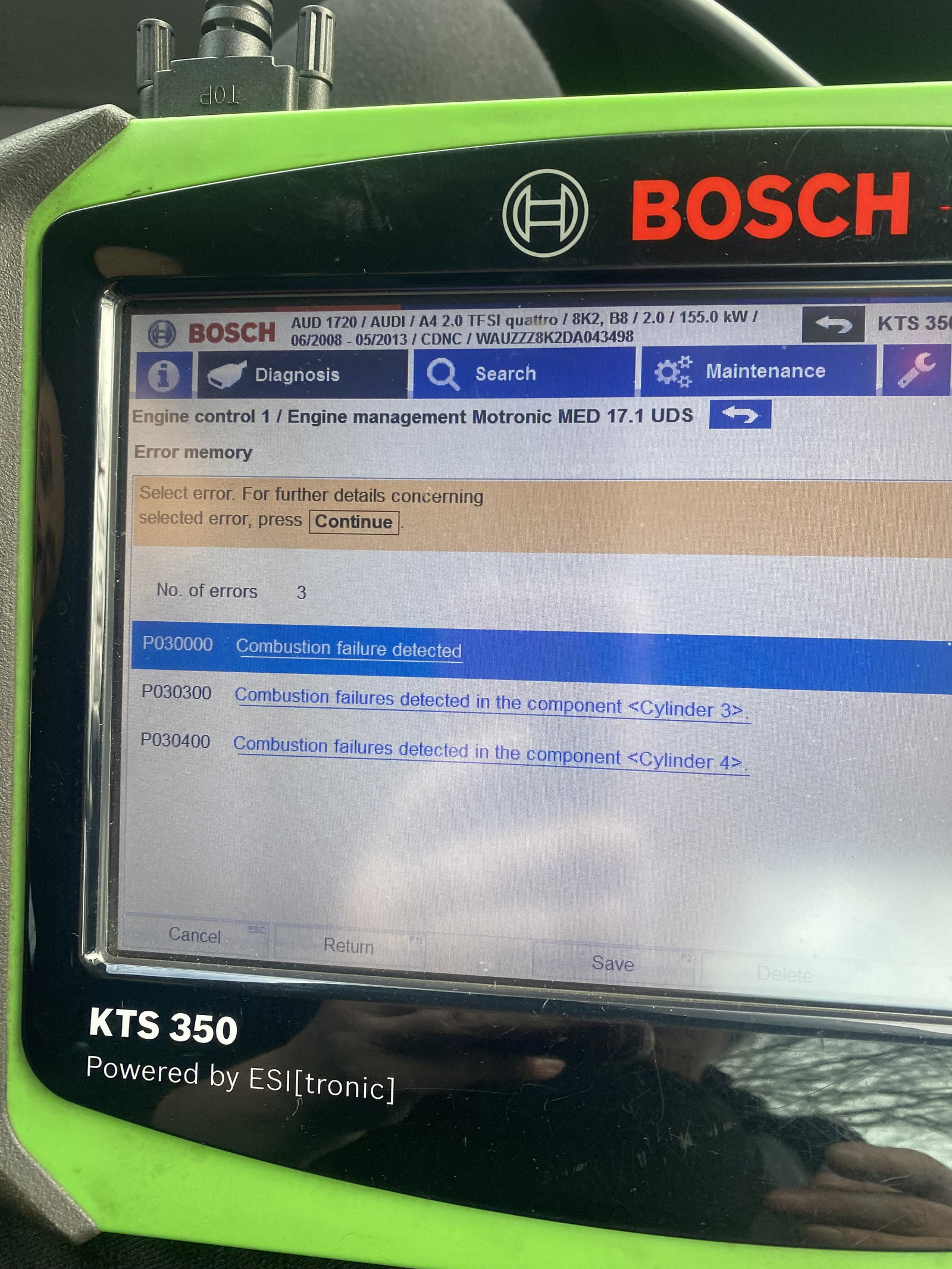

Hi. So diagnostic report has been done. Waiting for price for parts and labour and basically the exact cause but this is what has been flagged up  I’ll update when I know moreIMG_0917.thumb.png.06b9c797cf5599a81ba6659299c1d899.png
