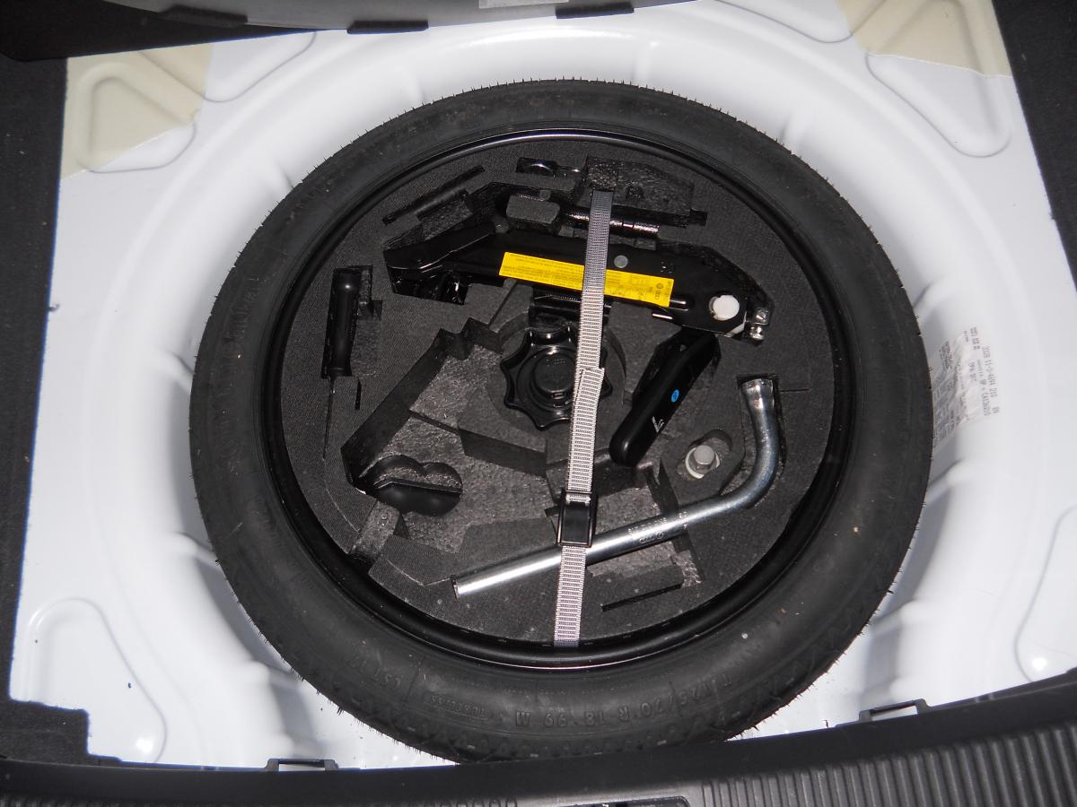

From research to get rid of that awful spare wheel pump and bottle of sludge, I have just purchased a Golf MK5 space saver wheel and tool foam block for my 2012 A3 sport Sportback 2.0TDI off e-bay. It fits a treat, and the tools fit the foam. If anyone's interested, the wheel I bought is VW pt.No. 1KO 601027B with T125/70R18 tyre. Other marking stamped on the wheel are 1010 829 FE8 3-1/2J ET255. post-573-0-22373800-1349291254_thumb.jpg

On 03/10/2012 at 8:08 PM, dorset steve said:
From research to get rid of that awful spare wheel pump and bottle of sludge, I have just purchased a Golf MK5 space saver wheel and tool foam block for my 2012 A3 sport Sportback 2.0TDI off e-bay. It fits a treat, and the tools fit the foam. If anyone's interested, the wheel I bought is VW pt.No. 1KO 601027B with T125/70R18 tyre. Other marking stamped on the wheel are 1010 829 FE8 3-1/2J ET255. DSCN1078.JPG
That's a great help thanks as I am looking for exactly the same thing for the same vehicle.
One query: Does the 18" wheel fit in the boot recess O.K.?
As there seems to be a 16" alternative version of the wheel. Thanks again, Dave
