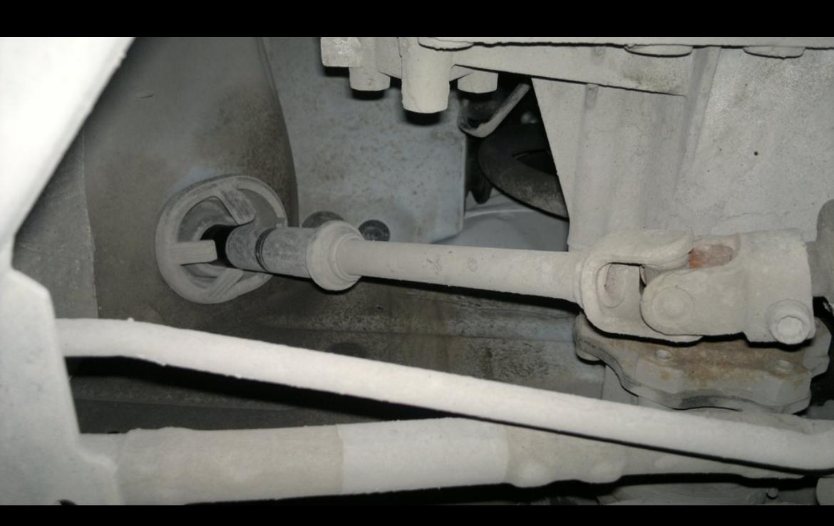

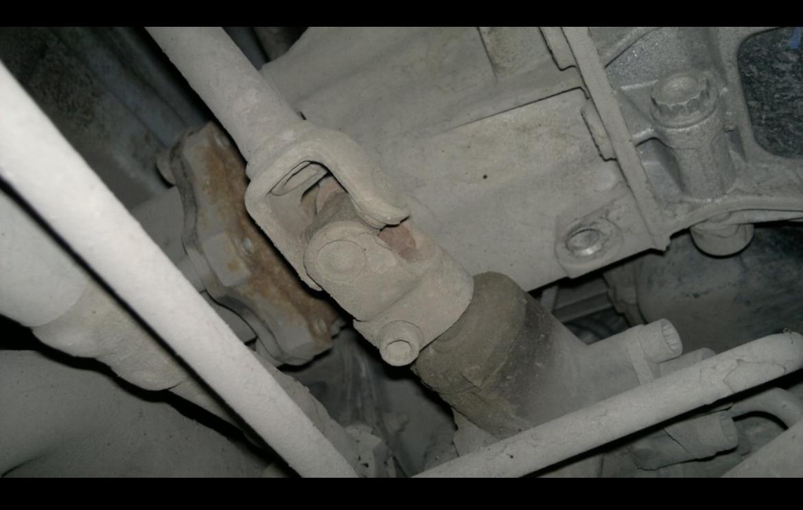

Electrical hydrolic systems like yours should place less strain on the electrical system then a electrical mechanical system, if you’ve replaced the solinoid and everything else checks out have a look and libe the following linkage as a known problem on some Audis
I did look at it and it’s fine (even put some greese on it ) but no difference
