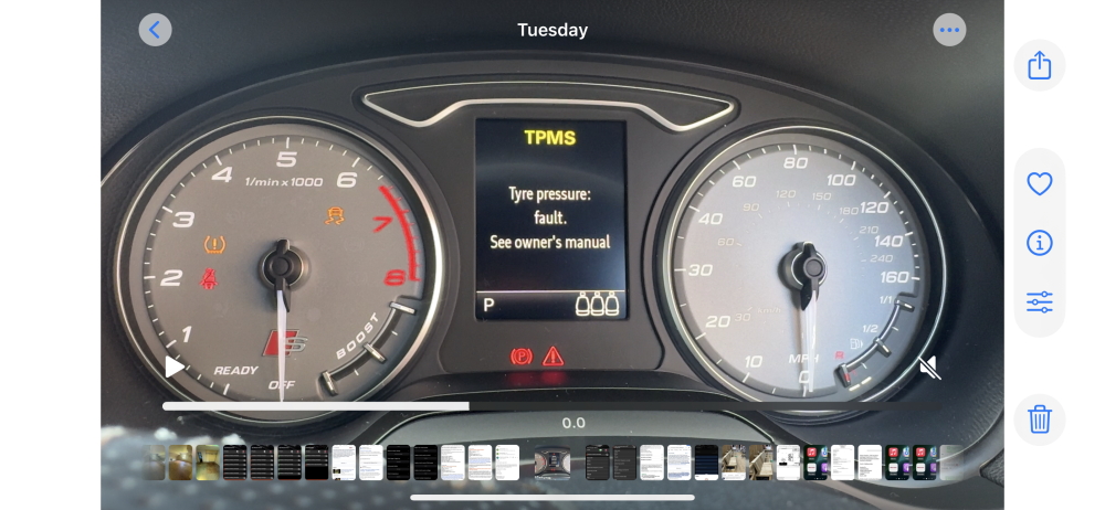

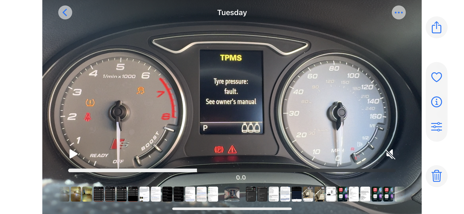

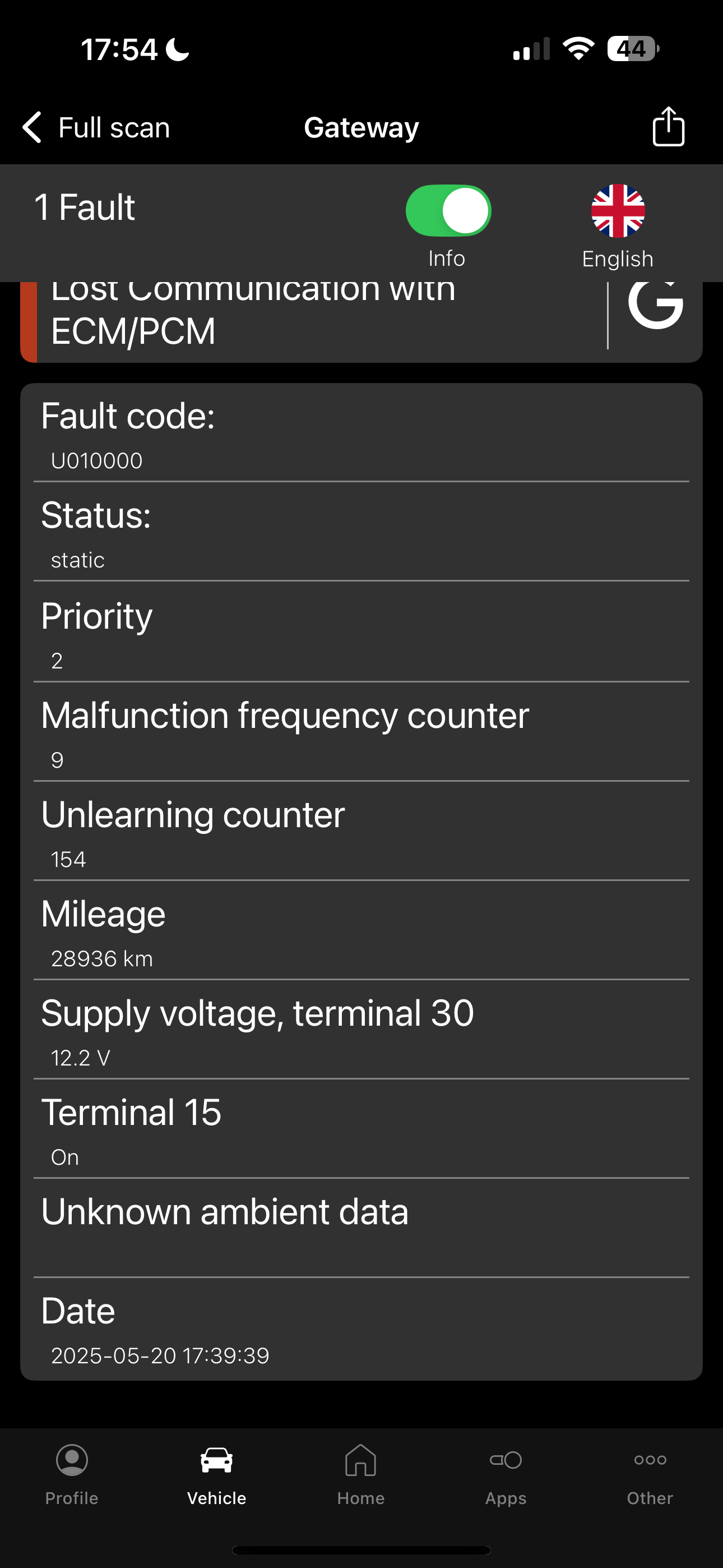

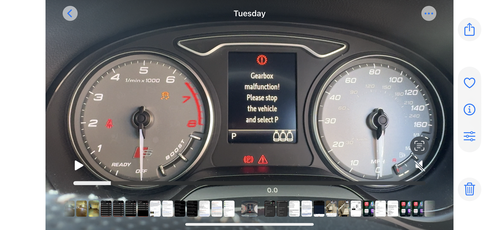

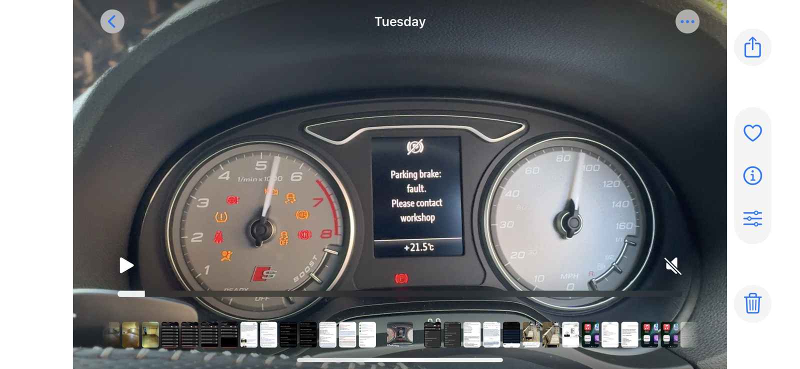

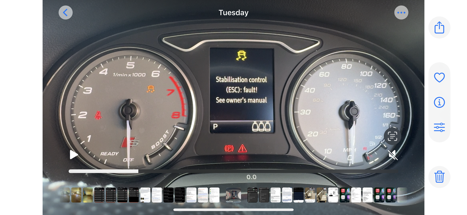

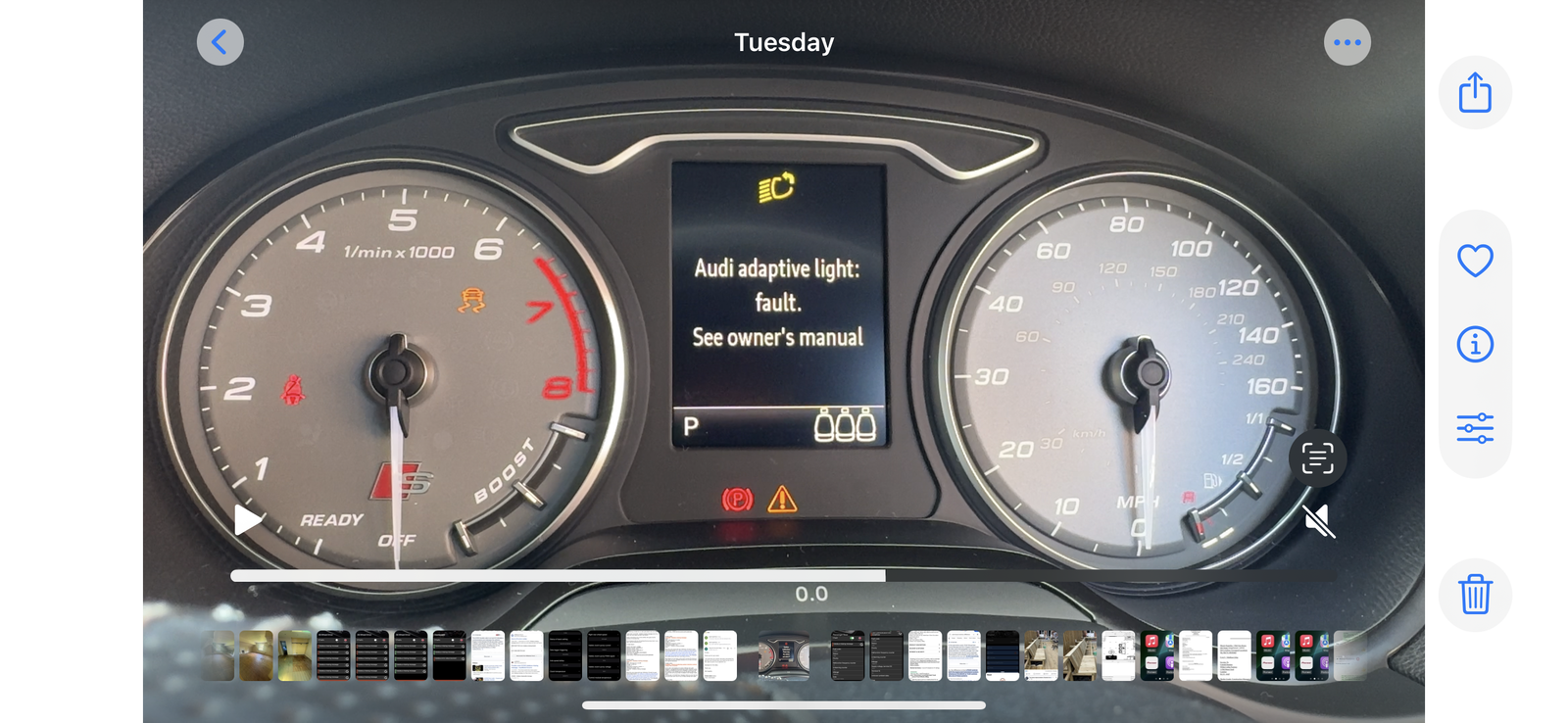

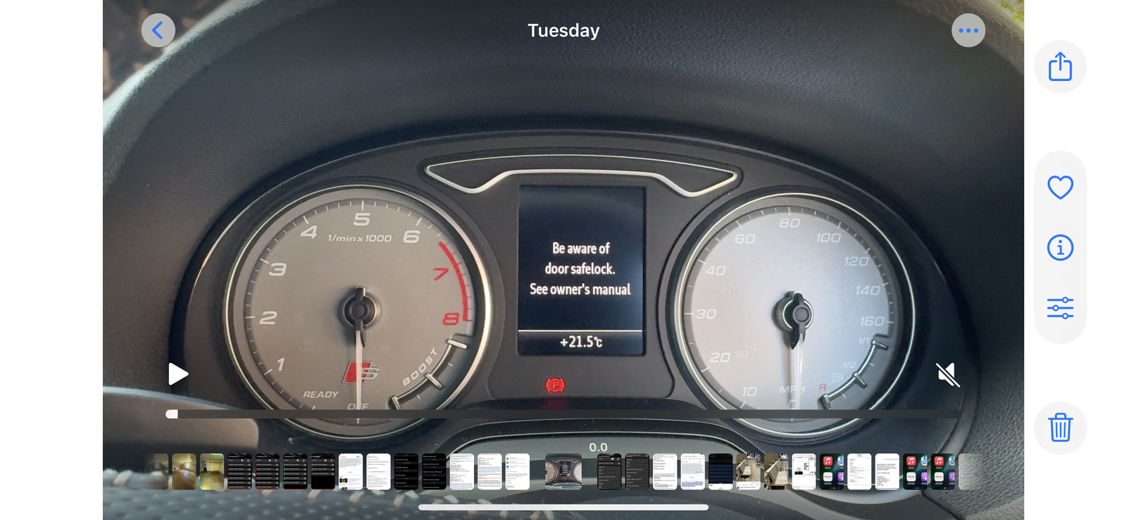

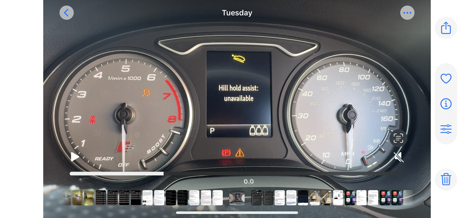

The car randomly cuts out while driving. And brings up numerous dash cluster messages. I’ll attach pictures to show these. The car will let u start it sometimes, after cutting out. And sometimes will let you carry on your journey faultless. Sometimes it will turn off a few times. Loose power and power steering control. Sometimes the car won’t let u take it out of, Park Mode. Pop up radio randomly goes up and down with out touching a button. Scanned the car myself, and it was giving me the below codes.
C111204 / Haldex clutch pump defective / I’ve replaced this with a new pump and oil and primed. Just in case this might have been the issue.
I’ve had the, ECU sent off for tests, and came back with no reported faults.

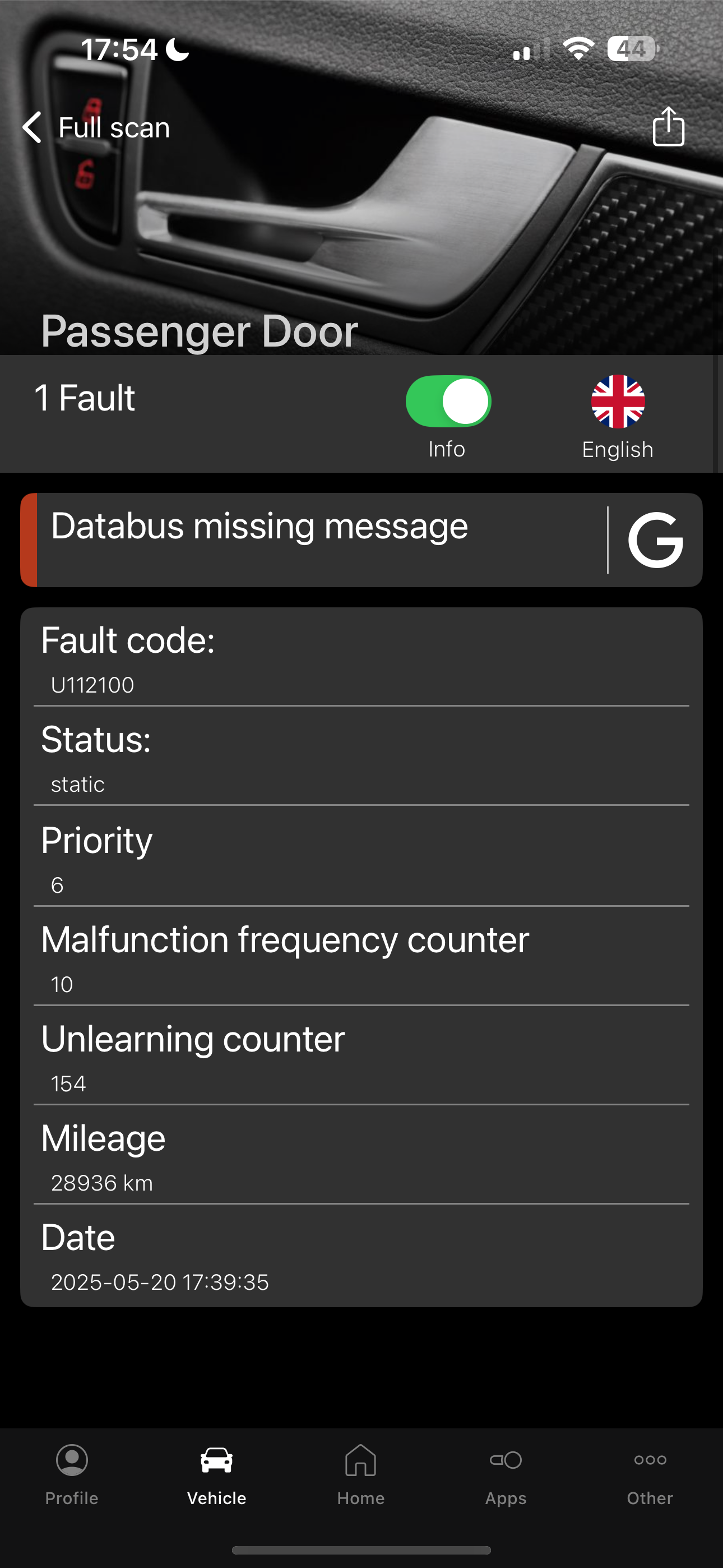

U112100 / Can signal Terminal 15 / No messages / Data Bus Know messages.
U112300 / Data Bus Signal Reception
