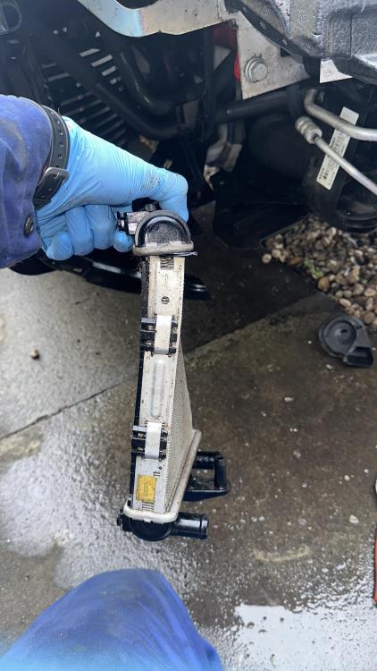

EtthanC Posted May 26 Posted May 26 (edited) Hi there, I have a 2019 Audi s3 and recently hit a deer on the road which punctured my driver side auxiliary radiator which made a coolant leak, around 30 seconds to a minute later my coolant light came on and I got out and seen it was leaking. Luckily I had coolant in the car and topped it right up and kept driving again until it came on, when it came on I topped up with water and drove it around a mile to my house without the light coming back on. I looked at the oil temp and coolant temp on the dash which were both still at operating temp. I then switched off the car. These parts are now getting replaced. After researching I see that the driver side auxiliary radiator helps cool the dsg, and am looking for some opinions on if anyone thinks there may be more damage to the engine/gearbox. many thanks, ethan Edited May 26 by EtthanC
cliffcoggin Posted May 26 Posted May 26 Ethan. Your frequent refilling and short journey make me confidant there has been no damage. No guarantees of course, but I would not be concerned if it was my car. 1 1
