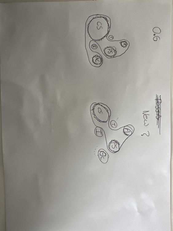

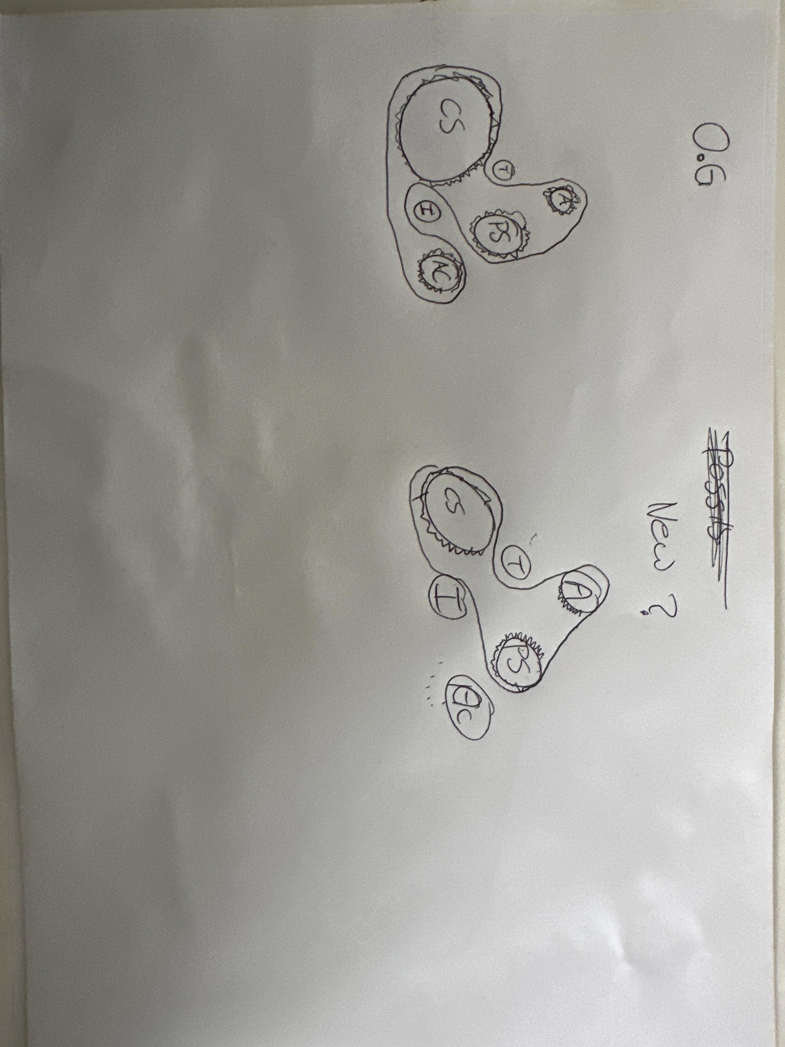

sotheron Posted July 26, 2017 Share Posted July 26, 2017 On 20/11/2016 at 0:17 PM, grahamjf said: Went down the short belt route.So now the belt only goes round the crankshaft pulley, powersteering and the alternator.No more rattles from the Ac Gates 6pk1123 micro v belt.Hope this helps some one else out if they need to bypass there Ac compressor till there pulleys fixed Sorry to resurrect and old post, I have signed up to thank the above poster for the information. I have bypassed my aircon unit today until I get around to fixing it. I couldn't get a Gates V belt same day so with some research I worked out the size and bought a belt from Euro Car Parts. Their Make & Model was ContiTech Drive Belt - 202772125. However all you actually need is a belt suited for a Audi 1.6 - 2006 - without aircon which is the correct size. Quote Link to comment Share on other sites More sharing options...
