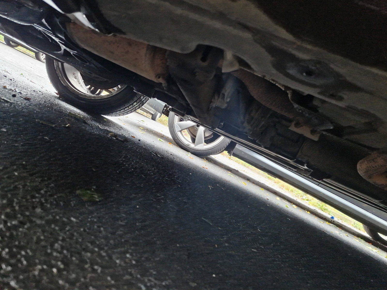

Just happened to me today moved car off drive to put on different car was only running few minutes
Smells bit oily
