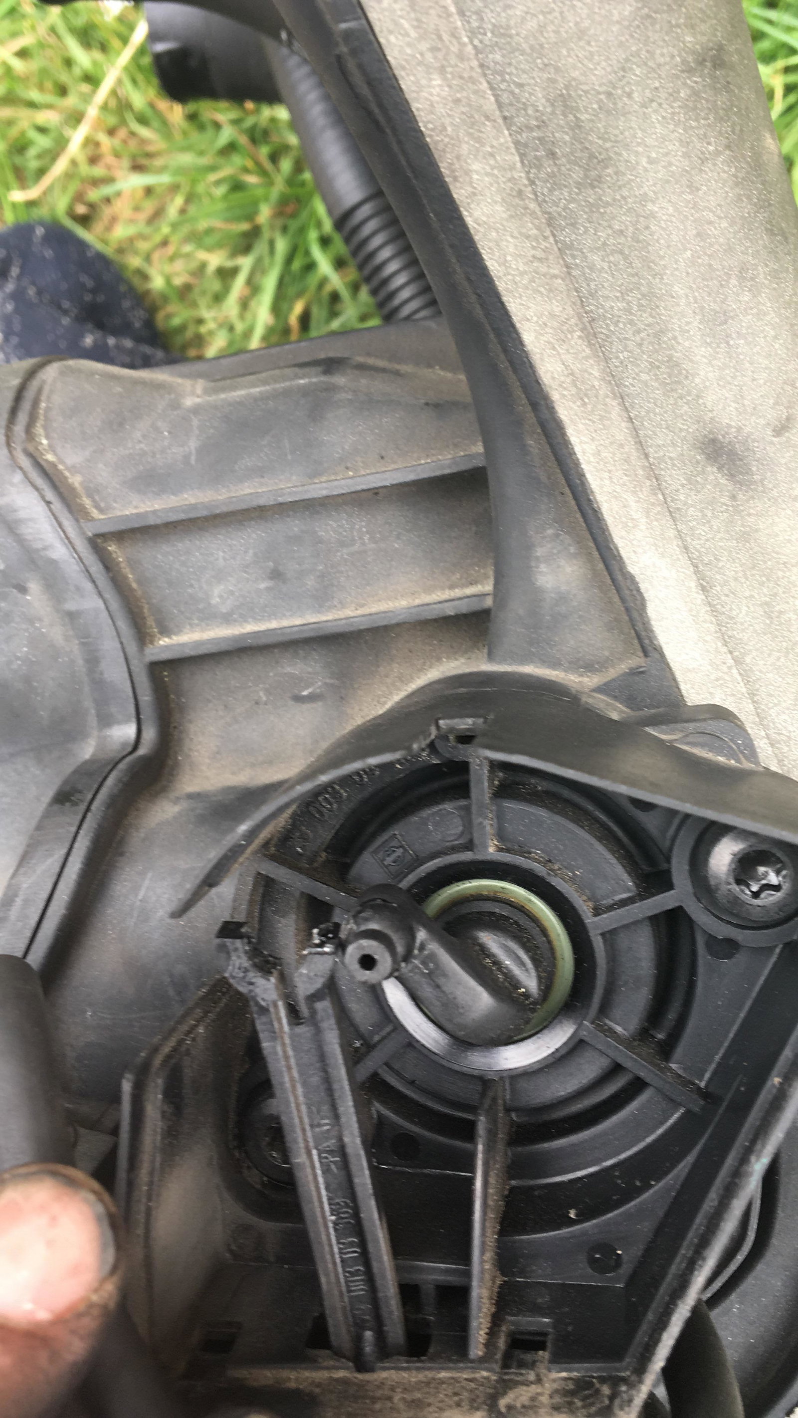

Shanewales83 Posted April 17, 2017 Author Share Posted April 17, 2017 Compression was fine on all cylinders, so I started to take inlet manifold of to swap injectors around, but found there was a rattle from inside the inlet manifold, and found this was broken ( see pic) hopefully gonna bodge it tommorow at work and if it sorts it out il order a new one. Didn't swap injectors as I thought this may be the problem Quote Link to comment Share on other sites More sharing options...
Trevor Posted April 18, 2017 Share Posted April 18, 2017 Worth seeing if there is a mod to bypass the accoustic valves altogether Quote Link to comment Share on other sites More sharing options...
