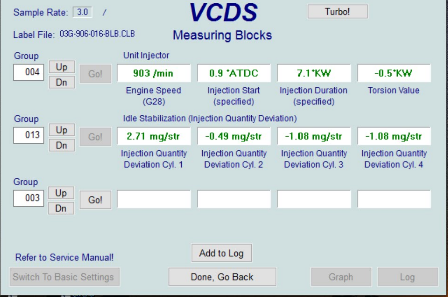

Hi Darren, I was under the impression that it was not possible to change the timing in VCDS - because it is a PD car - there is a Torsion Value measurement ( see below) which will give an indication if it is out - I believe there is a small amount of adjustment on the pulley which can bring this value back into tolerance- however, not had chance to see this yet so I am prepared to be shot down in flames!!
The Torsion Value of -0.5KW is within tolerance so it seems the timing is ok.

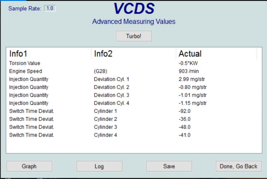

However, Injection Quantity is all over the place, cylinder 1 hit 2.99 mg/str at one point -

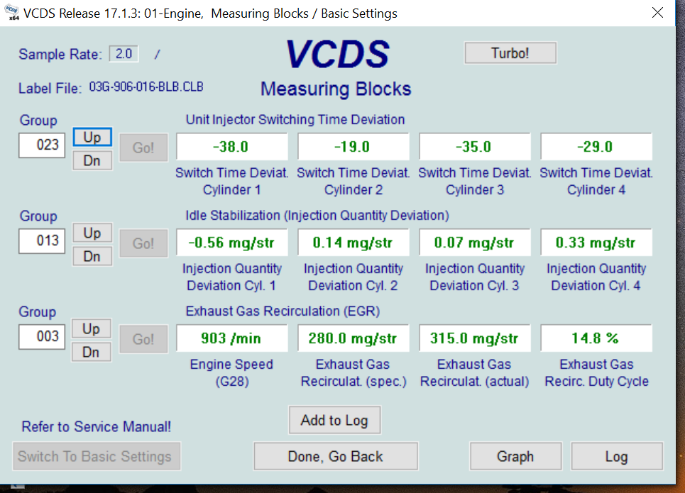

I checked EGR measurements, again they seem to be all over the place.

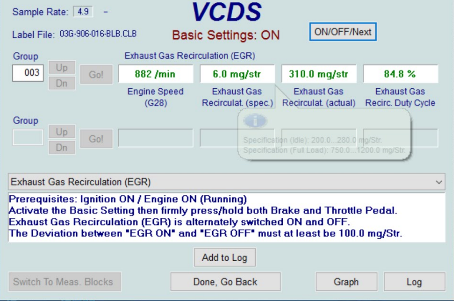

You can just see (before it faded away) what the specification should be at idle - its miles off. Possibly have a clogged EGR??
This screen shot shows how excessively out it is.
Finally did some Advanced measuring on the cylinders, you can clearly see cylinder 1 is wrong.

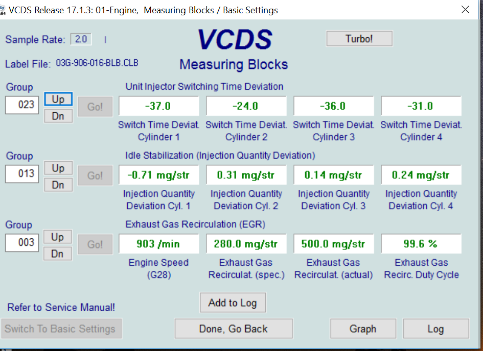

So just an update to this topic - changed injector #1 cleaned out the messed up EGR and the car now idles really smooth - my only issue now is that when I start the car It sounds a little noisy, but relatively smooth - readings shown below:start.PNG.5cdaf1dc148dba8a9408895c411fd166.PNG
Take a look at group 3 - especially block#4.........

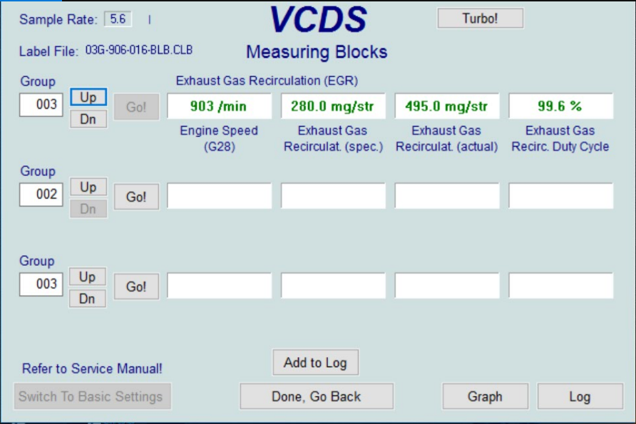

After about 4 minutes there is a noticeable change in engine note - and this is what I get :
For some reason the EGR duty cycle goes through the roof - as does block 2 & 3 - the car is still at idle @903 rpm - if I blip the throttle then the readings go back to around the same as on start up....after 4 mins it reverts back to the same as above.
Any ideas ?
