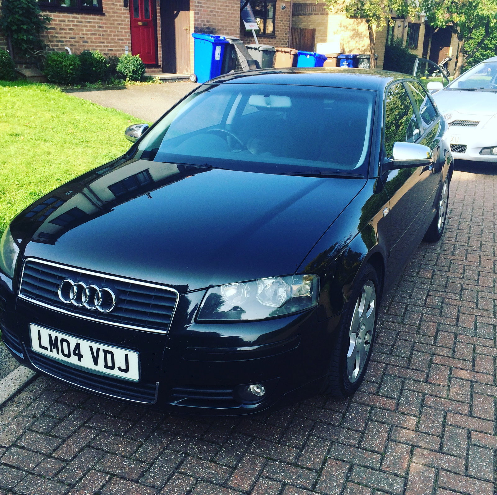

very clean looking motor :o
Not quite this clean now mind!!! Gotta say so impressed with it, the previous owner had done some nice little mods too (S3 Mirrors, all round tinted windows, Zenon headlights which are awesome) I've added an armrest (sadly not an official Audi one as they are rather pricey!) Feel like i robbed the guy to be honest, so much car and quality for the money and 47mpg! Bargain!
