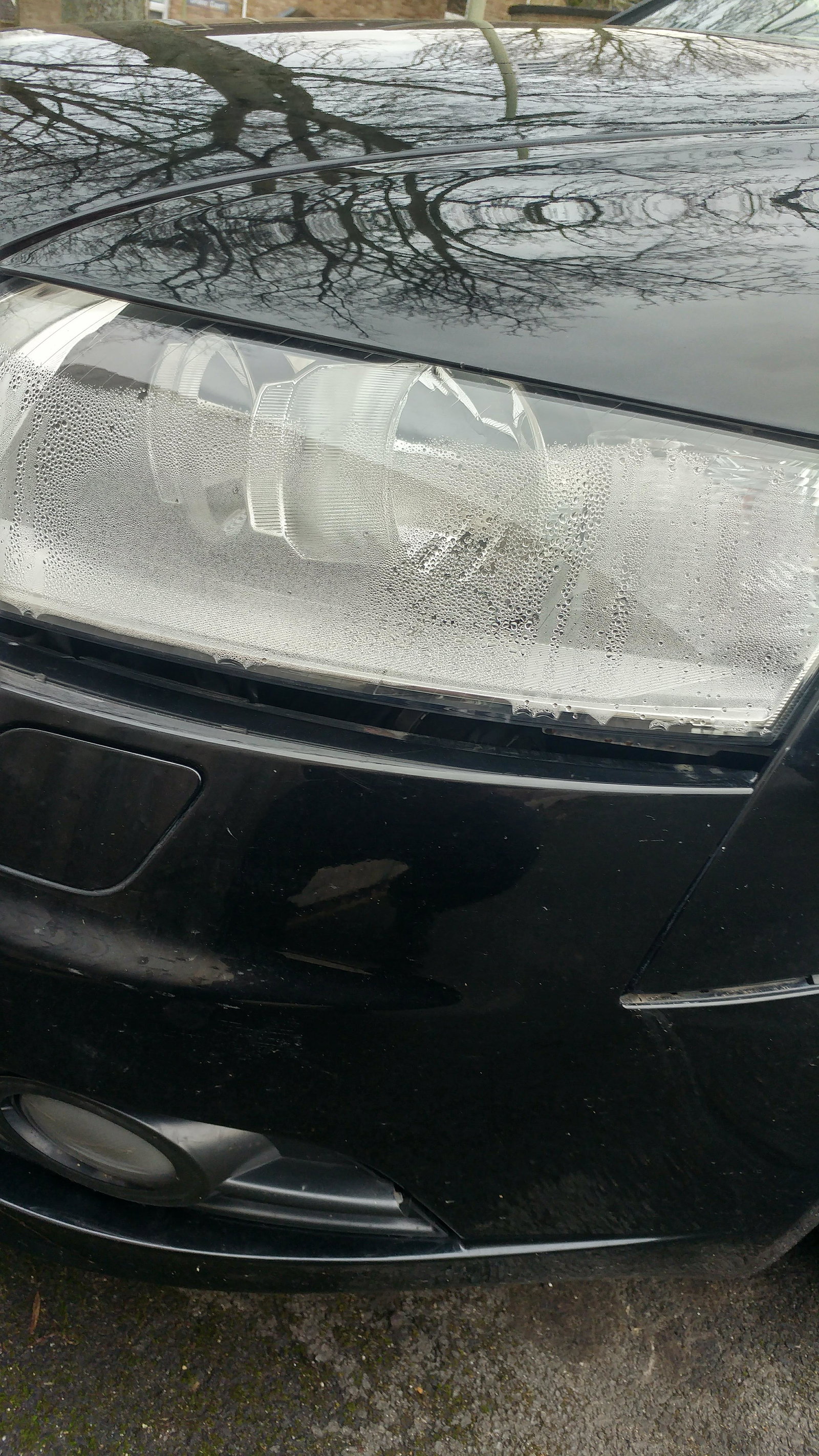

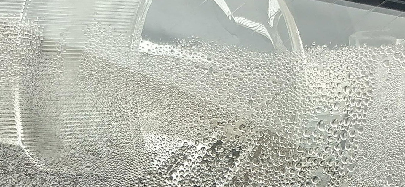

Should this be something to be concerned about, passenger side headlight with misting inside the unit, drivers side is fine
Screenshot-2018-1-29 20180129_104506_HDR jpg 1343329c2c370e7ae2f871aac7a56bcf jpg (JPEG Image, 2988 × 5312 pixels).jpg
Yes .over time this will cause rust
Tipical a6 c6 issue. Check the cap on the heqdlight if its in place and corectly installed. Sometimes on of the clips breaks ... also there is a rubber seal around the cap
Some ppl repotred that drilling 2-3 small hols on the bottom of the headlight helps with air circulation
is this going to be a bumper off job?
Caps no. They are under the bonnet
ok cool i`ll take a look, cheers m8
