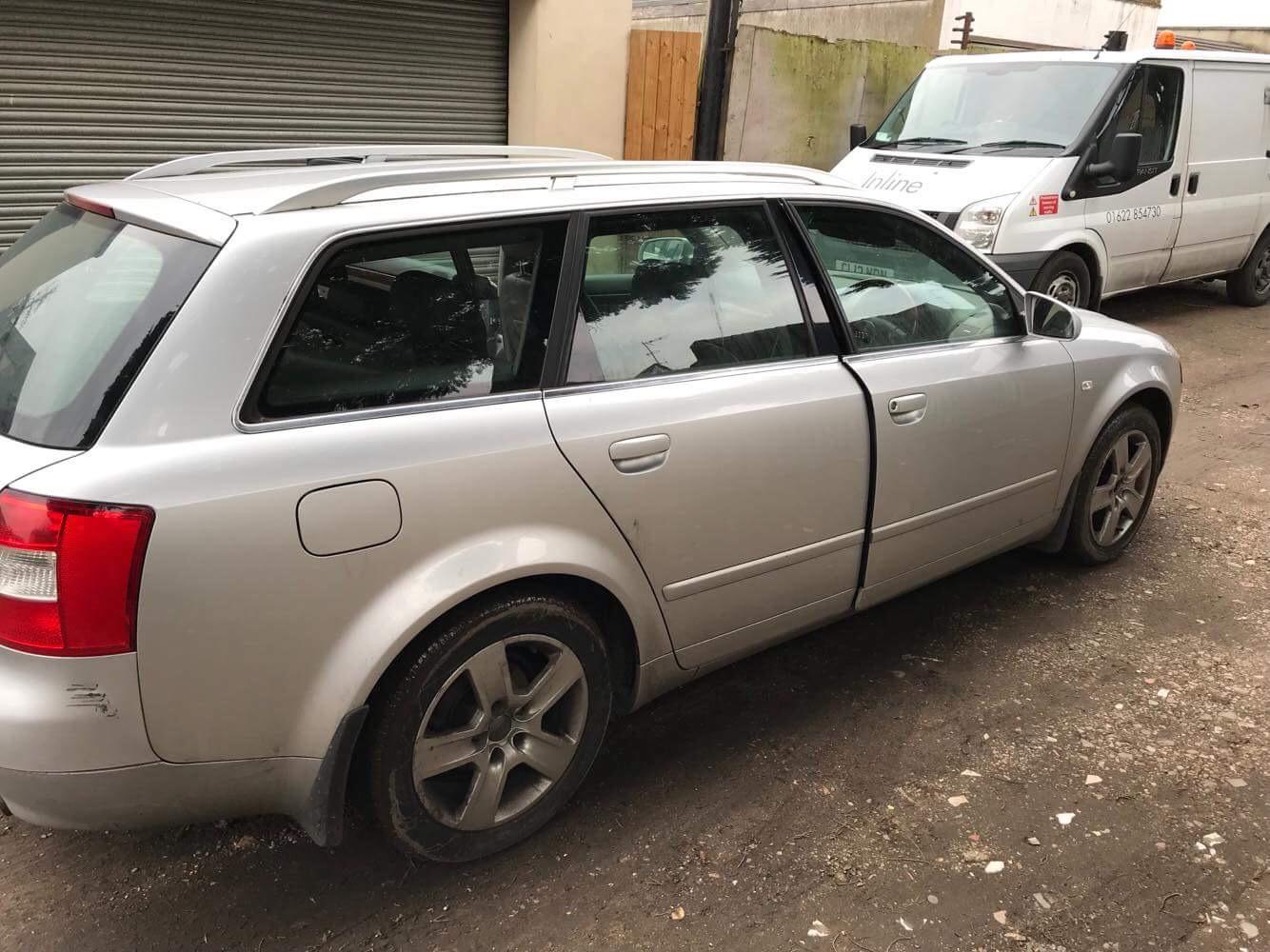

Tganks for reply I,ll get sump off and see if needs cleaned, maybe damage done I,ll let you know not surer what to do if damage ed engine car is 2004 2.4 V6 lovely clean car everything works but engine issue, maybe good for somebody .
