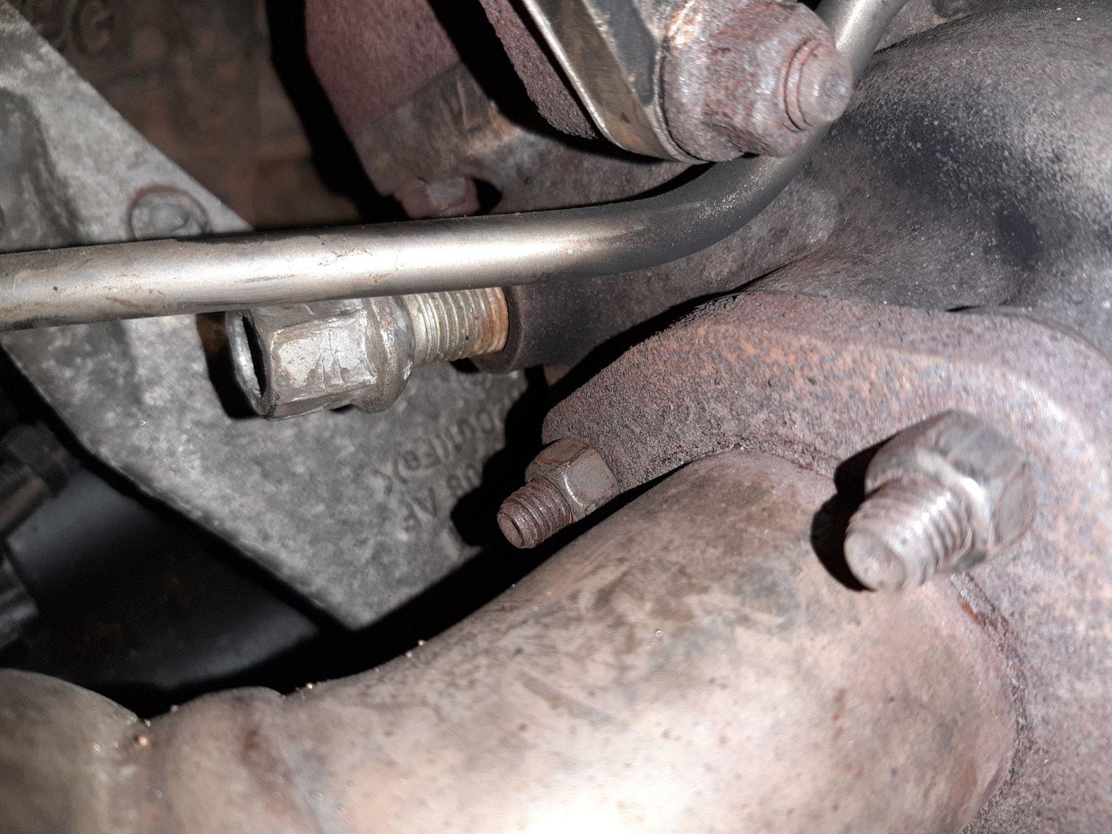

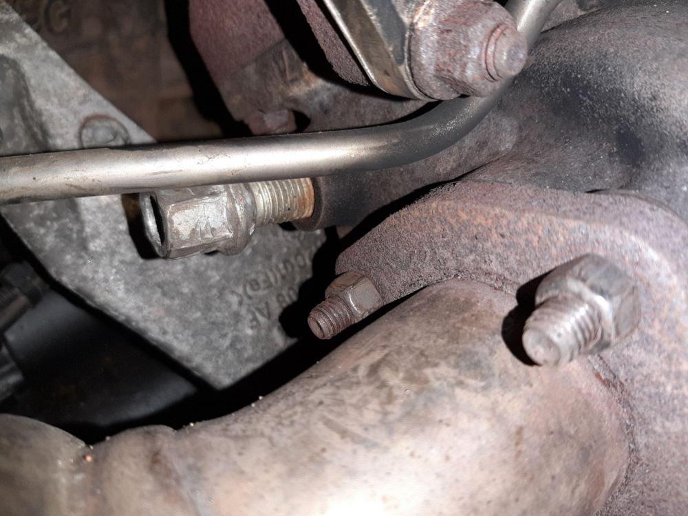

Once home I put the car up on a set of ramps and checked for any oil leaks. During this I found that there was a slight covering of oil below the turbo, which appears to be coming from the oil return pipe connection, the feed pipe looks well sealed so hopefully the turbo has been receiving a good supply of oil. I believe the car has also had an EGR blanking plate fitted, if that is relevant.
The turbo has obviously been worked on before, as the airbox was not properly secured, and more worryingly (and the purpose of this post) I found a non OEM fitting.
In the attached photos I noticed a wheel bolt has been screwed into the turbo housing on the exhaust side. The photos are taken from the top side of the turbo. After some research I believe this is a boss for the exhaust gas temperature sensor NO 1 (Part number is possibly 03L906088A). I can not see any sensor hanging free or an empty electrical connection.
