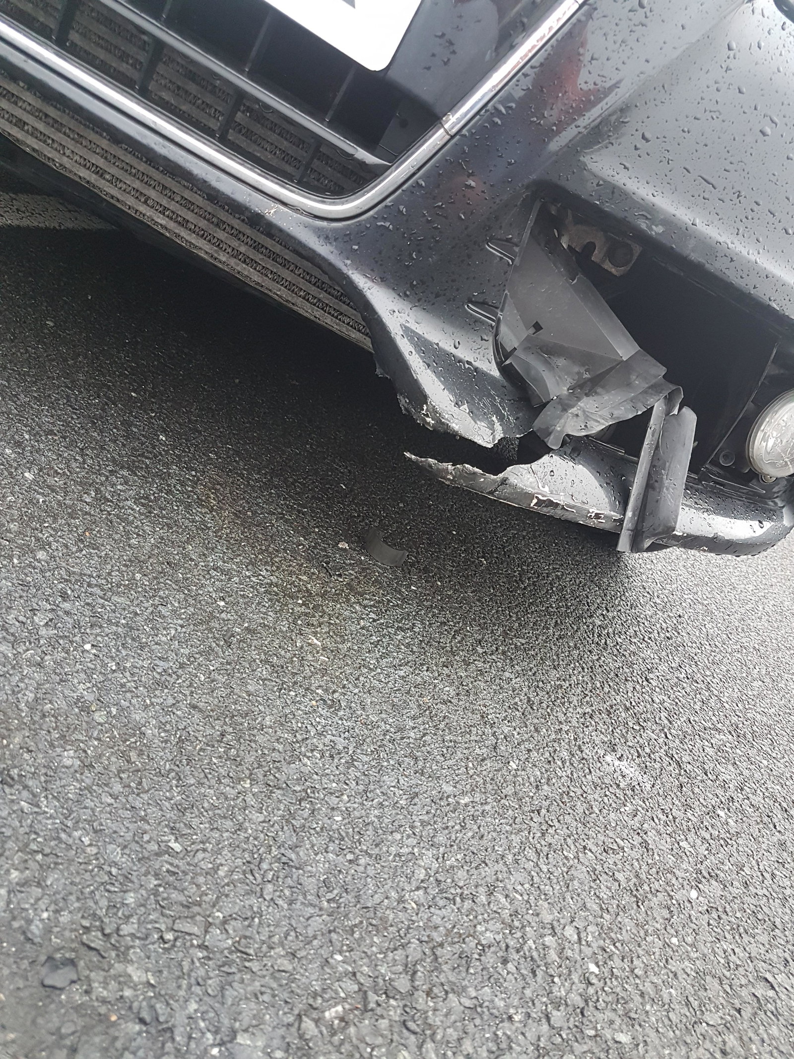

Off the subject here but I drove over a kerb and broke my front bumper and radiator. Radiator has been replaced already but the problem I'm having is getting the parts from underneath the car that were pushed back and broken. I need a new front bumper and the radiator and bumper supports.

Re. your bumper. Personally, I would not replace the bumper, if the photo represents the extent of the damage. The basics of this should be repairable by plastic welding, although you might need to replace /fabricate some associated parts.
Thanks for the info Gareth much appreciated. I'll have a look at the wiring tonight. As for the bumper, there is more damage than shown in the pic unfortunately, there are plastics under the rad and supports which have broken.
Went to a crash repair place in Belfast and he quoted me 1500 🙈🙈🙈
