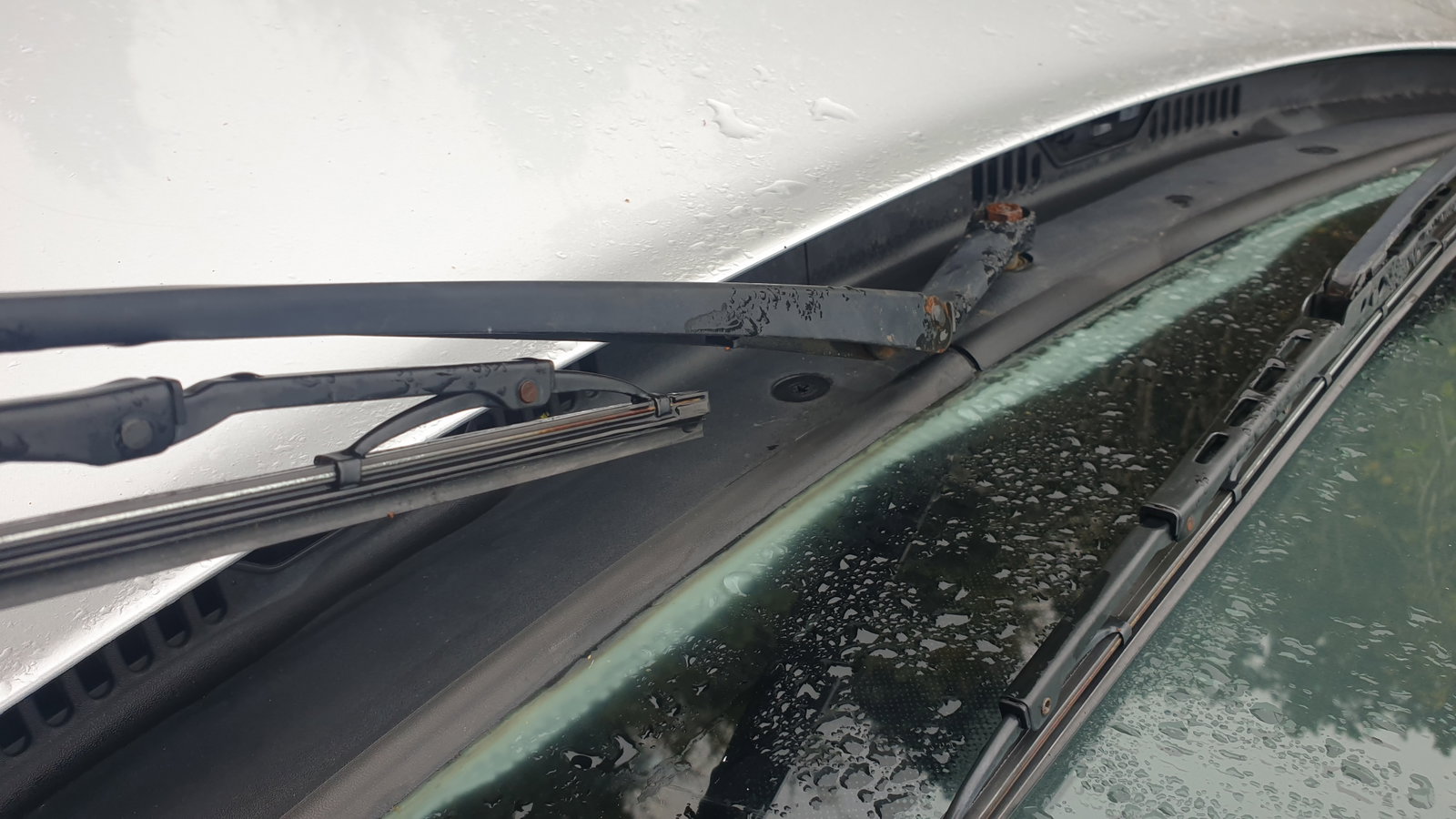

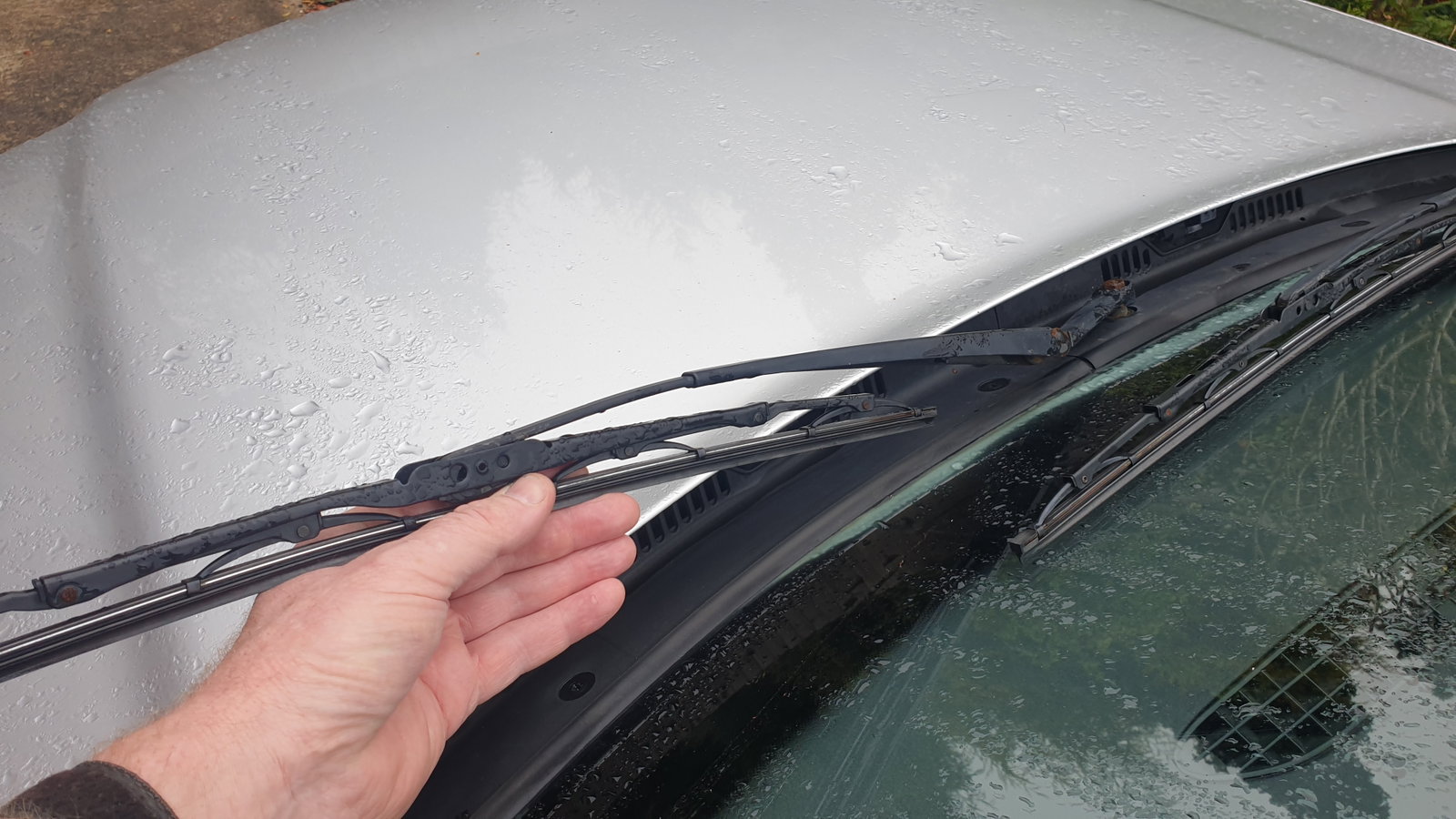

i have a Audi a4 avante (1999/2000) and during a trip out,a spring went on one of the screen wiper arms,after contacting Audi the wiper arm is no longer available.
does anyone know where i can get a new one,maybe a generic one or maybe a different audi has the same wiper arms.the part number on the arm is (8d2955408.c) your help is much appreciated,i know its an old car but really like it. thanks in advance.

I would be looking on EBay, with an aim to buying Bosch replacements ( probably the suppliers of the originals). Start by measuring the lengths of both wiper blades, and search on those first - looking for Bosch Aero twin blades for your model year. This will lead you to a number of sellers who should then be able to advise on the correct arms ( which you will have already measured as well, from the centre point of the spindle, to the point were the arm connects and pivots).
Well worth investing in a pair of arms and blades.
Hi go on Breakers Yard or similar online they contact car breakers all over the country who may well have exactly what you want.
